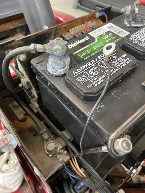

Fishroe 261 #1 Posted March 20, 2022 (edited) By the length looks like to negative post on battery, but why. Already has big cable there Not having any problems but it has been bugging me The only other place it would work is helping with the ground on the oil relay mounting screw Edited March 20, 2022 by Fishroe Share this post Link to post Share on other sites
Handy Don 17,488 #2 Posted March 20, 2022 29 minutes ago, Fishroe said: By the length looks like to negative post on battery, but why. Already has big cable there Not having any problems but it has been bugging me The only other place it would work is helping with the ground on the oil relay mounting screw You need your wiring diagram. I'm gonna guess it's to ground the instruments. Share this post Link to post Share on other sites
Fishroe 261 #3 Posted March 20, 2022 (edited) Maybe someone can see something I don’t see im not an expert at reading these The symbol for ground, I can’t tell if it’s a wire or picking up the ground from being mounted p7-81 to p7-85 1988-1989 414-8.pdf the volt meter and hour meter are working Edited March 20, 2022 by Fishroe Share this post Link to post Share on other sites
Handy Don 17,488 #4 Posted March 21, 2022 Since the meters are working, the only other options are the low oil sensor relay and the seat switch. Could some PO have added it for a now-removed accessory? Share this post Link to post Share on other sites
