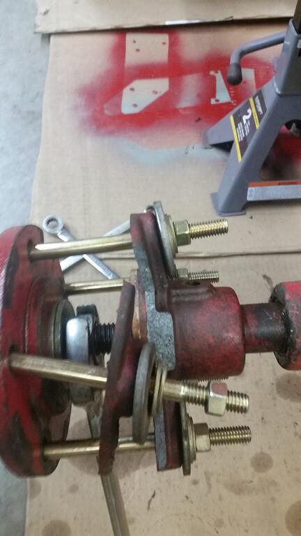

oliver2-44 10,683 #7 Posted March 21, 2022 (edited) @ANTPER As your aware to replace the axle seals you have to pull the wheel hubs. These wheel hubs are made of cast iron which is brittle, so DO Not use a 3 jaw puller on the outer diameter/flange of the hub. They are easy to break. Search for "Wheel Hub Puller" or Hub Puller" You will get lots of ideas how to do it. if your lucky your leaking axle seals will have lubed up your hubs to make them easier to pull....I've never been that lucky. Edited March 21, 2022 by oliver2-44 5 Share this post Link to post Share on other sites
WHX?? 51,695 #8 Posted March 21, 2022 Also DO NOT pound outward to try and get it off. There is a C clip on the inside holding the axle in and you do not want to break that. Always best to try and get a bearing collar between the hub and housing and pulling off of that. Don't ask me how I know. 1 Share this post Link to post Share on other sites
Handy Don 13,977 #9 Posted March 21, 2022 On a trans I just bought, we had to open it up, release the axle from the differential, and then fit the axle and the hub in to a press so we could apply enough pressure safely. It took every ounce of the press's force to pop it loose. As someone here said sagely "it took nature years to brown weld those together, don't expect them to part easily" 1 Share this post Link to post Share on other sites

ANTPER 208 #12 Posted March 22, 2022 9 hours ago, WHX?? said: Also DO NOT pound outward to try and get it off. There is a C clip on the inside holding the axle in and you do not want to break that. Always best to try and get a bearing collar between the hub and housing and pulling off of that. Don't ask me how I know. Share this post Link to post Share on other sites
ANTPER 208 #13 Posted March 22, 2022 Appears this simple I thought replacement is gonna give me a work out. I have to scrounge up a puller of some sort. Glad that was mentioned. Thanks Share this post Link to post Share on other sites
