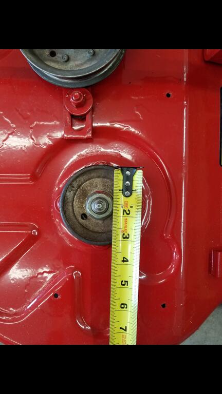

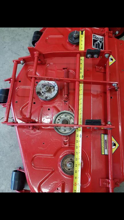

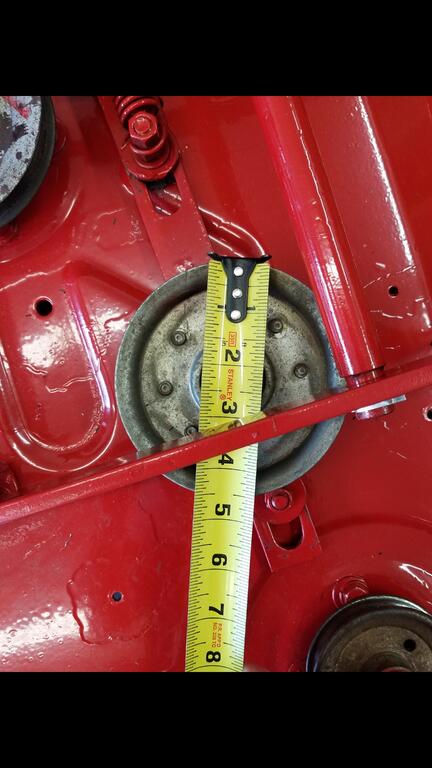

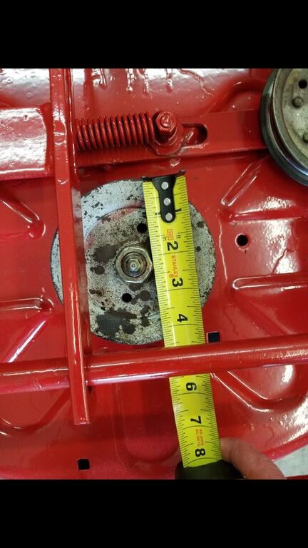

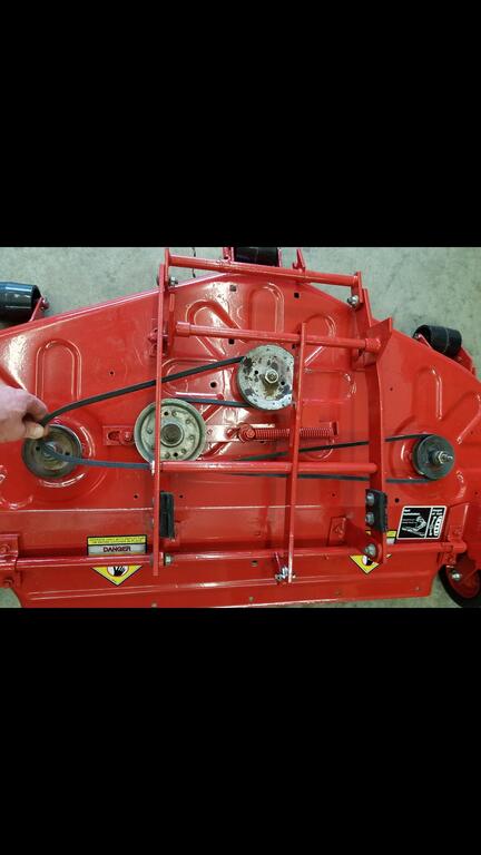

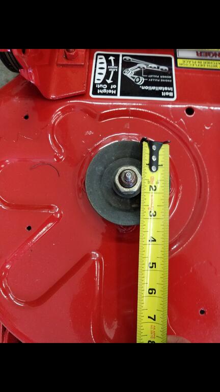

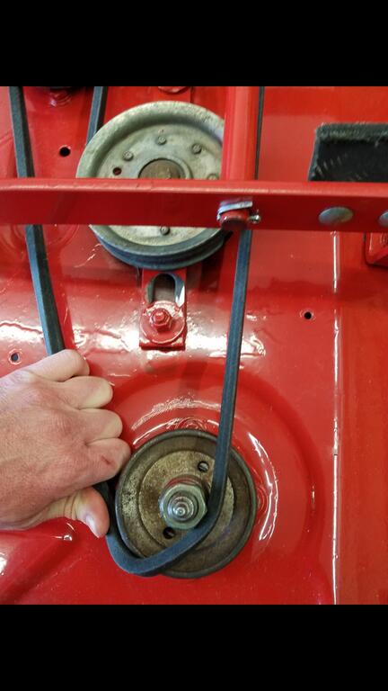

Mustang67ford 234 #10 Posted March 22, 2022 Here are the pics. 1 Share this post Link to post Share on other sites
76c12091520h 4,282 #11 Posted March 22, 2022 Need to get that idler bar and bushings cleaned up, all that paint build up needs to go. Grab that belt, give it a turn and slip it on. 1 Share this post Link to post Share on other sites
biged77 113 #12 Posted March 22, 2022 I think you have the wrong idler. My recyler R542RC01 which looks just like yours has a 3 3/4" OD idler P/N 112425. 2 Share this post Link to post Share on other sites
76c12091520h 4,282 #13 Posted March 22, 2022 53 minutes ago, biged77 said: I think you have the wrong idler. My recyler R542RC01 which looks just like yours has a 3 3/4" OD idler P/N 112425. Yes,that too, good eye! Share this post Link to post Share on other sites
953 nut 68,484 #14 Posted March 22, 2022 (edited) On 3/20/2022 at 8:44 PM, 953 nut said: 89" is the correct belt, I just put one on my RD deck last week. Route the belt around the center, idler and right pulley then start the belt in the groove of the left (as you would view it from the seat) and use the blade for leverage to turn the pulley while the belt works the way on. Your belt routing is correct. The idler being 3/4" bigger results in the belt being 1 1/3" too short. I would suggest you buy a new idler rather than a new belt so next tine you won't have to go through the same ordeal. Once you get a 3 1/2 to 3 3/4 flat idler installed all you need to do is above. You may want to put a screwdriver where your left hand is to guide the belt as the leverage of the blade works the belt on. Edited March 22, 2022 by 953 nut fat finger 1 Share this post Link to post Share on other sites

Mustang67ford 234 #16 Posted April 1, 2022 Got the new idler pulley on, new belt fit. 3 2 Share this post Link to post Share on other sites
