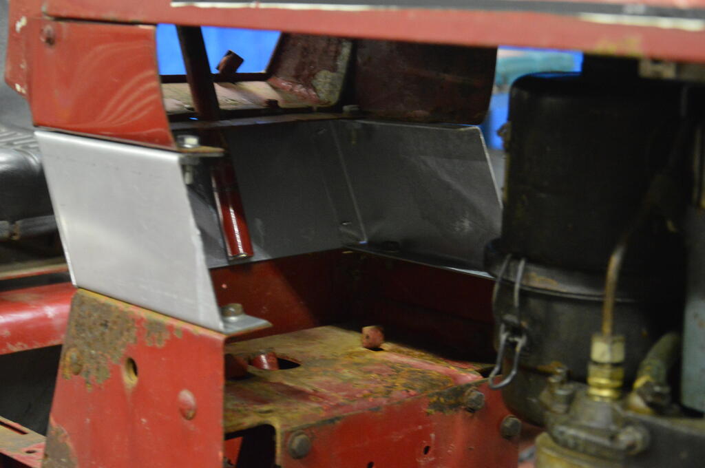

Pullstart 70,683 #2 Posted March 18, 2022 Do you have access to a welder? Any sheet metal or fabrication tools? I’d say it might be a trial and error game. You could make a taller riser for the hood itself, or I believe that has a bull horn shaped 3/8” rod… maybe make a taller one? It might have a straight through 3/8” pin? Share this post Link to post Share on other sites
Pullstart 70,683 #3 Posted March 18, 2022 Here’s where I raised one up with stock parts… 1 Share this post Link to post Share on other sites

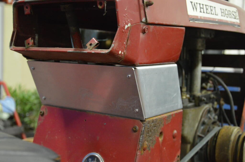

Maxwell-8 4,371 #4 Posted March 18, 2022 (edited) I am currently in the progress of doing a 4.5inch lift on my C141 to fit a diesel. the dash has to be raised and moved back to maintain the same angle for the longer steeringshaft. Edited March 19, 2022 by Maxwell-8 3 6 1 Share this post Link to post Share on other sites
