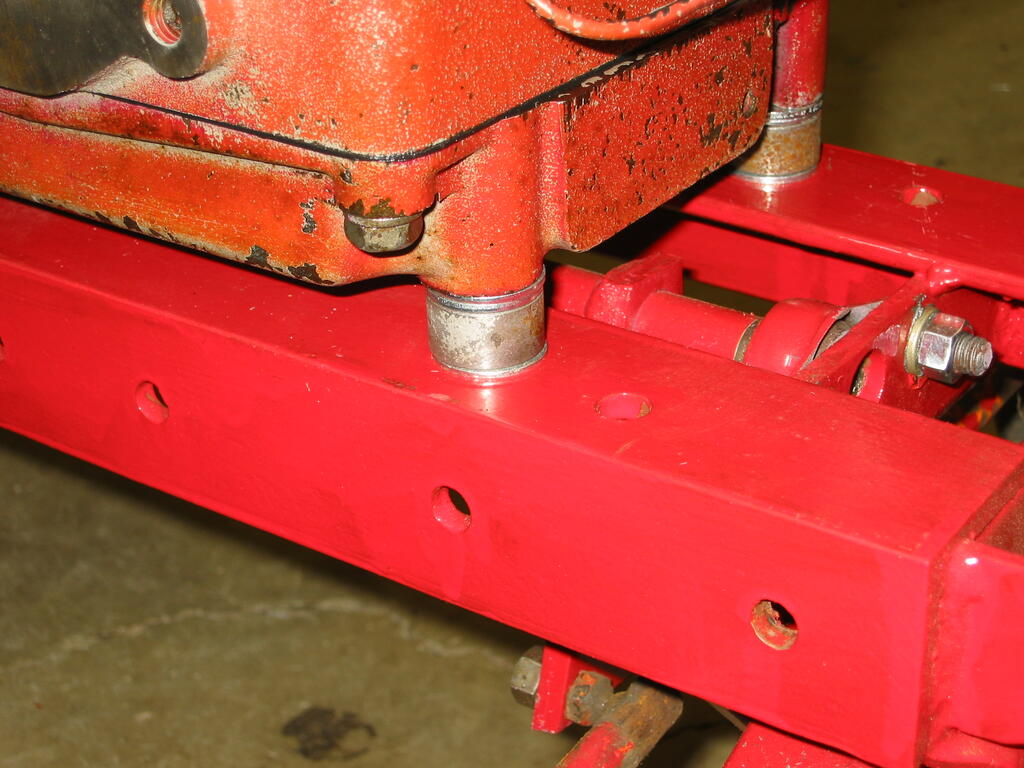

pfrederi 21,274 #60 Posted March 20, 2022 15 hours ago, WHX?? said: Horse spec motors do not have the trough. Maybe some shaker plate horses used them? Other brands used the trough pans. Cub and I think Case. it does if you notch the frame rail. Shaker plate motors used the trough pan. The engine used on Big block short frame 1075 etc were just flat shallow pans You can directly mount a trough pan on a long frame for sure (and probably a short frame as well). No cutting needed. You do have to put in spacers to get the crankshaft to match the height of a big base full oil pan motor. It does not interfer witht eh steering shaft. If you use a trough oil pan you do not need to shorten the dipper. 2 Share this post Link to post Share on other sites

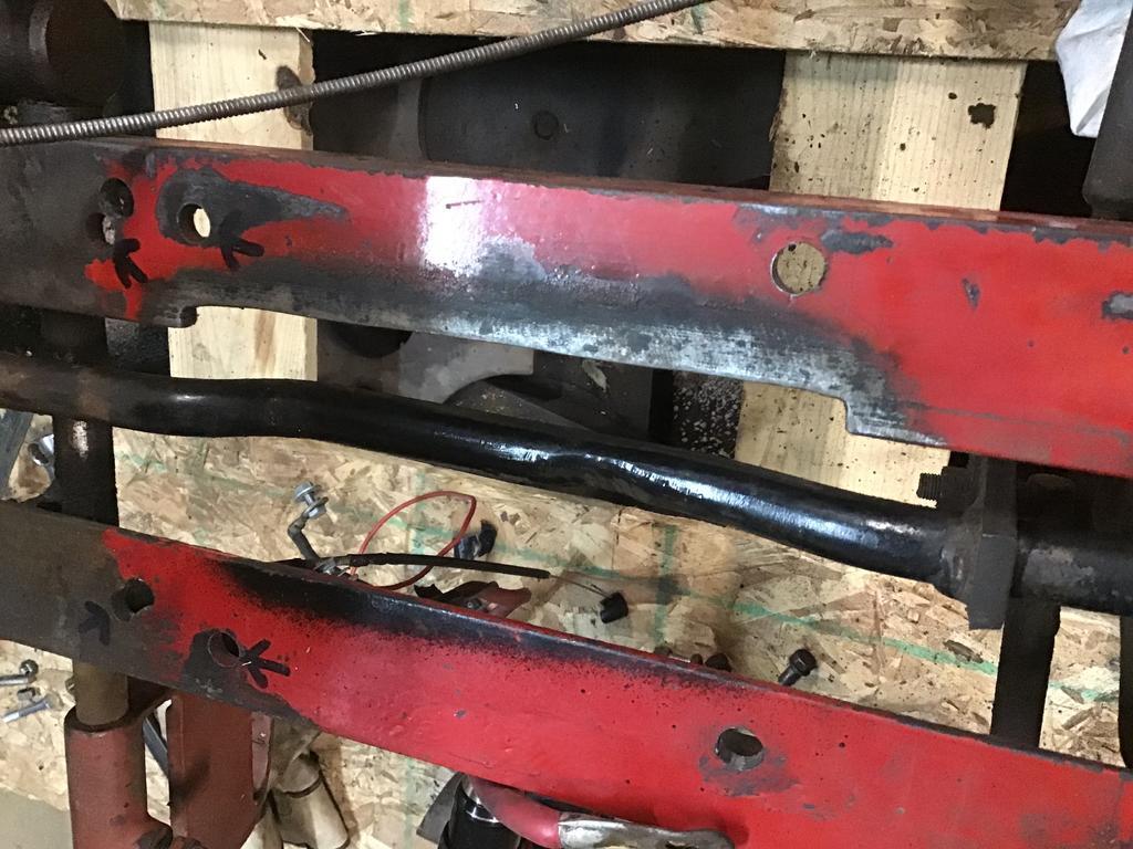

Pullstart 71,482 #61 Posted March 20, 2022 (edited) Different story though if you’re using a round hood… Here’s my frame notch and steering shaft modification to clear the pan mounted directly to the frame. Edited March 20, 2022 by Pullstart 3 Share this post Link to post Share on other sites
pfrederi 21,274 #62 Posted March 20, 2022 (edited) 1 hour ago, Pullstart said: Different story though if you’re using a round hood… Here’s my frame notch and steering shaft modification to clear the pan mounted directly to the frame. Curious why did you decide to bolt directly to the frame? Edit; Did it cause alignment issues with belt guard as the crank is in a different position?? Edited March 20, 2022 by pfrederi 1 Share this post Link to post Share on other sites
Pullstart 71,482 #63 Posted March 20, 2022 1 hour ago, pfrederi said: Curious why did you decide to bolt directly to the frame? Edit; Did it cause alignment issues with belt guard as the crank is in a different position?? All real estate was prime real estate on that build.. I had to keep the engine as low as possible. The belt guard was a bit customized, like the rest of the tractor too. 4 Share this post Link to post Share on other sites
