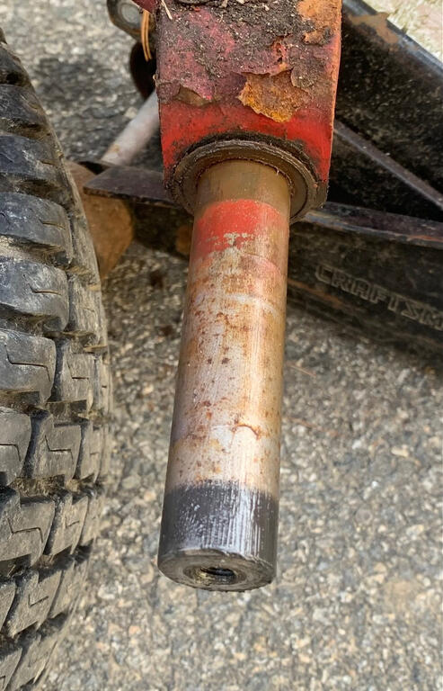

pgiro 38 #1 Posted March 17, 2022 I need to replace the wheels & tires on my D-160. It currently has 18x8.5-8 tires. Not a problem to replace the tires but finding the wheels is the problem. Seems that the wheels should be 7x8 and I have 1" spindles on the tractor. I know the common solution is to switch to trailer hubs and get 4 bolt trailer wheels. My concern is that the trailer hubs are meant to be used with the spindle having outside threads that hold the hub in place with a washer and castle nut. The spindles on the D-160 have an internal thread so it could be a challenge to hold the hubs in place properly. Depending on how close the hubs come to the end of the spindle, I can see possibly having to machine a custom washer to make it all work. Has anyone done this hub conversion on a D series and did you run into this issue? I would love to find some original style wheels instead of going the hub route but they seem difficult to find. Share this post Link to post Share on other sites

WHX?? 58,077 #7 Posted March 17, 2022 Seems to me a guy here once had the spindles threaded and used trailer hubs or 520 rims? A suggestion was to cut the spindles off and welded axle stubs on for trailer hubs & Timken bearings on??? Was beefing up the front for a FEL build or somethin? Share this post Link to post Share on other sites

JoeM 10,252 #9 Posted March 17, 2022 Shaft length on a xi is 4 inches long, 3 3/4 to the cotter pin hole. The hub bearings measured outside to outside is 3 1/2. The wheel is 5 1/2 wide and the hub is 1 inch recessed in the rim. Share this post Link to post Share on other sites

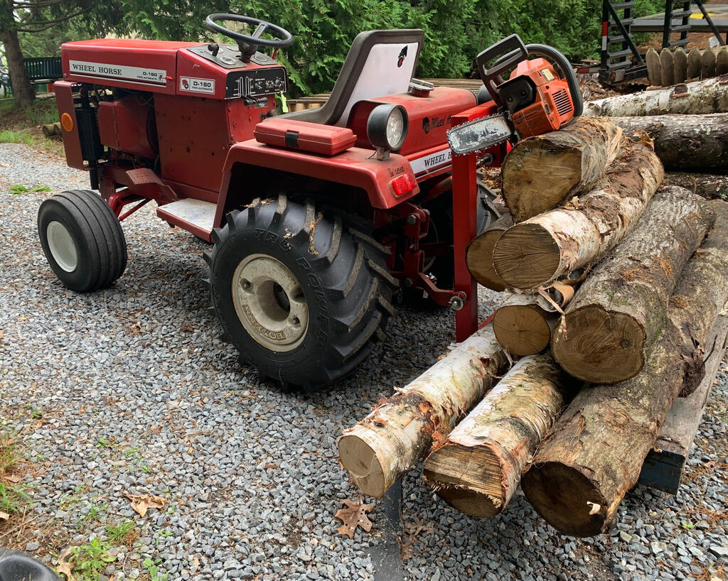

pgiro 38 #11 Posted June 27, 2022 Just to follow up on this.. I had all the new tires mounted. I had the rear tires done at a tire shop. He said the rims were very rusty and one had water in it but they came out good. The front ones I had done at a place that sells and services lawn equipment. They were also in rough shape. It turns out that the front rim I had concerns about was warped badly and not usable. I bought a rim off of someone on this forum and had it remounted. Now all is finally good with the tires and it's ready to work. Thanks for all the advice. 2 1 Share this post Link to post Share on other sites
pacer 3,180 #12 Posted June 27, 2022 Sweet attachment on the 3 point there - aint them 3 point things handy, I'm constantly hooking on to, or pulling something, or ....... 1 Share this post Link to post Share on other sites
pgiro 38 #13 Posted June 28, 2022 Yes, very handy. I made a set of forks from mostly scrap metal and they are very useful. 1 Share this post Link to post Share on other sites
