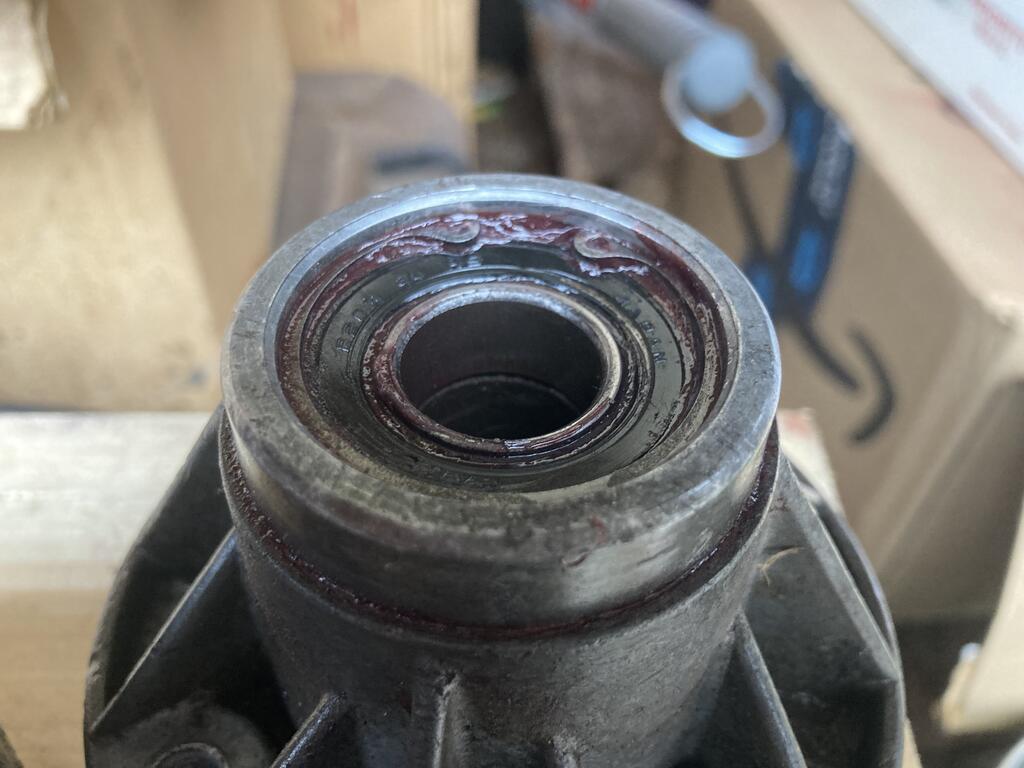

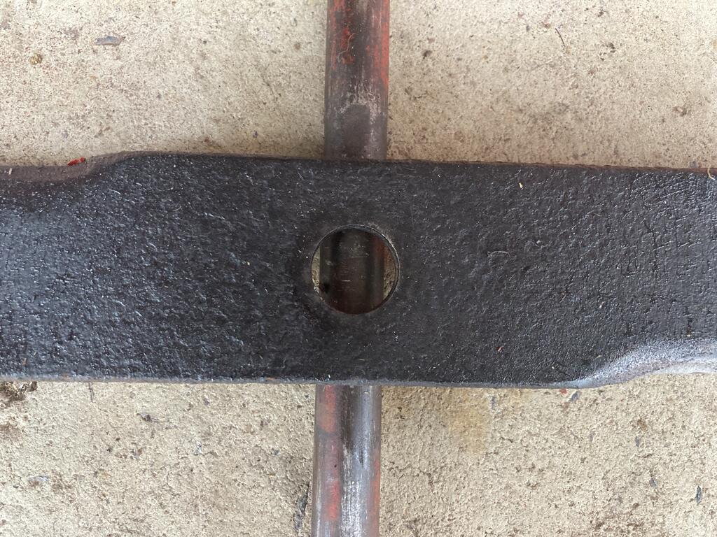

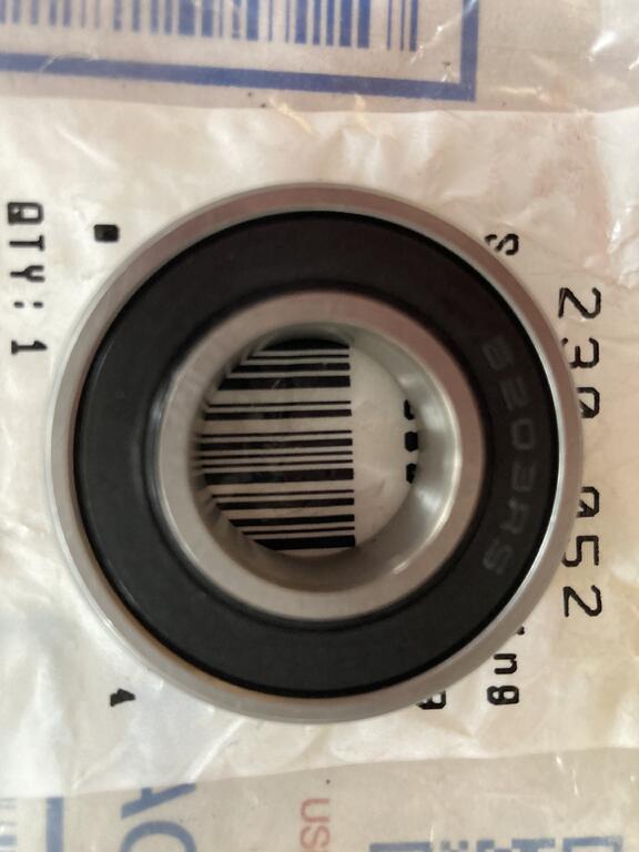

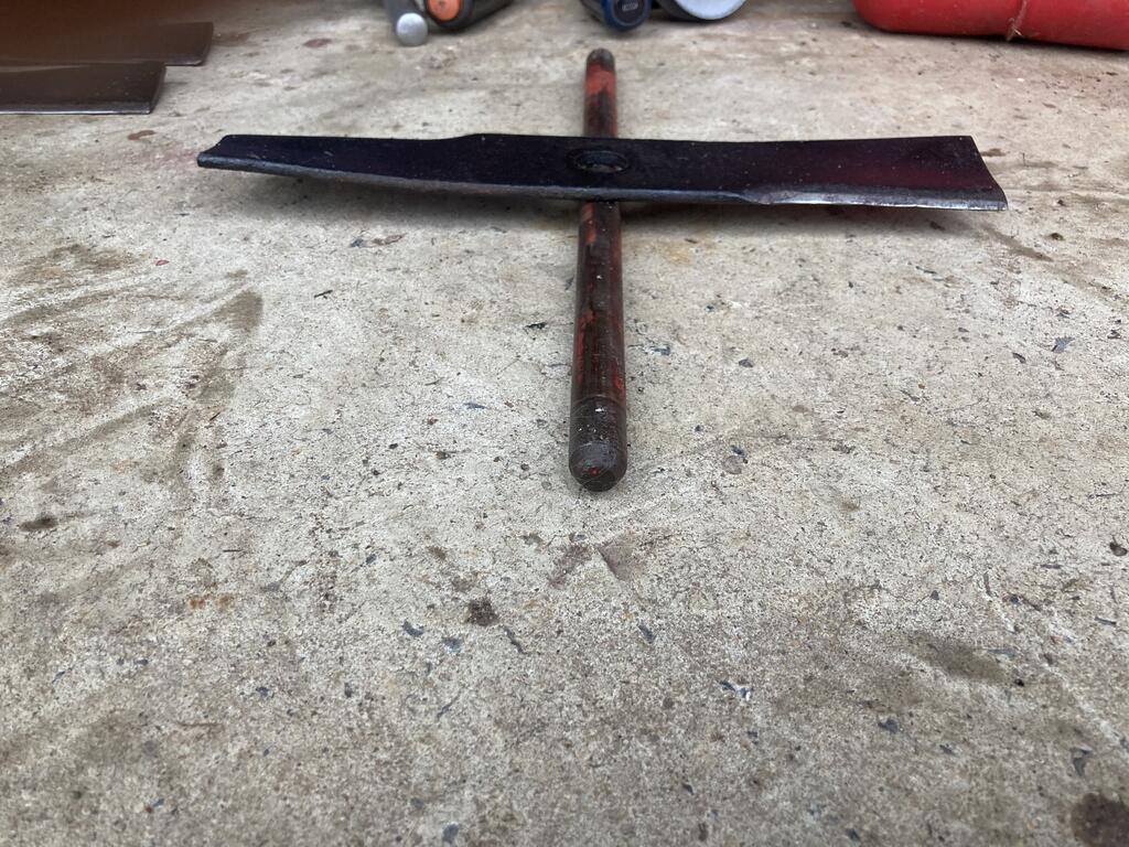

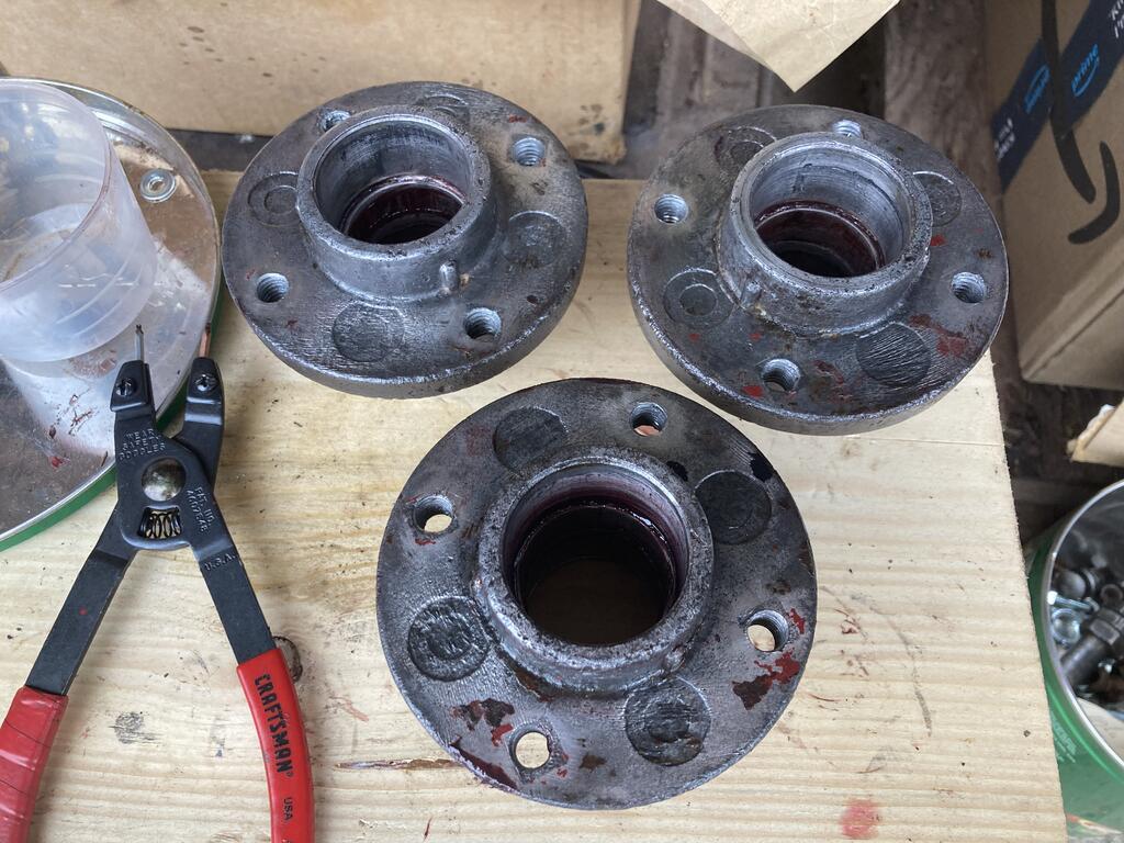

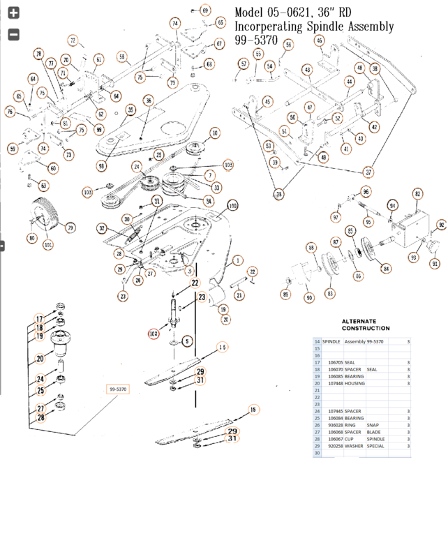

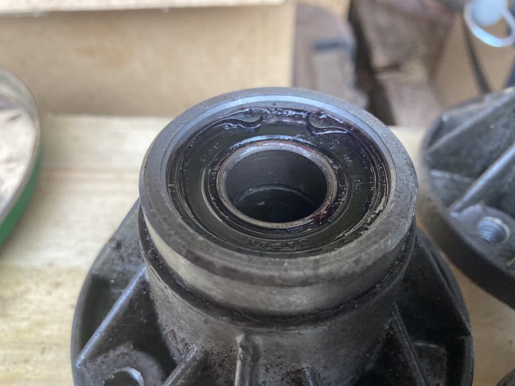

"Manic-Mechanic" 1,485 #12 Posted March 17, 2022 (edited) 2 hours ago, Handy Don said: I'd start with the balancing before pulling a lot of stuff apart. I would start by slipping the belt and making sure the pulley's are not bent and that all the bolts are snugged evenly. The thing I've noticed about decks is that they resonate so it doesn't take a lot of vibration somewhere to make 'em loud! I had done that before complete re-assembly. One top bearing, far left, was questionable. I figured, well if I take it all apart then might as well replace them all. After removing them from the housings I did notice they were sluggish. I did balance the blades prior and checked them again this morning, however, there may be some controversy over this method! The center is slightly off so some more material would need removed, but this "old school method" is iffy, waiting on a proper balancer. I have new blades on route and will balance the old ones later on. The bottom bearings are slightly recessed or concaved as well. (A) (B) (C) I did remove the grease as another precaution. Stens comes through again, Made In USA! Now remove some of the plastic seals to allow grease in. I was just trying to finish this as surgery on my left foot is tomorrow and hobbling around the shop afterwards isn't smart at all! Edited March 17, 2022 by "Manic-Mechanic" Organize 1 Share this post Link to post Share on other sites

oldlineman 1,721 #14 Posted March 17, 2022 I believe that is an acceptable way to balance your blades. Bob 1 Share this post Link to post Share on other sites
"Manic-Mechanic" 1,485 #15 Posted March 18, 2022 Well, I knocked out the old and pressed in the new, making sure to remove the appropriate seals off the sides of the bearings. (Tightened down the spindle bolts tight and evenly.) I greased the spindles 25 pumps, then heard the slight "pop" and stopped! I rolled them around a good bit and put the belt back on. The spindles went together nicely whenever I dry assembled to make the pulleys didn't rub or any other "surprise?" I stopped at that point, ran out of free time. Excited about getting it back on the tractor! Lol 1 Share this post Link to post Share on other sites

"Manic-Mechanic" 1,485 #19 Posted March 18, 2022 (edited) 8 minutes ago, RED-Z06 said: I dont personally advise pumping up typical ball bearings, i rebuild with double sealed bearings and advise not putting grease in them beyond what you may add on assembly. I give my old unrebuilt 1993 spindles 5 pumps annually..no more. When they fail, ill put in double sealed and put some grease in at assembly incase an inner seal fails. The only spindle styles that truly benefit from grease have an actual grease seal, the bearing lip seals cant hold any pressure behind them. Right, these have grease seals. (see item 17 part 106705) So, you get away with 5 pumps a year? That's pretty good! Same assembly, 3/4" x 6" keyed spindles with top oil seals? Edited March 18, 2022 by "Manic-Mechanic" Share this post Link to post Share on other sites
RED-Z06 2,718 #20 Posted March 18, 2022 2 minutes ago, "Manic-Mechanic" said: Right, these have grease seals. So, you get away with 5 pumps a year? That's pretty good! Same assembly, 3/4" x 6" keyed spindles with top oil seals? Show me your grease seals? All im seeing is the pop in seals that come with the sealed ball bearings. Share this post Link to post Share on other sites
"Manic-Mechanic" 1,485 #21 Posted March 18, 2022 1 minute ago, RED-Z06 said: Show me your grease seals? All im seeing is the pop in seals that come with the sealed ball bearings. (Top oil seals only) see diagram. Share this post Link to post Share on other sites
RED-Z06 2,718 #22 Posted March 18, 2022 This is, for example, a scag spindle kit, it uses tapered bearings and lip seals top and bottom. Share this post Link to post Share on other sites
"Manic-Mechanic" 1,485 #23 Posted March 18, 2022 (edited) 3 minutes ago, RED-Z06 said: This is, for example, a scag spindle kit, it uses tapered bearings and lip seals top and bottom. Right, I know what oil seals are. Lol! Strange they only used one on top on mine, did you look at the diagram? All I know is this deck better be a hell of a lot more quiet next test! Edited March 18, 2022 by "Manic-Mechanic" Share this post Link to post Share on other sites
RED-Z06 2,718 #24 Posted March 18, 2022 2 minutes ago, "Manic-Mechanic" said: Right, I know what oil seals are. Lol! Strange they only used one on top on mine.... Without a lower seal, pumping grease in is probably only going to pop the lower cover out. 1 Share this post Link to post Share on other sites
"Manic-Mechanic" 1,485 #25 Posted March 18, 2022 (edited) 15 minutes ago, RED-Z06 said: Without a lower seal, pumping grease in is probably only going to pop the lower cover out. I actually did crank a pile into the old assemblies until the grease came out the spindles, must of been a fluke, nothing popped out on the bearings! Just wasted some pretty expensive grease, especially after taking them all apart again to change the bearings. I knew better to try and take a short cut. This is a part time machine at best to gather up grass clippings in a sweeper, I mow with a Gravely ZTXL Zero Turn. Edited March 18, 2022 by "Manic-Mechanic" Share this post Link to post Share on other sites
