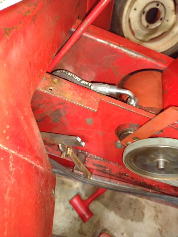

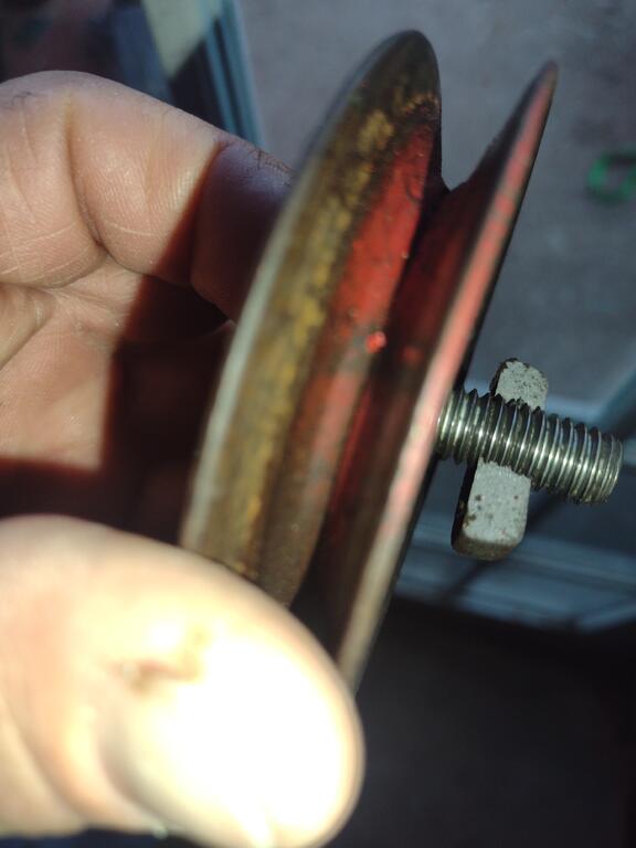

Tinman1962 15 #1 Posted March 16, 2022 Tension pulley arm snapped how do I remove and replace that part I'm sorry it's on a 1054any help would be greatly appreciated Share this post Link to post Share on other sites
daveoman1966 3,882 #2 Posted March 16, 2022 I would try to braze-weld it.... then CAREFULLY chase the threads with a tap... Share this post Link to post Share on other sites

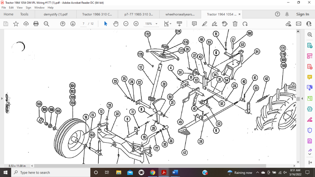

953 nut 64,275 #3 Posted March 16, 2022 Both ends of the shaft are connected to the shaft with roll pins, drive out the roll pin on either side and the shaft will slide out (might have to fight a bit of rust) and the shaft will slide through the body of the 1054. Lincoln at A to Z https://a-ztractor.com/ may be able to help you with a good used part or a new arm, part # 32 in the picture, could be fabricated by anyone with a welder, drill press and some skill. Wheel Horse part number is 2891, not sure how many other models may have used the same arm. 3 Share this post Link to post Share on other sites
daveoman1966 3,882 #4 Posted March 16, 2022 My reverse parts look-up shows that Arm # 2891 is only on models 953 and 1054. Share this post Link to post Share on other sites
