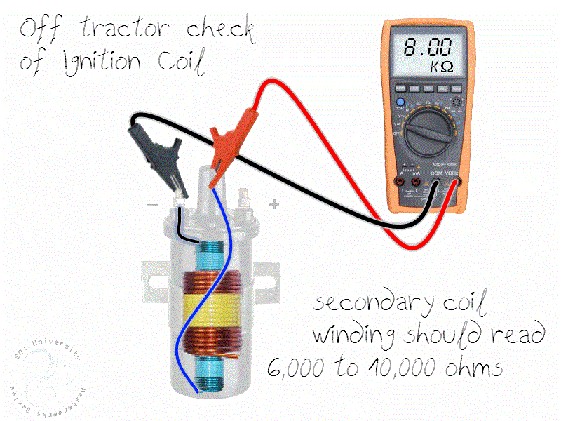

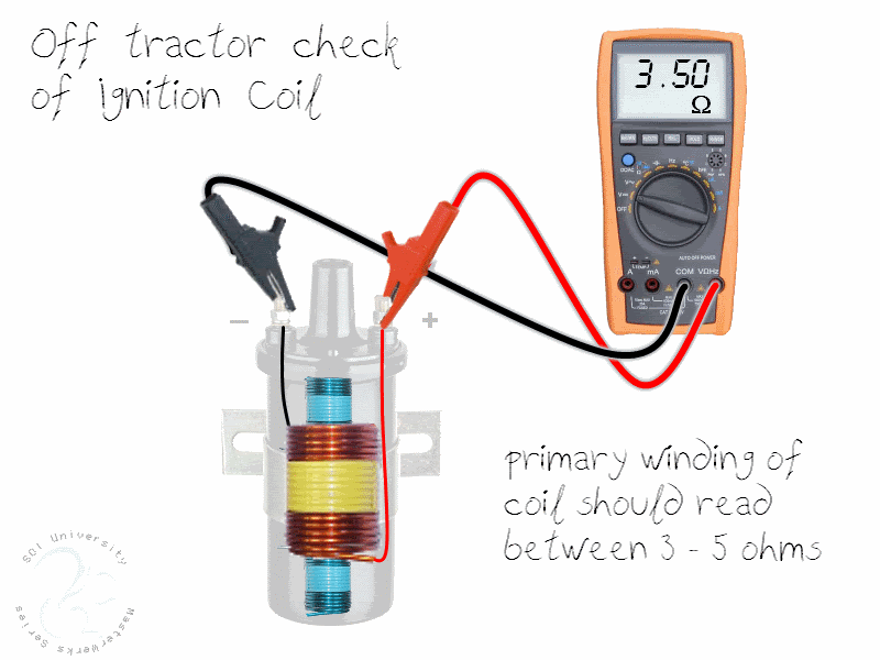

Redav72 231 #1 Posted March 16, 2022 Tried turning over the K161S on my 753 for the first time and I'm not getting a spark (pulled the plug out and strapped it to the head to test, no visible spark). I'm going to pick up a meter tomorrow to test continuity. At the moment I have bypassed the key switch by running a wire directly from the voltage regulator to the coil, I do not have the ammeter installed but all other terminals are connected. The starter turns and I can smell gas. I've replaced the points and condenser with new (I tested with the old points first then replaced when I didn't get a spark). I pulled the plug and swapped with a known working from another horse. At this point I'm thinking either the coil or voltage regulator. What can I do to test those two components? Tractor 1963 753 Wiring Rev.pdf 1 Share this post Link to post Share on other sites

gwest_ca-(File Mod) 12,066 #4 Posted March 16, 2022 Share this post Link to post Share on other sites
