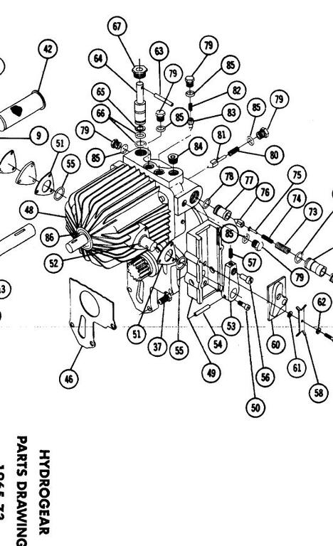

Jrain 276 #1 Posted March 15, 2022 I have a question , on the the motor and hydro pump assembly for a 90-2046 unit , it shows in the diagram , behind the cam plate bracket, a triangular part where the mounting screws go trough to attach the cam plate bracket , the part number is 6826 it says Shim , I need to know if this is a metal type shim or a shim made of a gasket type material . also I would need to know where I could purchase this part , or if I had to make one what is the gauge of this Shim. Thanks J Share this post Link to post Share on other sites
pfrederi 19,941 #2 Posted March 15, 2022 It is a metal shim#51 and it holds an O ring #970026 (#55) there is another O ring on the shaft #972116 (#52) 1 Share this post Link to post Share on other sites

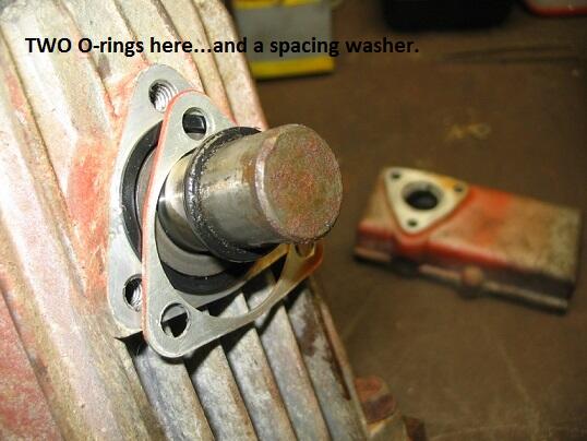

daveoman1966 3,882 #3 Posted March 15, 2022 This is a pic of the parts .... I may have these...at least the metal shim (51) #6826 2 Share this post Link to post Share on other sites
pfrederi 19,941 #4 Posted March 15, 2022 I have the O rings if you need them.. I use 026S Square profile they are easier to keep in place during installation 1 Share this post Link to post Share on other sites
