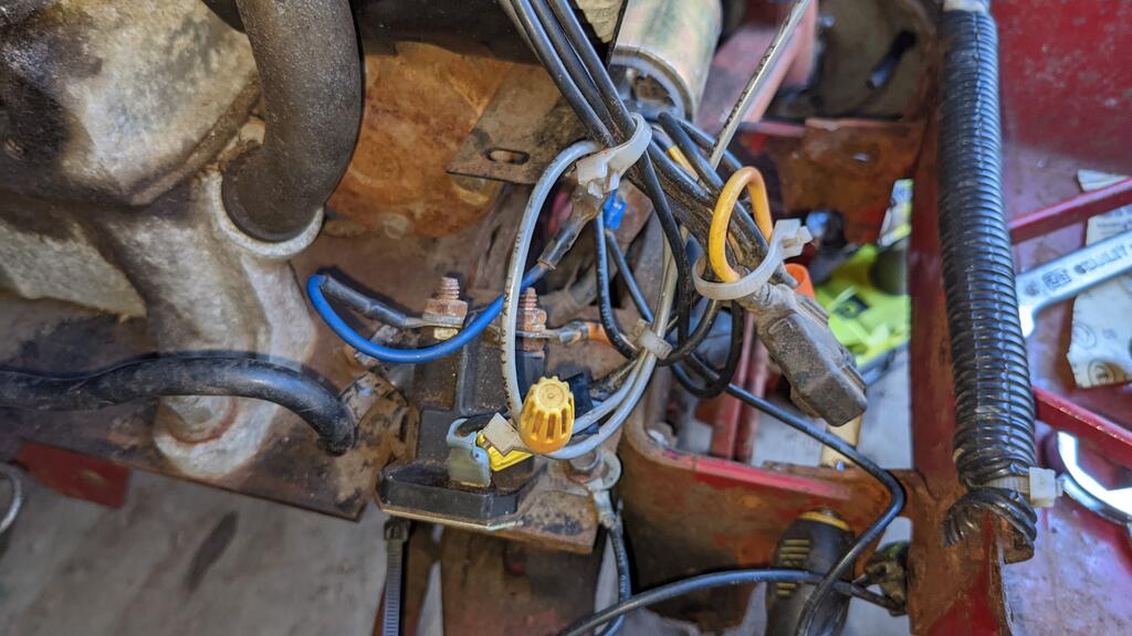

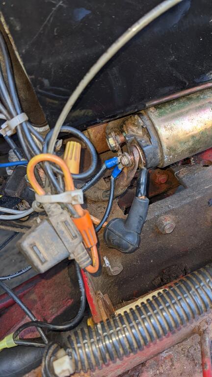

RITEK 25 #1 Posted March 14, 2022 (edited) Won't start. Drained the battery. Only a click from the solenoid. And re charged the battery. Bought the battery in 8/21 Edited March 14, 2022 by RITEK 1 Share this post Link to post Share on other sites

Ed Kennell 47,399 #5 Posted March 14, 2022 Have you replaced the missing nut on the terminal? 3 Share this post Link to post Share on other sites
gwest_ca-(File Mod) 12,489 #6 Posted March 14, 2022 The wires all look loose on the solenoid on the starter - last picture. 2 Share this post Link to post Share on other sites
RITEK 25 #7 Posted March 14, 2022 3 minutes ago, Ed Kennell said: Have you replaced the missing nut on the terminal? 3 minutes ago, gwest_ca said: The wires all look loose on the solenoid on the starter - last picture. I have been testing that's why things are loose 1 Share this post Link to post Share on other sites

squonk 48,154 #17 Posted March 15, 2022 And get rid of those wire nuts. Make proper connections. 2 Share this post Link to post Share on other sites
