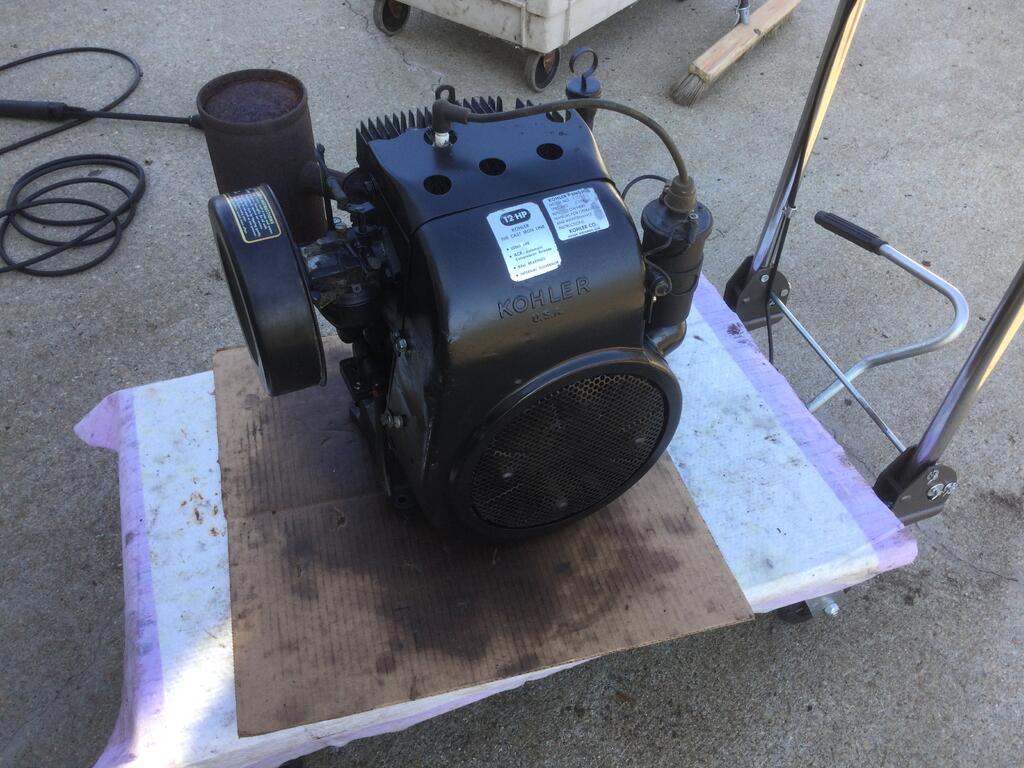

nicky1 0 #1 Posted March 14, 2022 I was just curious if anyone has put a cast iron Briggs in a C-165 tractor. I have this tractor with a Kohler 12 horse that threw a rod. The Briggs is a 10 hp cast iron with electrric start. Share this post Link to post Share on other sites
