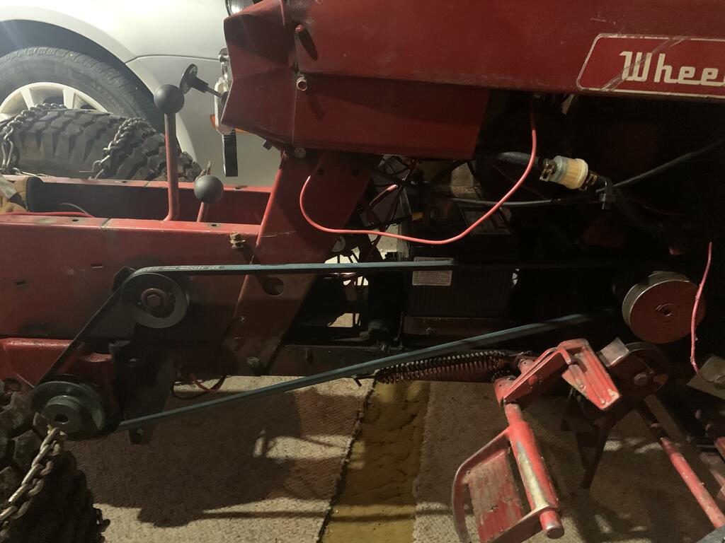

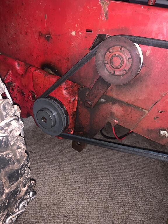

squonk 48,152 #15 Posted March 14, 2022 (edited) You're going off roading. You do not have stock sized pullies. A 70" belt may not be the correct length. Are your pullies the same width? The same profile? Also The used transmission may have worn hubs /axle keyways. The load you're putting on it may be enough to make them slip. How about some pictures so we can see your pulley belt set up? Edited March 14, 2022 by squonk 4 Share this post Link to post Share on other sites
857lover 291 #16 Posted March 14, 2022 (edited) 3 hours ago, squonk said: You're going off roading. You do not have stock sized pullies. A 70" belt may not be the correct length. Are your pullies the same width? The same profile? Also The used transmission may have worn hubs /axle keyways. The load you're putting on it may be enough to make them slip. How about some pictures so we can see your pulley belt set up? i will definitely grab some pictures after work but i have noticed my right hub keeps sliding back and forth like my set screw isn’t doing anything but also the trans pulley is a 4 inch diameter which is the same size as the one on my 3speed only difference is the bore is smaller Edited March 14, 2022 by 857lover Share this post Link to post Share on other sites

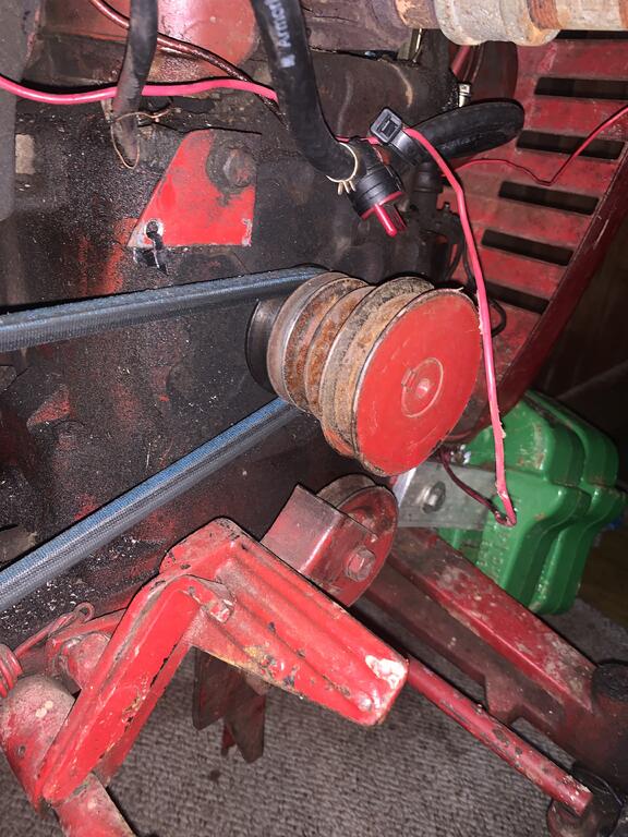

857lover 291 #21 Posted March 14, 2022 10 hours ago, squonk said: You're going off roading. You do not have stock sized pullies. A 70" belt may not be the correct length. Are your pullies the same width? The same profile? Also The used transmission may have worn hubs /axle keyways. The load you're putting on it may be enough to make them slip. How about some pictures so we can see your pulley belt set up? Share this post Link to post Share on other sites
953 nut 69,548 #22 Posted March 14, 2022 Can't be sure from the picture but the engine pulley looks wide like a "B" bely pulley, belt should be riding high in the pulley so it has the maximum side contact area. Share this post Link to post Share on other sites
squonk 48,152 #23 Posted March 14, 2022 Pulley on trans also doesn't look stock to me and the idler looks high like the belt is too long. Share this post Link to post Share on other sites
Handy Don 17,488 #24 Posted March 15, 2022 (edited) I'm more noticing that the blue fabric on the top and bottom is there but gone on the sides. Also, as noted, belt is riding low in the groove. DEAD BELT is my vote (new belt = better grip ✅, ride higher ✅, pull the idler down a bit more ✅) And yeah, non-stock drive pulley on the trans but I don't think that's the issue because the belt stopped moving. Edited March 27, 2022 by Handy Don Share this post Link to post Share on other sites
squonk 48,152 #25 Posted March 15, 2022 The only thing that will stop the belt is it slipping on the engine pulley 2 1 Share this post Link to post Share on other sites
