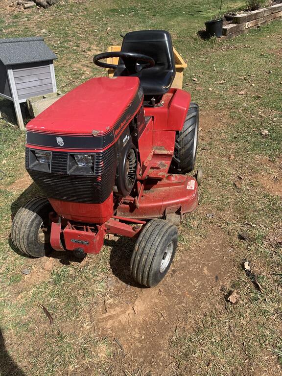

Mike in NC 342 #1 Posted March 13, 2022 Our 312-H needed new tires, so it got some. V-61's for the front and Deestone Ags for the rear. Filled the fronts with fluid so far. Will fill the rears later. 1 4 Share this post Link to post Share on other sites
ebinmaine 79,660 #2 Posted March 13, 2022 8 minutes ago, Mike in NC said: Deestone Ags for the rear How do you feel about the sizing of those DeeStones compared to what you took off.? Share this post Link to post Share on other sites
Mike in NC 342 #3 Posted March 13, 2022 (edited) The ones that I took off were 23/9.50 X 12 and the Deestonnes say 23/10.50 X 12 but are about the same size as the 23/9.50's that I took off. This is the reason that I went with the Deestones so that they would be close to the originals. So, they are a little smaller then the size on them. I have read reviews of the Deestones running smaller so I went with them to give it a try, also I could not find 9.50 and I don't want real wide of tires.. And so far I am happy with them. I have used the tractor around the yard doing spring cleanup and they seem good. Edited March 13, 2022 by Mike in NC 2 1 Share this post Link to post Share on other sites
ebinmaine 79,660 #4 Posted March 13, 2022 22 minutes ago, Mike in NC said: The ones that I took off were 23/9.50 X 12 and the Deestonnes say 23/10.50 X 12 but are about the same size as the 23/9.50's that I took off. This is the reason that I went with the Deestones so that they would be close to the originals. So, they are a little smaller then the size on them. How about the outside diameter? Do the Deestones measure an accurate 23" ? Share this post Link to post Share on other sites
Mike in NC 342 #5 Posted March 13, 2022 10 minutes ago, ebinmaine said: How about the outside diameter? Do the Deestones measure an accurate 23" ? I just went out and measured them, and aired up, they are a real close 23. It might be like a 22 3/4 but it is real close. I inflated one new one and put it beside one of the old ones that was still on a rim and they seamed just about the same diameter/height. 3 1 Share this post Link to post Share on other sites
Sparky-(Admin) 25,935 #6 Posted March 13, 2022 I really like those fronts. Are they 15x5x6 or 16x6.50x8’s ? 1 Share this post Link to post Share on other sites
Mike in NC 342 #7 Posted March 13, 2022 4 minutes ago, Sparky said: I really like those fronts. Are they 15x5x6 or 16x6.50x8’s ? Thank you. They are 15/6.00 x 6. Share this post Link to post Share on other sites
