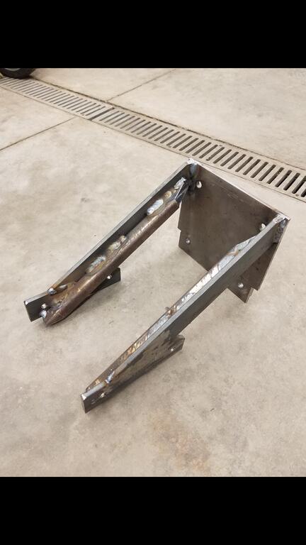

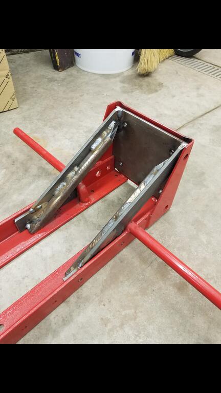

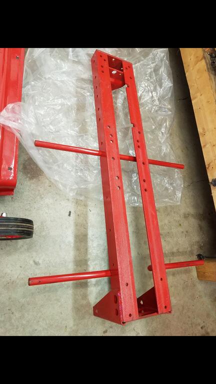

Mustang67ford 234 #26 Posted March 20, 2022 (edited) The fix for the f plate is a new NOS frame and fabricated up a plate reinforcement. One piece bolt-in. Still need to clean up and paint. Edited March 20, 2022 by Mustang67ford 4 5 Share this post Link to post Share on other sites

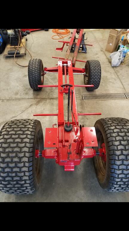

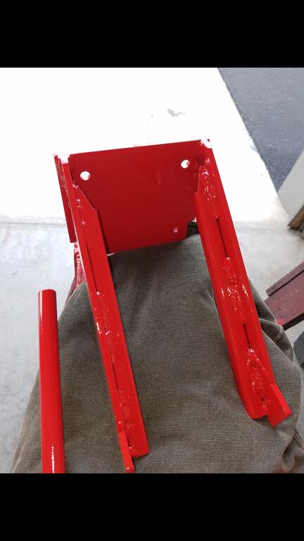

Mustang67ford 234 #27 Posted March 24, 2022 (edited) Got the new frame and reinforcement all painted and bolted up. Edited March 24, 2022 by Mustang67ford 6 2 Share this post Link to post Share on other sites

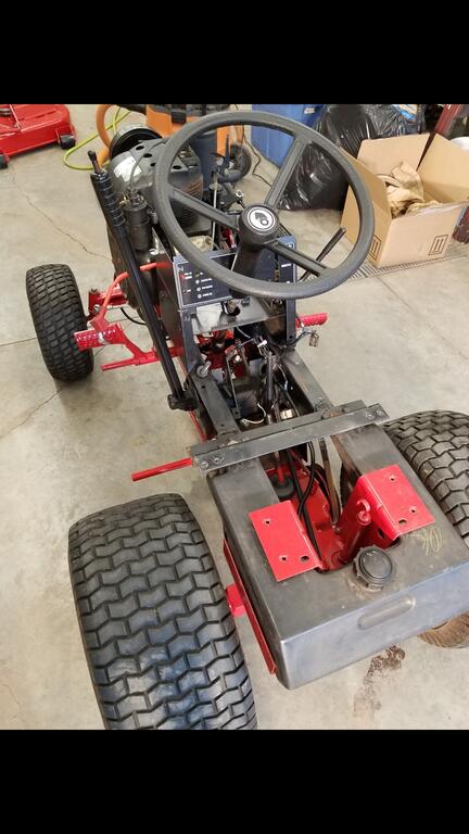

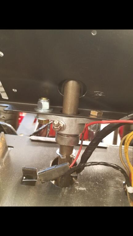

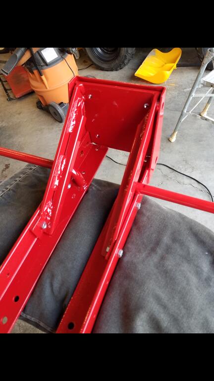

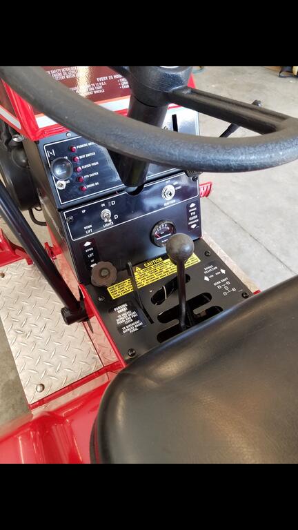

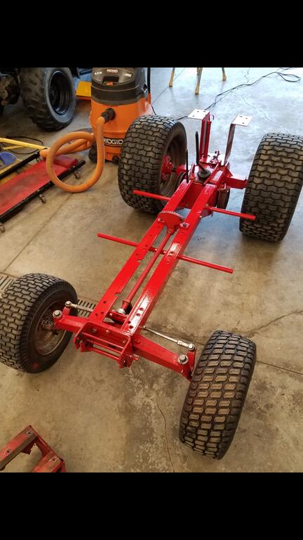

Mustang67ford 234 #28 Posted March 27, 2022 (edited) Made some more progress. Back to where I was 2 weeks ago when I needed to change the frame. Then, got the upper dash and steering installed and 1 side of the sheet metal. I assembled the steering on the bench to install the roll pin then bolted it in place. Because of the steering spring washer, I had to push down on the steering before tightening up the collar. The upper steering rod at the steering fan block all went together good. The steering teeth are just slightly above the block, could not get them to actually touch the block. Ran into a problem installing the steering wheel onto the shaft though. Both are new but the hole in the steering wheel did not completley line up on one side. No matter what I did, the roll pin would not go. Had to run a drill bit thru the one side of the steering wheel to allow the roll pin to go. Maybe thats normal, not sure. Edited March 27, 2022 by Mustang67ford 3 5 Share this post Link to post Share on other sites

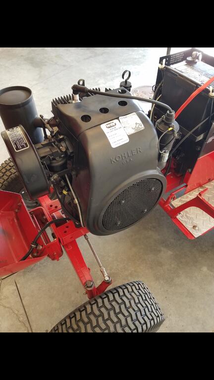

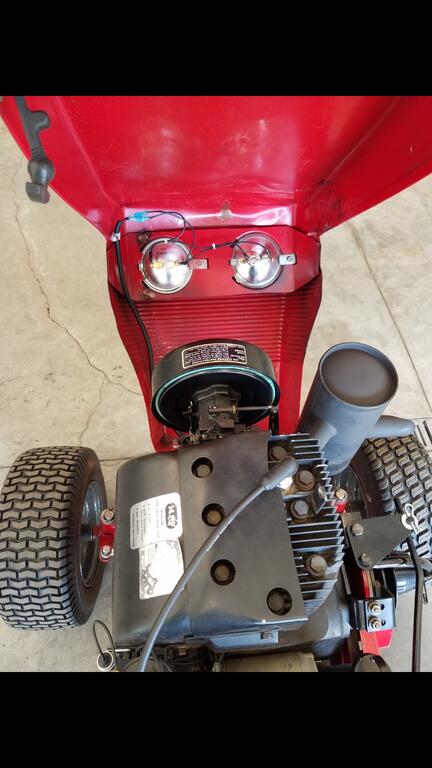

Mustang67ford 234 #29 Posted March 31, 2022 Got it fired up for the first time and took it for a spin. Circuit board lights are all working. Left the hood off so I can change points and check valves which I have to remove the carb to do. Still need to do something about the rims and tires. The only issue I am having so far, is the pto drum wants to spin with the motor. The brake is not working. If I push the pto brake in, then it pushes it against the clutch disk. I can stop the drum by hand and I can see a small gap between it and the clutch disk, but I can feel it wanting to spin. The drum is brand new. 2 2 Share this post Link to post Share on other sites

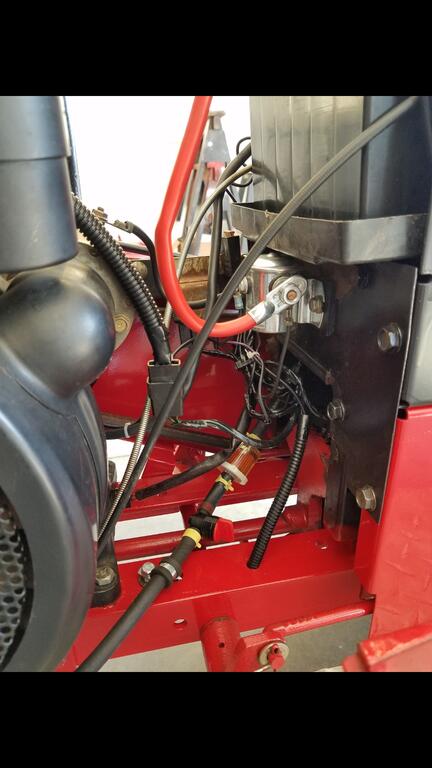

peter lena 10,103 #45 Posted April 7, 2022 @Mustang67ford , like that steering flange bearing , have that on my horses . did you add ground cable to your battery bolt cable area ? add that to you engine / frame area ?. from that to rectifier on engine cooling tins , and from that to headlights . like a solid ground for related electrics , bright lights , faster starts . use lucas x-tra heavy duty , green chassis grease on that pto cone needle bearing . just a light coating , no noise or issues , no brake on my pto set up , spins with silent ease . lookin good , pete 1 Share this post Link to post Share on other sites

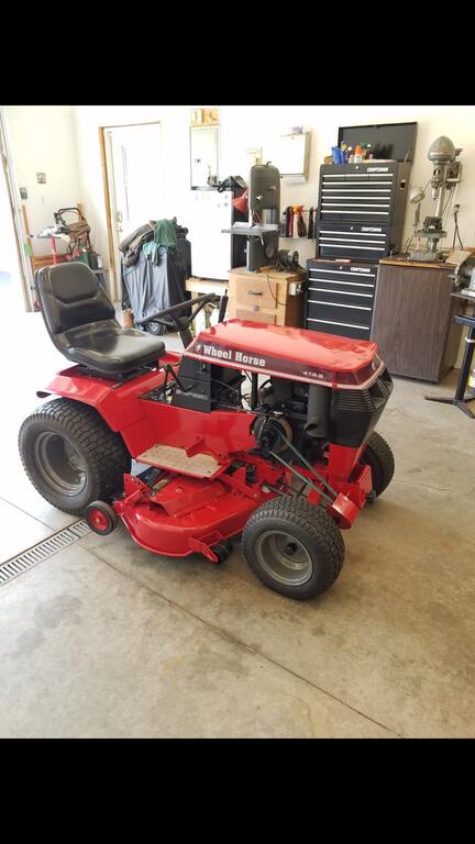

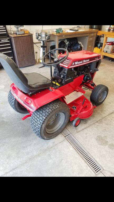

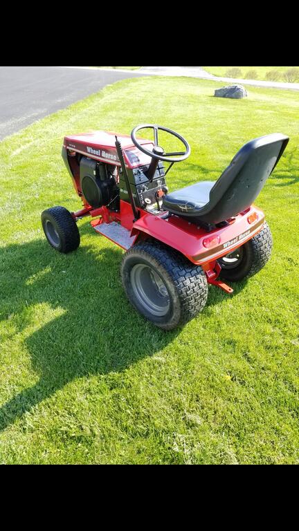

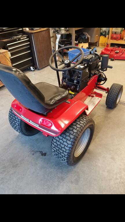

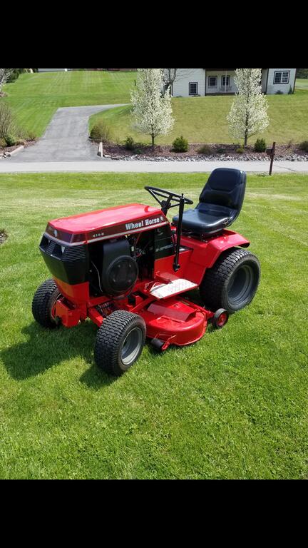

Mustang67ford 234 #47 Posted April 24, 2022 Restoration complete. 1 Share this post Link to post Share on other sites

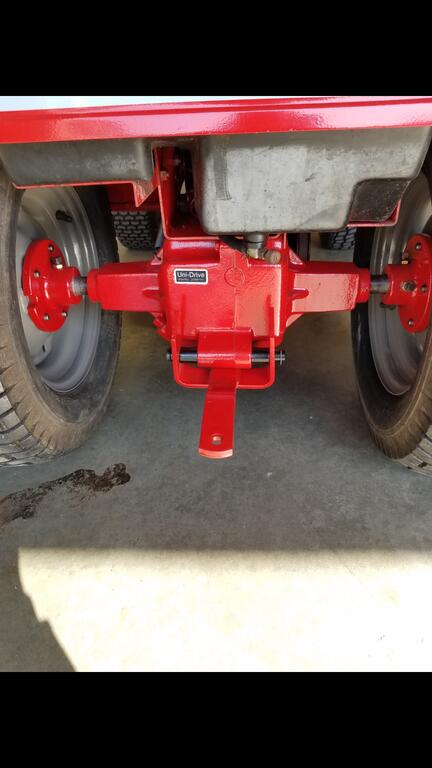

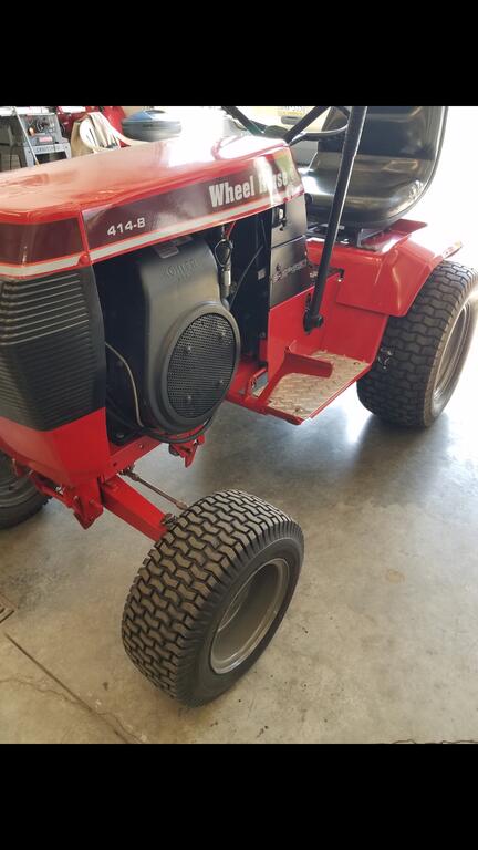

Mustang67ford 234 #48 Posted April 24, 2022 A few more pics 1 2 Share this post Link to post Share on other sites
