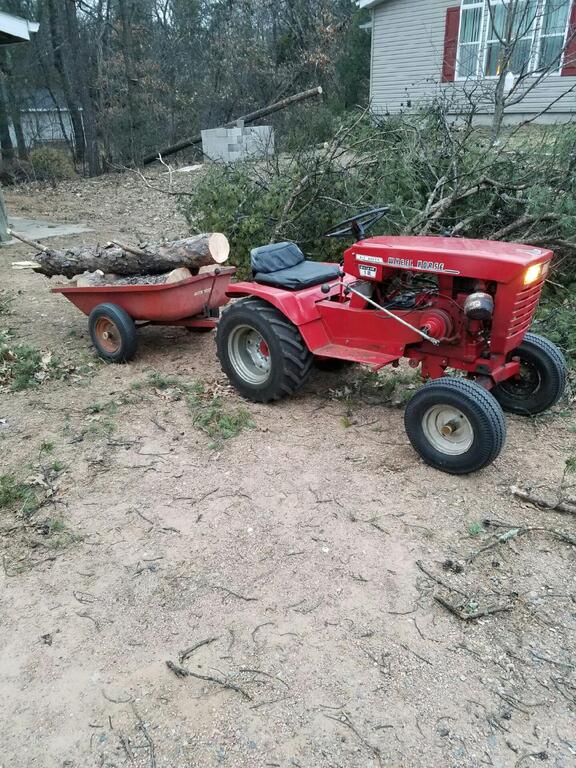

Floyd Pink 44 #7 Posted March 13, 2022 5 hours ago, oliver2-44 said: Need I say more I have a few. Need to take new ones with all the attachments finished. 5 4 1 Share this post Link to post Share on other sites

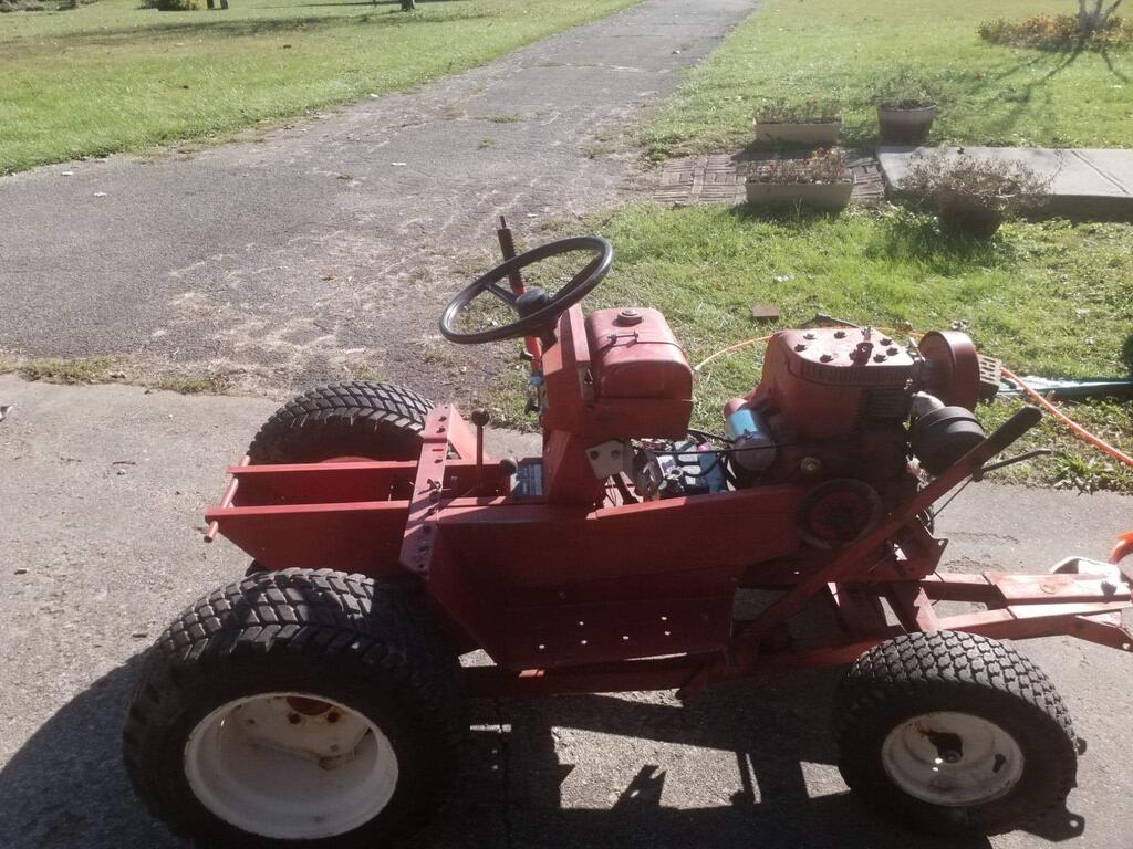

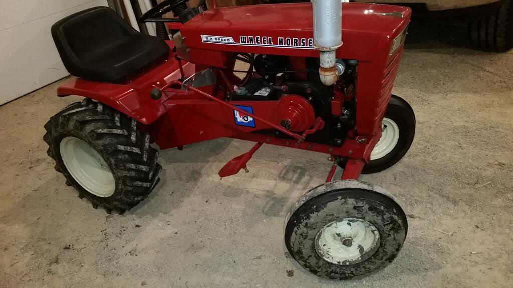

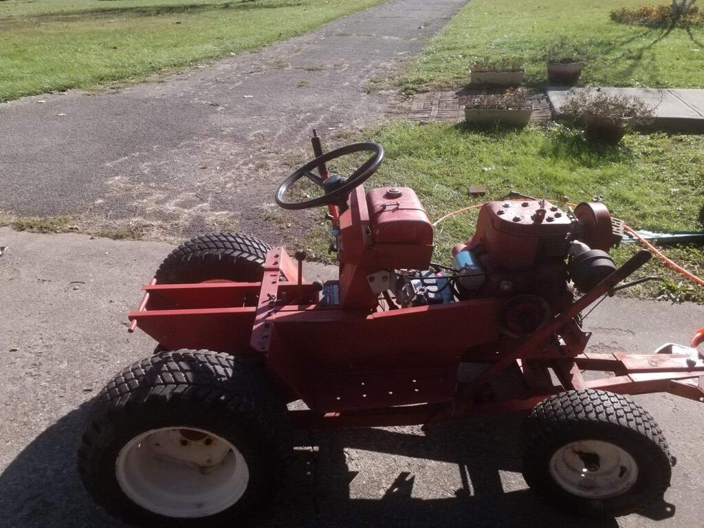

WHX?? 58,268 #18 Posted March 14, 2022 (edited) BTW Floyd '68 Raider 12 is a favorite model of mine. I inherited it after my stepson smoked the motor field plowing and failing to check the oil. I rebulit the motor and just a all a round go to worker as well as a loaner tractor at plow day. 7 hours ago, Floyd Pink said: Also both foot rests. Do you mean the pre '68 stirrup style foot rests. Not a huge fan of floor boards on a Raider so I replaced mine with them. Like those in the second pic & my favorites. Edited March 14, 2022 by WHX?? Share this post Link to post Share on other sites
