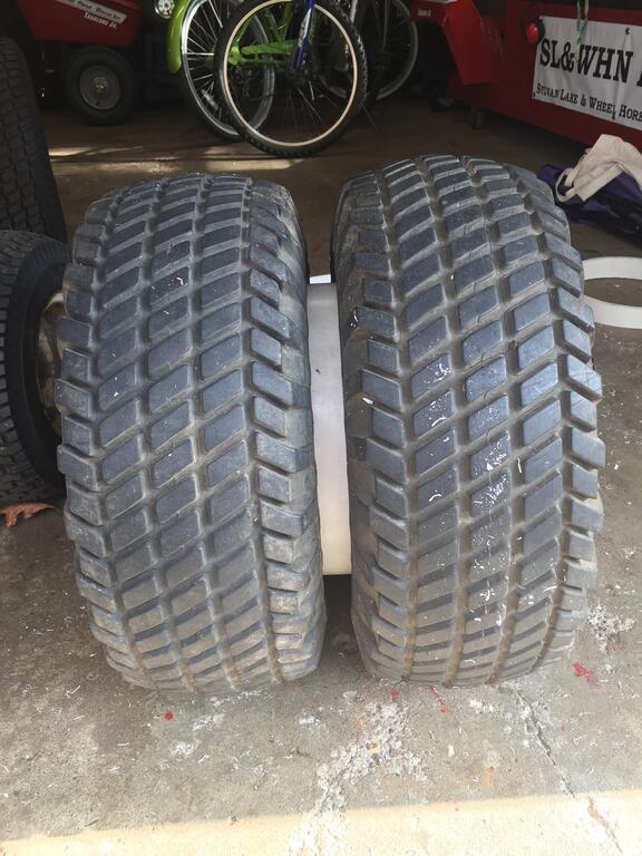

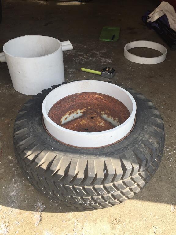

SylvanLakeWH 31,715 #7 Posted March 12, 2022 If you decide to do duallys, here’s an idea that is totally adjustable to different offsets… they worked great… 12” pvc pipe. 2 3 Share this post Link to post Share on other sites
Pullstart 70,683 #8 Posted March 13, 2022 Those 12” PVC spacers work swimmingly! 2 Share this post Link to post Share on other sites
