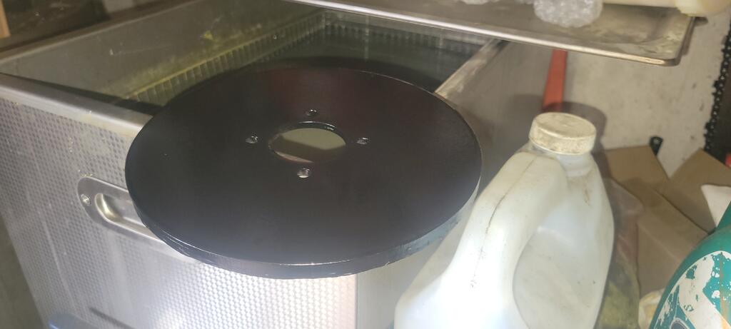

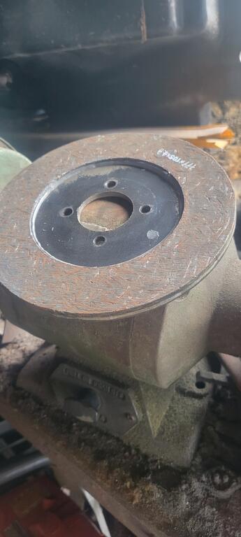

RED-Z06 2,720 #1 Posted March 11, 2022 I have 3 tractors that use these clutch discs so its nice to have a spare. The original on my 416 shattered last year and i bolted on my spare..but that left me with none. I ordered a Deere B2354R which was a pulley clutch liner for a B/520 etc. Its the right thickness, right inner diameter, outer diameter is like 1/8" larger. I cleaned my plate with a wirw wheel, scuffed it, then wiped with mineral spirits. I wiped the liner off too. Then mixed up some jb weld? Put a uniform layer on the disk and centered it on the plate, then set it in my press overnight between the iron plates and probably no more than 200lbs of pressure. Then cleaned up the edge in about a minute on the bench grinder and painted the back of the plate and edges. Should work fine, did a similar repair years ago on another brand and it held up great. 9 5 Share this post Link to post Share on other sites

Moparfanforever 940 #3 Posted March 11, 2022 Looks like it is for the larger PTO ?? Share this post Link to post Share on other sites

RED-Z06 2,720 #5 Posted March 11, 2022 11 minutes ago, Moparfanforever said: Looks like it is for the larger PTO ?? What year was the change? Share this post Link to post Share on other sites
Sparky-(Admin) 26,493 #6 Posted March 11, 2022 That came out real nice! 1 1 Share this post Link to post Share on other sites
RED-Z06 2,720 #7 Posted March 11, 2022 OHere is where i painted the back and edge...ill hang it on the wall, should i ever need it 1 Share this post Link to post Share on other sites
Moparfanforever 940 #8 Posted March 11, 2022 2 hours ago, RED-Z06 said: What year was the change? Not sure when the change was,but I think the old pto was six inches. Can't remember the size of the newer style , old age. Share this post Link to post Share on other sites
