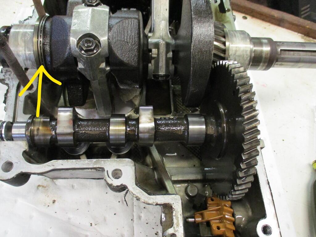

pfrederi 20,883 #16 Posted March 9, 2022 2 hours ago, kpinnc said: Google your engine for the service manual and see what it has for bearings. Some Preds have ball bearing supported cranks and some don't. Either way, nearly all engines are designed for side loads. Axial loads are another thing- and WH PTOs create a big axial load. If your engine has ball bearings, you should be fine. If not, as has been said the jury is out. Onans for all thier power do not have bearings, nor do any Kohler twins. They still run for years. Not true... WH specified a thrust bearing in the KT-17s and M-18 they used. Very few other users paid the extra.... 2 1 Share this post Link to post Share on other sites
kpinnc 18,756 #18 Posted March 9, 2022 3 hours ago, pfrederi said: Not true... WH specified a thrust bearing in the KT-17s and M-18 they used. Very few other users paid the extra.... Well I learned something new. I never knew the Kohler twins had them. 2 Share this post Link to post Share on other sites

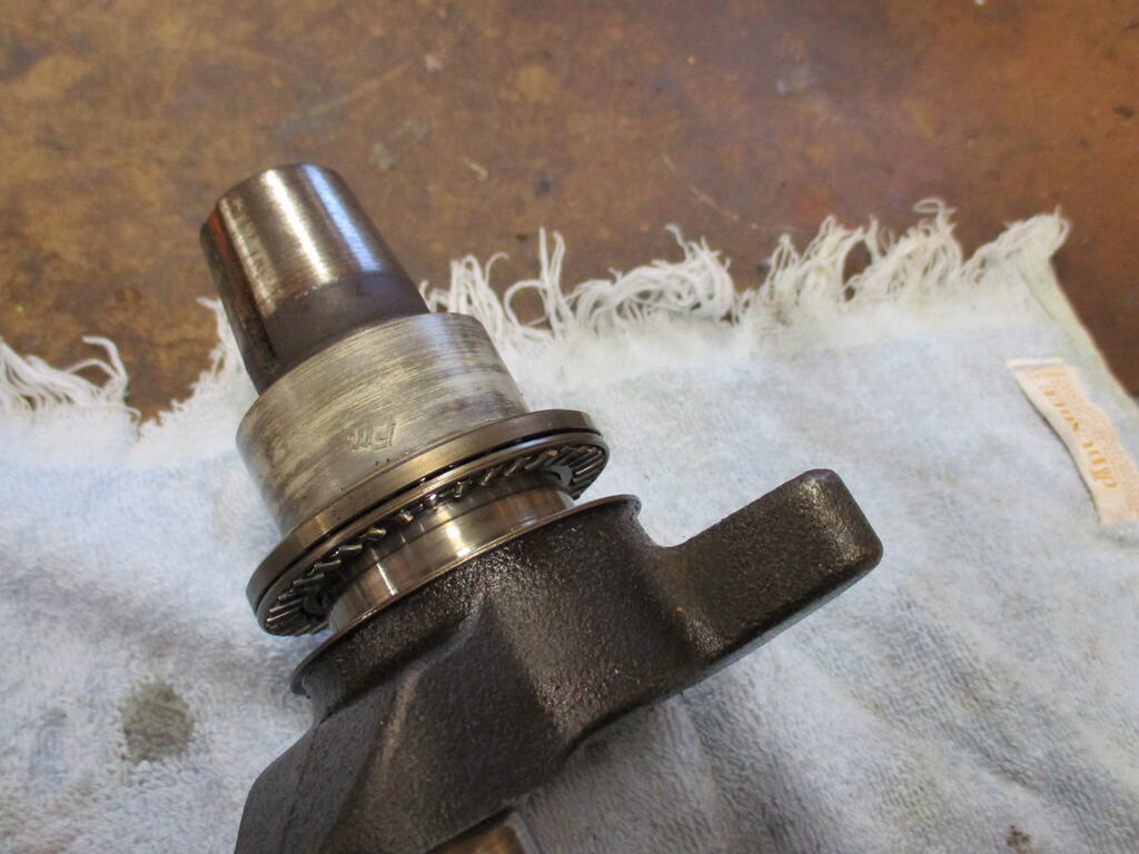

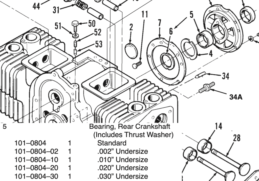

Handy Don 16,961 #19 Posted March 9, 2022 20 hours ago, kpinnc said: Onans for all thier power do not have bearings, nor do any Kohler twins. They still run for years. Well I learned something as well. Always thought Onan's did have ball or roller bearings. Jumped over to the P220 IPL and grabbed this. Rear bearing is #5. Note the undersize options! 1 Share this post Link to post Share on other sites
pfrederi 20,883 #20 Posted March 9, 2022 The thrust needle bearing on the Kohlers looks more substantial than the #4 thrust washer in the Onan 1 Share this post Link to post Share on other sites
Handy Don 16,961 #21 Posted March 9, 2022 (edited) 11 minutes ago, pfrederi said: The thrust needle bearing on the Kohlers looks more substantial than the #4 thrust washer in the Onan #4 is only a spacer shim for eliminating crankshaft sideways movement -- they come in several thicknesses to be added as needed. The thrust washer is #6. Edited March 9, 2022 by Handy Don 1 Share this post Link to post Share on other sites
lynnmor 8,914 #22 Posted March 9, 2022 3 minutes ago, pfrederi said: The thrust needle bearing on the Kohlers looks more substantial than the #4 thrust washer in the Onan Actually a plain thrust washer type of bearing can handle a lot of load. Keep in mind that the needles have only a tiny line of contact at each one, and the thrust washer has full contact. 1 Share this post Link to post Share on other sites
kpinnc 18,756 #23 Posted March 9, 2022 27 minutes ago, Handy Don said: Always thought Onan's did have ball or roller bearings. Me too, until I took mine apart. I guess the full pressure oil is the saving grace for the crank bearings. My P218 crank was still very smooth and quite snug in the bearings at 800 hours. 7 minutes ago, lynnmor said: Actually a plain thrust washer type of bearing can handle a lot of load. I'm a little confused. Thrust washers and thrust bearings are not the same thing. My Onan has no thrust bearings. 1 Share this post Link to post Share on other sites
lynnmor 8,914 #24 Posted March 9, 2022 Just now, kpinnc said: I'm a little confused. Thrust washers and thrust bearings are not the same thing. My Onan has no thrust bearings. Definition of a bearing: a part of a machine that bears friction, especially between a rotating part and its housing 2 Share this post Link to post Share on other sites
