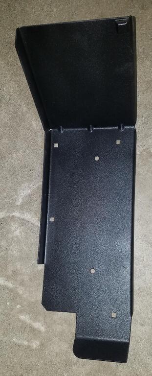

JoeM 10,317 #1 Posted March 5, 2022 Been messing around with some parts that need painted and were pitted but not rusted out. I read where it will adhere if you can paint over top of bedliner coating if done within the first 24 hours after the bedliner coating is applied. Tried a couple foot pads and they seem pretty durable. Trying it on a seat pan now. before paint after 7 4 Share this post Link to post Share on other sites

JoeM 10,317 #5 Posted March 6, 2022 Iron Armor Truck Bed Coating from Harbo Fright. No rust, metal was wire cup wheeled to bare metal and primed with Rustoleum primer. Light sand with 500. To get the consistent coating I had to hold the can about 20 inch away from the piece or it was spotty and streaky. I tested Rustoleum bed coating and it gave a more uneven texture. 2 1 Share this post Link to post Share on other sites

JoeM 10,317 #10 Posted March 6, 2022 (edited) 12 hours ago, OutdoorEnvy said: Are you doing the rest of the tractor too now? All but the hood. I have the foot pads done top and bottom like the seat pan. I put a tape in lay on the foot pans so the tread tape would stick. I forgot to do this on the rear pan for the decal. might have to improvise. I have it all done in a couple week and will post a pic or two. Edited March 6, 2022 by JoeM 5 Share this post Link to post Share on other sites

Brockport Bill 2,498 #12 Posted March 17, 2022 i did my footrests with bedliner black a couple weeks ago at suggestion of a Red Sq friend --- came out looking good -- primer, plus 3 coats of BL spray -- i was looking to mirror the "black" appearance elsewhere on tractor -- black engine, tires, steering wheel, black hood C175, tunnel and dash plates, etc --- the idea to do footrests started with discussion about availability and where to get footrest tread material - so decided to try the bedliner spray as alternative --- have not yet reinstalled the footrests on tractor, or actually used yet to determine effeciveness of being "slip proof" etc -- but at least they look cool so far Share this post Link to post Share on other sites
