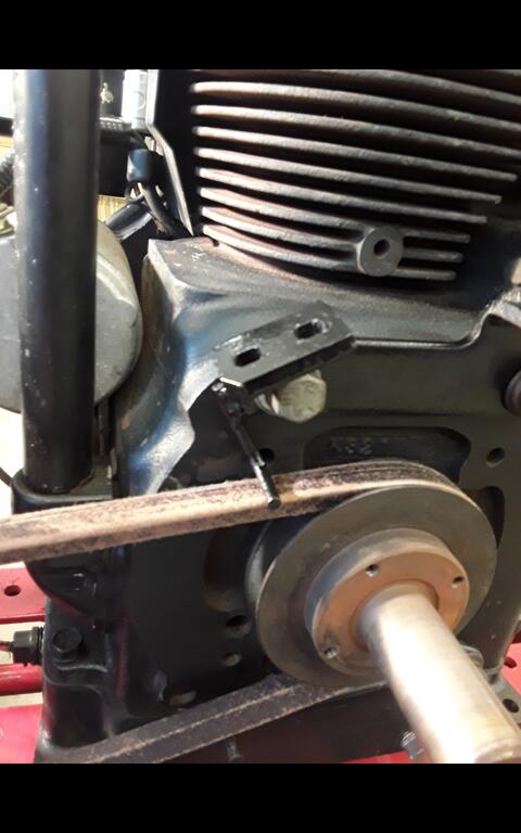

Mustang67ford 234 #1 Posted March 5, 2022 (edited) The manual says to adjust the upper and lower belt guides to 5/32" gap. Got the lower one adjusted, but my upper guide has no adjustment? The guide is welded fast to the bracket. Looking at the parts list, there appears to be 2 brackets, one of which I beIeve is mine #111241. So I'm assuming you can't adjust the upper guide on my tractor? Edited March 5, 2022 by Mustang67ford Share this post Link to post Share on other sites
stevasaurus 23,848 #2 Posted March 5, 2022 If you loosen the bolt that holds that guide, you should be able to turn it up a little and re-tighten the nut. You could also bend a new piece of wire to replace the one you have. 3 Share this post Link to post Share on other sites
