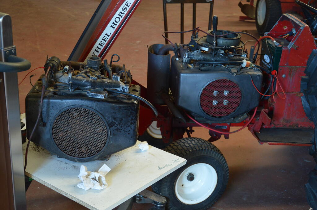

Maxwell-8 4,371 #1 Posted March 4, 2022 Got two non running KT17's. Both for in my Blackhood C-175's One is 69 engines later build then the other. The one currently installed in my C175 hydro was bought separate some time ago. It doesn't not have spark. The loose engine was the original engine on the C-175 8 speed. It has oil in the rear cylinder. Is that even possible with correctly filled engine oil? Compression in the front is only 72 PSI, but the rear cylinder(the one with oil has a decent 110 PSI. the M16 coming of the C-175 hydro has 140PSI of compression (all are measured cold) How much PSI does a kohled need to be considered healthy? You think this one could run with the current compression? This one does not have spark either. 1 Share this post Link to post Share on other sites

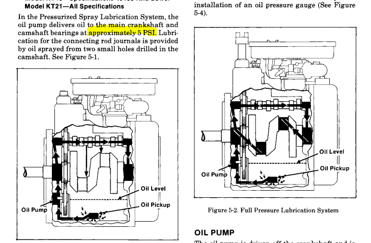

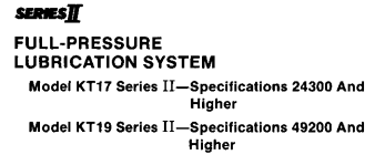

Maxwell-8 4,371 #8 Posted March 5, 2022 (edited) I am searching if whit correct oil level, oil comes in contact with the cylinder. Searched thru the manual and service manual. come across this. the difference between a series 1 and a series 2. Oil pressure is just 5PSI, which is barely anything. oil is sprayed from holes in the cam on to the crankshaft. therefore not being able to handle angles very well. Edited March 5, 2022 by Maxwell-8 2 Share this post Link to post Share on other sites
953 nut 67,480 #9 Posted March 5, 2022 2 hours ago, Maxwell-8 said: Oil pressure is just 5PSI, which is barely anything. oil is sprayed from holes in the cam on to the crankshaft. therefore not being able to handle angles very well. True, but that is 5 PSI more than a splash lubricated single cylinder and many of them are doing fine after fifty years or more of operation. 3 Share this post Link to post Share on other sites
oliver2-44 11,632 #10 Posted March 5, 2022 18 hours ago, Maxwell-8 said: Got two non running KT17's. @Maxwell-8 Are both these engines the Series II engines with oil pumps. if yyou,re not sure post their serial numbers and the experts will let us know. 1 Share this post Link to post Share on other sites

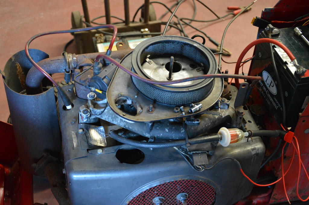

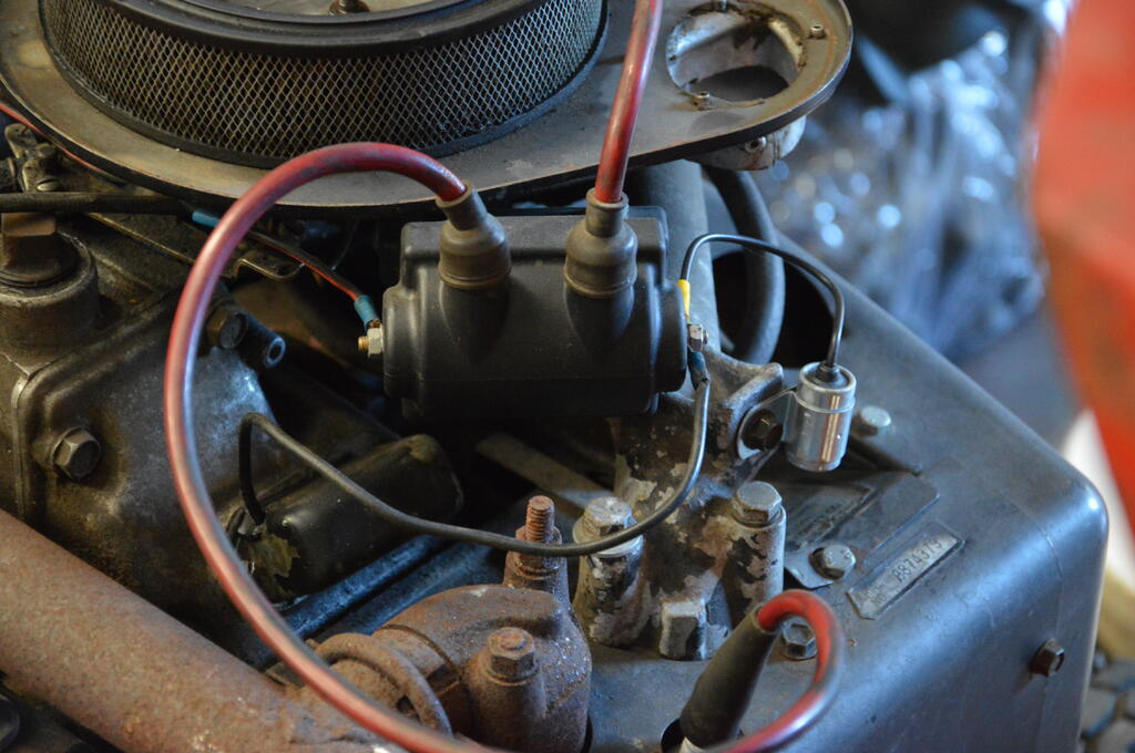

Maxwell-8 4,371 #16 Posted March 5, 2022 1 hour ago, Bill D said: Clean the points before you condemn the coil. If they are Series 1 engines, hopefully they were used on flat ground. Found out that when I turned the key to much when cranking the kohler on the C175 hydro( the one mounted) It would loss power to the coil. So cranking not so hard I have spark. I got her to sputter with starter fluid. So I am going to clean the carb. Share this post Link to post Share on other sites

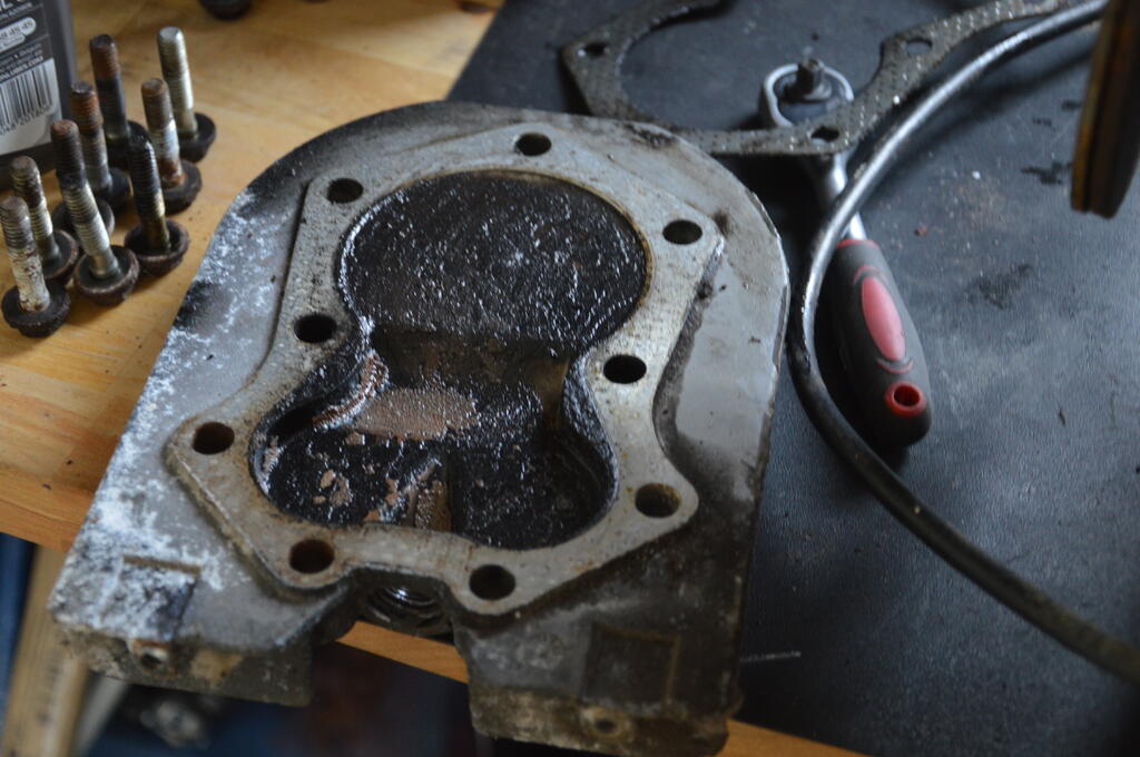

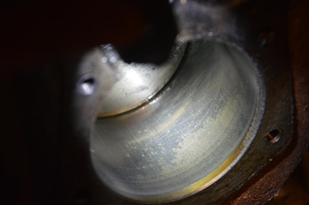

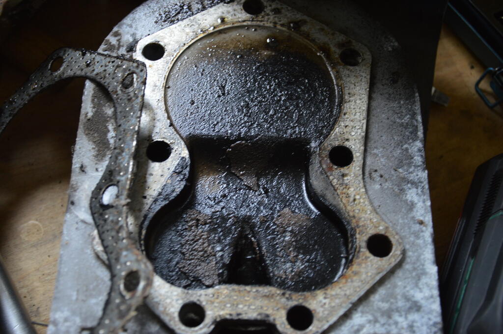

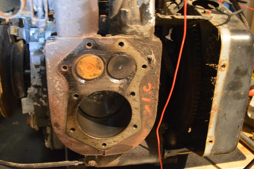

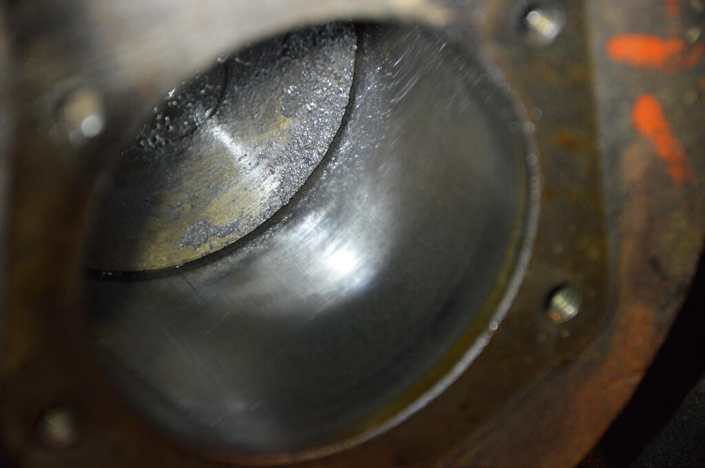

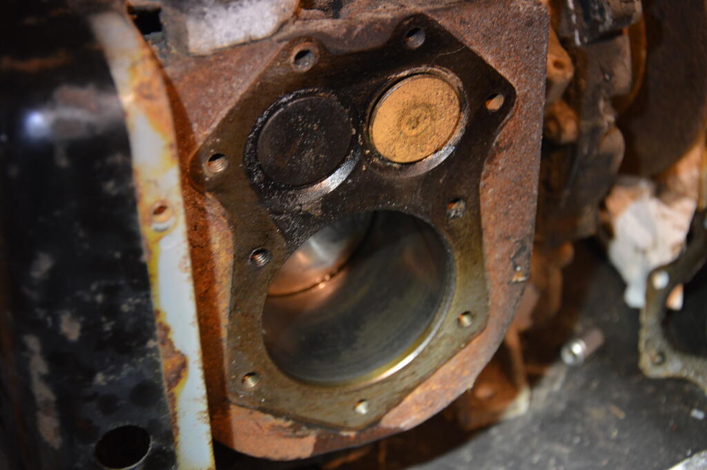

Maxwell-8 4,371 #17 Posted March 5, 2022 00:00 is the current time here: Couldn't go to bed before popping those heads, so I did. Only 2 bolts from the shrouds broke. One intake valve on the lower compression side can be spun around the full cycle. I can see the honing marks on the sides, but is gone on the top an bottom part of the bore. With my finger, I can't feel the transition of where the rings go an don't go. If any, I can feel a bit carbon build up. I think it may have a shot of getting it back running. I just cleaned the cylinderwalls, let's see I f there is oil tomorrow front cylinder: low compression Rear cylinder: had some oil in it 1 Share this post Link to post Share on other sites

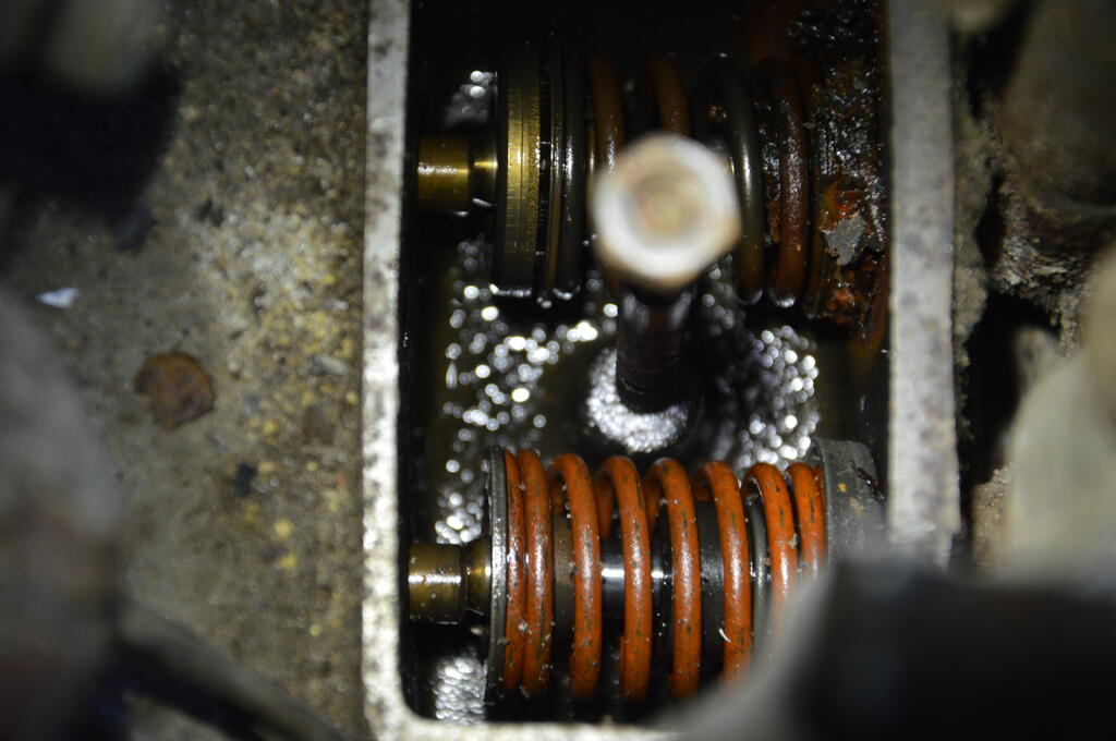

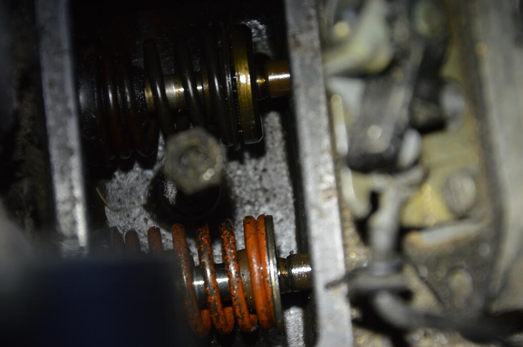

Maxwell-8 4,371 #19 Posted March 6, 2022 No valve clearance on both sides. I have never seen this. The engine must have a lot of hours on it then? FRONT: REAR: Share this post Link to post Share on other sites
Maxwell-8 4,371 #20 Posted March 6, 2022 I can spin all 4 valves with my fingers. Is this normal? don't think so, but would it effect compression that much? Share this post Link to post Share on other sites
lynnmor 8,914 #21 Posted March 6, 2022 19 minutes ago, Maxwell-8 said: I can spin all 4 valves with my fingers. Is this normal? don't think so, but would it effect compression that much? No, not normal. Yes, spinning the valves may be near zero to a lot of opening. With the buildup on the intake valve area, the valve guides are probably worn. 1 Share this post Link to post Share on other sites
Maxwell-8 4,371 #22 Posted March 6, 2022 4 minutes ago, lynnmor said: No, not normal. Yes, spinning the valves may be near zero to a lot of opening. With the buildup on the intake valve area, the valve guides are probably worn. The heads were full of carbon buildup Can the valve guides be replaced? Or should a just set the valve lash and maybe regrind the valve seats? Share this post Link to post Share on other sites
lynnmor 8,914 #23 Posted March 6, 2022 8 minutes ago, Maxwell-8 said: The heads were full of carbon buildup Can the valve guides be replaced? Or should a just set the valve lash and maybe regrind the valve seats? Looks like you have worn rings, maybe other wear. Valve guides can be replaced. Yes, grind the valve seats and adjust. 1 Share this post Link to post Share on other sites
Maxwell-8 4,371 #24 Posted March 6, 2022 2 minutes ago, lynnmor said: Looks like you have worn rings, maybe other wear. Valve guides can be replaced. Yes, grind the valve seats and adjust. Thanks a lot for your input sir. No idea how many hours are on the engine but I assume a lot. Could I reuse the old headgaskets just to test compression, because they are hard to find and super expensive. I need to now if the engine needs a full rebuild. Because if it needs it, I am done. Parts are untraceable here and would have to import most of it from the US. Share this post Link to post Share on other sites
pfrederi 20,883 #25 Posted March 6, 2022 (edited) Valve guides can be replaced but there are 4 of them and they are $32 Each!!! if you can find them, valves about $90 for 4. Check at some point Kohler changed 30 degree and 45degree... Like my KT17s but after rebuilding an M-18 and the price invoved will not do it for a KT17.... Edited March 6, 2022 by pfrederi 1 Share this post Link to post Share on other sites
