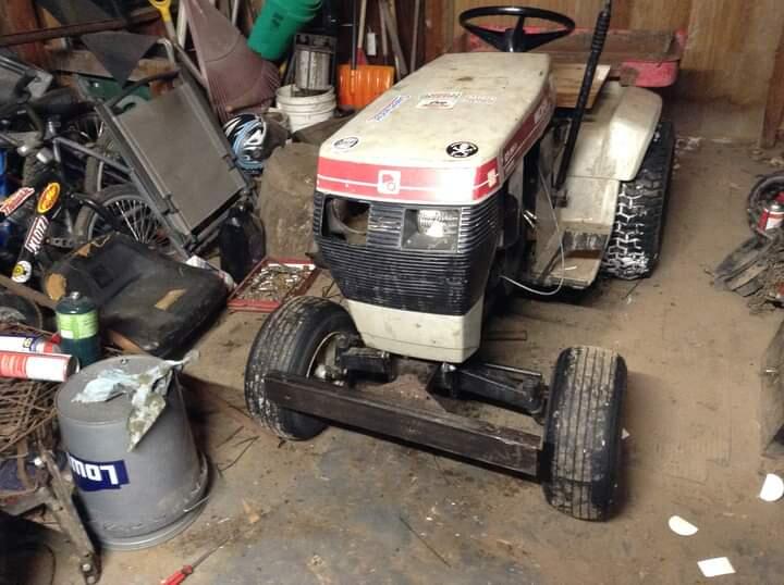

Travas 13 #1 Posted March 4, 2022 Hello everyone. I've been lookin for a head bolt for my gt1100. Can't seem to find anything for it on any part websites. Can't exactly finish up this engine without it as one broke... If I can't find a head bolt I guess imma put I new motor in. Came here to see if you guys have one or know where to find one. Thanks! Share this post Link to post Share on other sites
