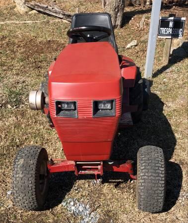

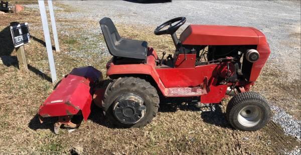

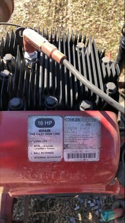

Pullstart 71,215 #8 Posted March 4, 2022 It is missing the tins on the head. Tells me it’s been apart before. And neglected to be repaired correctly. 8 1 Share this post Link to post Share on other sites

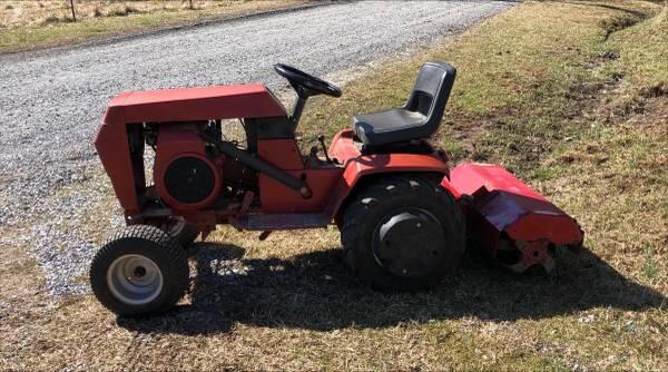

Sparky-(Admin) 26,322 #9 Posted March 4, 2022 I’m not 100% convinced it is a 416…motor looks like a transplant so it could be a 310 or a 312 that someone dropped a K341 into. If that was the case it might have the “weaker” 4 pinion with 1” axles trans. The motors were black on the 416’s and they had a real muffler and not a stub of pipe with that pepper pot style mufffler screwed on. Not saying it isn’t worth checking out, but look it over real good. And the asking price is really high in my opinion. 8 1 Share this post Link to post Share on other sites

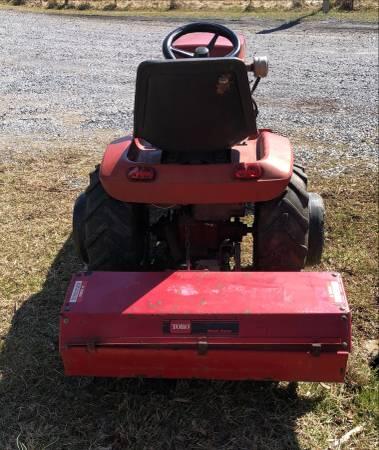

pfrederi 21,145 #12 Posted March 4, 2022 Hard to be sure but the tiller tines look pretty worn... replacement is big $$$ 2 Share this post Link to post Share on other sites
WHX?? 58,075 #13 Posted March 4, 2022 Yeah 3 hr drive to see it's a bit over priced and a franken horse. Sparky nailed it I'd have ta pass on that one. 2 Share this post Link to post Share on other sites

kpinnc 18,940 #17 Posted March 4, 2022 (edited) 7 hours ago, Sparky said: Not saying it isn’t worth checking out, but look it over real good. And the asking price is really high in my opinion. Mike is right- definitely NOT a 416-8. If you look at it from the back, those are definitely not 1.125 axles. But- the front spindles are short for the 8 inch wheels. Add all the paint problems and to me it looks like a cobbled machine from parts of more than one. I can't be 100% certain, but that rear fender looks like a Work Horse fender. They didn't have the little stiffening bend across the bottom rear like regular Wheel Horses. Nothing wrong with a cobbled machine if done correctly, but that one is massively overpriced. Edited March 4, 2022 by kpinnc 1 1 Share this post Link to post Share on other sites

kpinnc 18,940 #25 Posted March 5, 2022 17 hours ago, Horse Newbie said: We learned something… last Saturday… Yep. Plus the holes on top are different. Definitely not the same metal painted grey. 1 Share this post Link to post Share on other sites
