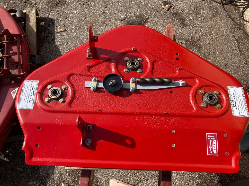

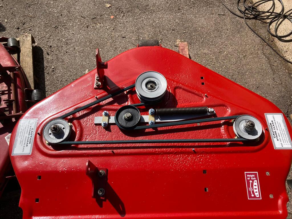

"Manic-Mechanic" 1,485 #1 Posted March 3, 2022 I can tighten 2 of the 3 spindles, the third begins to get stiff. However the assembly does use a nyloc nut that I can back off a tad. Also, this is a modified 5-0620 and the one piece cover will no longer fit. Can the two piece covers work from the 5-36YR01? LH 107449 RH 107050 Share this post Link to post Share on other sites
Goldnboy 1,117 #2 Posted March 3, 2022 I no longer use nylon lock nuts on any of my deck spindles. I use a lock washer and half nut. It also allows you to remove the woodruff key. There was a service builten in the files section about this upgrade. 1 Share this post Link to post Share on other sites
"Manic-Mechanic" 1,485 #3 Posted March 3, 2022 4 hours ago, Goldnboy said: I no longer use nylon lock nuts on any of my deck spindles. I use a lock washer and half nut. It also allows you to remove the woodruff key. There was a service builten in the files section about this upgrade. Yes, I was just talking about that kit with Lincoln earlier today. I found the bearings were mucked up, spindle shaft had a warbled out keyway too. So gonna put the order in for all new bearings, a lot of work shame if I let the other two spindles slide... Share this post Link to post Share on other sites
Handy Don 16,683 #4 Posted March 4, 2022 6 hours ago, Goldnboy said: I no longer use nylon lock nuts on any of my deck spindles. I use a lock washer and half nut. It also allows you to remove the woodruff key. There was a service builten in the files section about this upgrade. Can you share the logic for this or link to the service bulletin, please? Wasn't aware of this. Share this post Link to post Share on other sites
"Manic-Mechanic" 1,485 #5 Posted March 4, 2022 1 hour ago, Handy Don said: Can you share the logic for this or link to the service bulletin, please? Wasn't aware of this. This is what I had seen WH61-90 #429 Deleting Pulley Key on Greaseable spindles.pdf Share this post Link to post Share on other sites
Handy Don 16,683 #6 Posted March 4, 2022 14 hours ago, "Manic-Mechanic" said: This is what I had seen WH61-90 #429 Deleting Pulley Key on Greaseable spindles.pdf 556.5 kB · 7 downloads Aha! Thanks for the link. Gist is that if using the key, the self-locking nut is fine but to skip the key you need the "free running" nut so that the pulley rotation will torque it down. Clever! 1 1 Share this post Link to post Share on other sites
