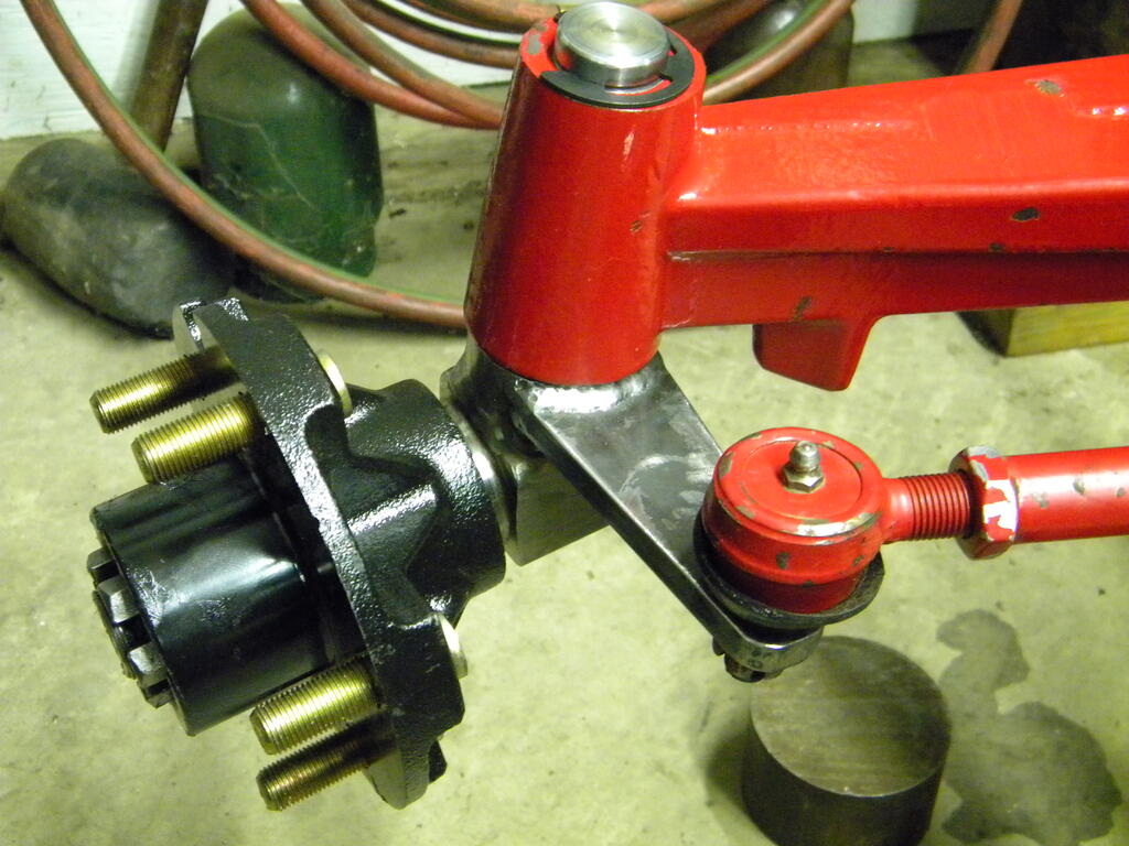

jeepdan 337 #34 Posted March 19, 2022 After boring the tapered holes for the tie rod studs, I welded the steering arms on. 2 2 Share this post Link to post Share on other sites
