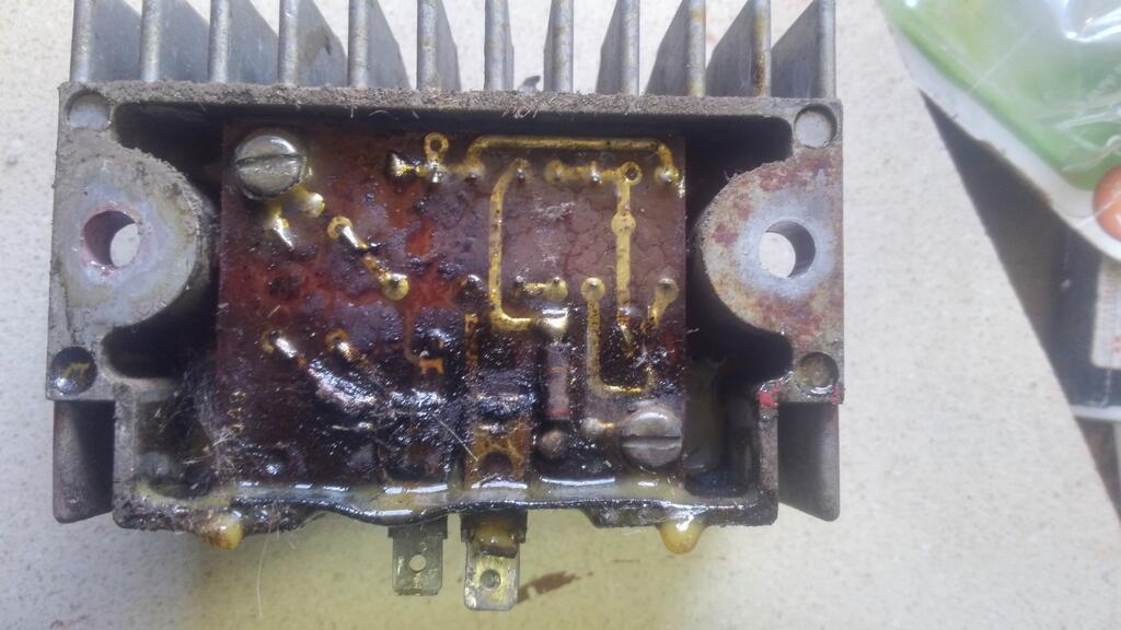

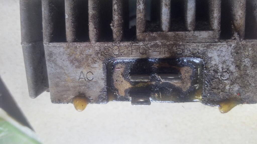

Rusty Tinsnips 477 #1 Posted March 1, 2022 One day getting ready to plow snow and the Raider 14 won't start due to low battery. This is a new battery put in 2 months ago. I jump start it and I notice the ammeter is showing about 5v discharge. So after plowing I check the battery with a digital meter and it shows about 12v when not running and 12 to 15 (all over the place) when running. Today I put a new regulator on and get 15v to 16v running. Battery has been on a tender for a week or so. It reads 13.6 not running. This is what I see when I took the old one off. The ammeter still shows 5v discharge and around 7v discharge with lights on when running. 1 Share this post Link to post Share on other sites
oldlineman 1,748 #2 Posted March 1, 2022 I would say remove the amp meter and install a voltmeter. 2 1 Share this post Link to post Share on other sites
squonk 47,263 #3 Posted March 1, 2022 That regulator is just about toast. Get a new one. Clean the mounting surface so it gets a good ground and clean/replace the wire terminals. Most likely the wire connections got funky and it increased the amps flowing through the regulator and started a nice slow cook. 1 1 Share this post Link to post Share on other sites

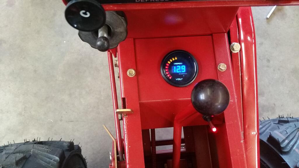

WHX?? 57,276 #16 Posted March 4, 2022 (edited) I have two of these now https://www.ebay.com/itm/303334048943 with good luck. Edited March 4, 2022 by WHX?? flip pic Share this post Link to post Share on other sites
Handy Don 16,914 #17 Posted March 4, 2022 1 hour ago, WHX?? said: I have two of these now https://www.ebay.com/itm/303334048943 with good luck. How does one interpret the red and orange dots? Share this post Link to post Share on other sites
WHX?? 57,276 #18 Posted March 4, 2022 I forget exactly what voltage the lights transition at. In a nut shell the lower the voltage drops the more the orange lights drop out. Once it it hits about 13 volts a series of green lights start. So green is charging good, orange is ok and red is you is just running on battery and gonna run out of go juice. It was just meant to be some eye candy for a custom 1055 build. I liked it so much that got one for a C-145 to replace a ammeter that was useless. The 145 had no regulator just a rectifier that overcharged with long seat times so this was a really a nice way to monitor and avoid cooking the battery. If the voltage got too high I flip the headlights on to bring the voltage back down. For less than a Jackson I really expected it to only last a couple of years but going on what three now and still works good. Build thread here... 1 Share this post Link to post Share on other sites
