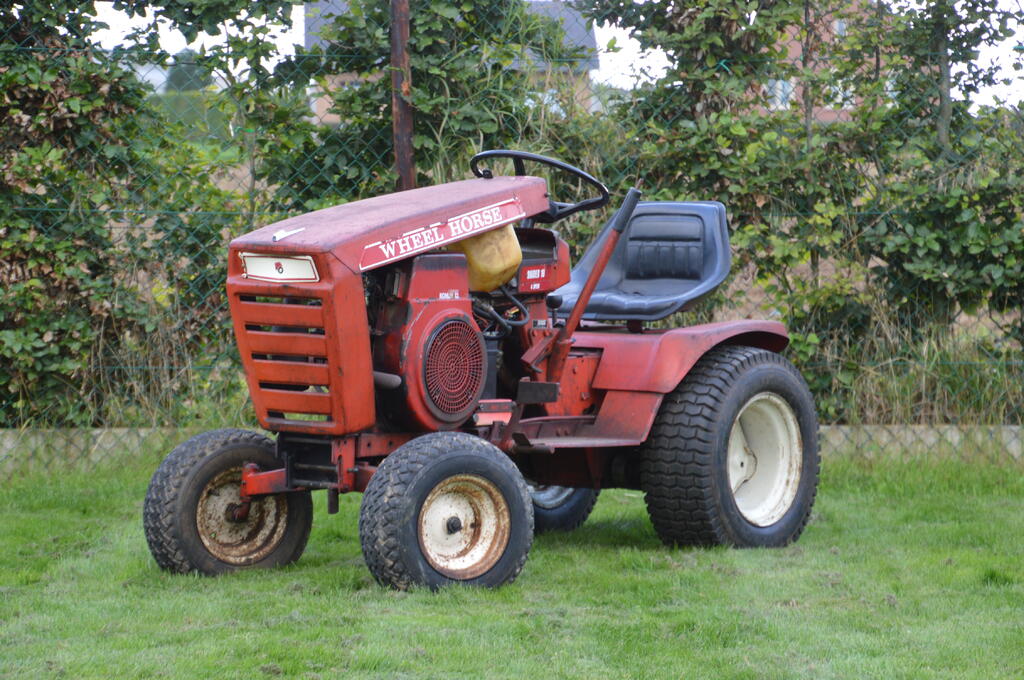

D_Mac 9,332 #10 Posted February 28, 2022 I have tried paste wax it does work nice but my go to is a good washing with a degreaser. After the wash I wipe it all down with boiled linseed oil and elbow grease. Yes, a good baking in the sun helps. This 500 Special was cleaned and oiled. Only the wheels, engine, and plow were painted. I also have done this on other tractors and then hit them up with a little clear. Share this post Link to post Share on other sites

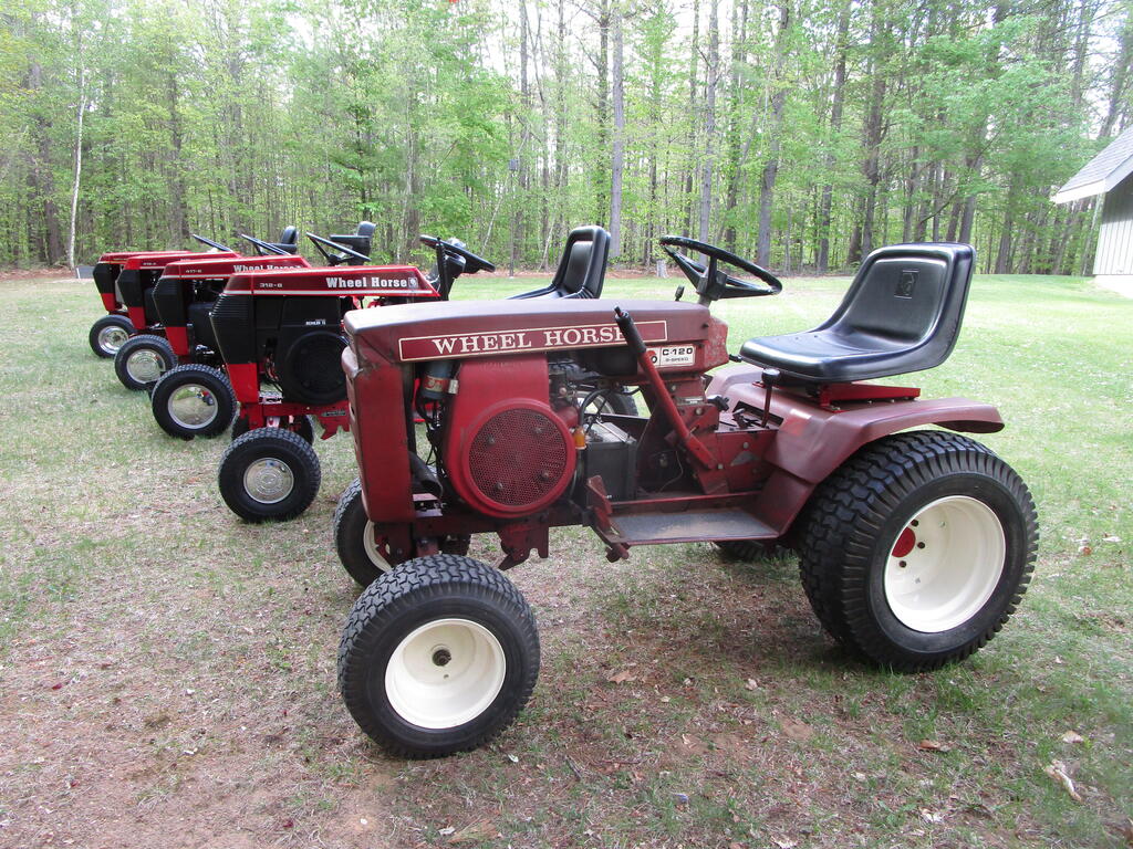

JCM 10,451 #12 Posted February 28, 2022 I learned the WD-40 trick on RS. Beforehand ,I use simple green cleaner undiluted with a wet grout type sponge, let dry then a scotch brite pad then clear water again with a rinsed sponge then let dry and using a clean cotton rag with WD on it and just go over it. I don't worry about the dust as this C-120 is lucky if it gets more than 2 or 3 hours a year on it, but do start it and let it run regularly. Before and after pics. 2 Share this post Link to post Share on other sites
