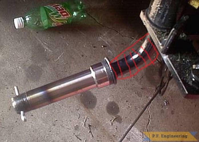

Sailman 1,307 #1 Posted February 27, 2022 Looking to beef up the the front spindles on my C-160 for a FEL and the OEM upgrade that came with loaders appears to be unobtaineum...Ran across this video from "I save tractors" that looks to be a great conversion. Here is the link to the video https://www.loaderplans.com/spindle-upgrade He is doing it on a cub cadet but the idea of mounting 1 inch spindle over the 3/4 spindle seems brilliant. Any one try this yet or what are your thoughts about this being a viable option? Appreciate all comments.... 1 Share this post Link to post Share on other sites

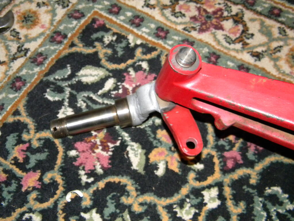

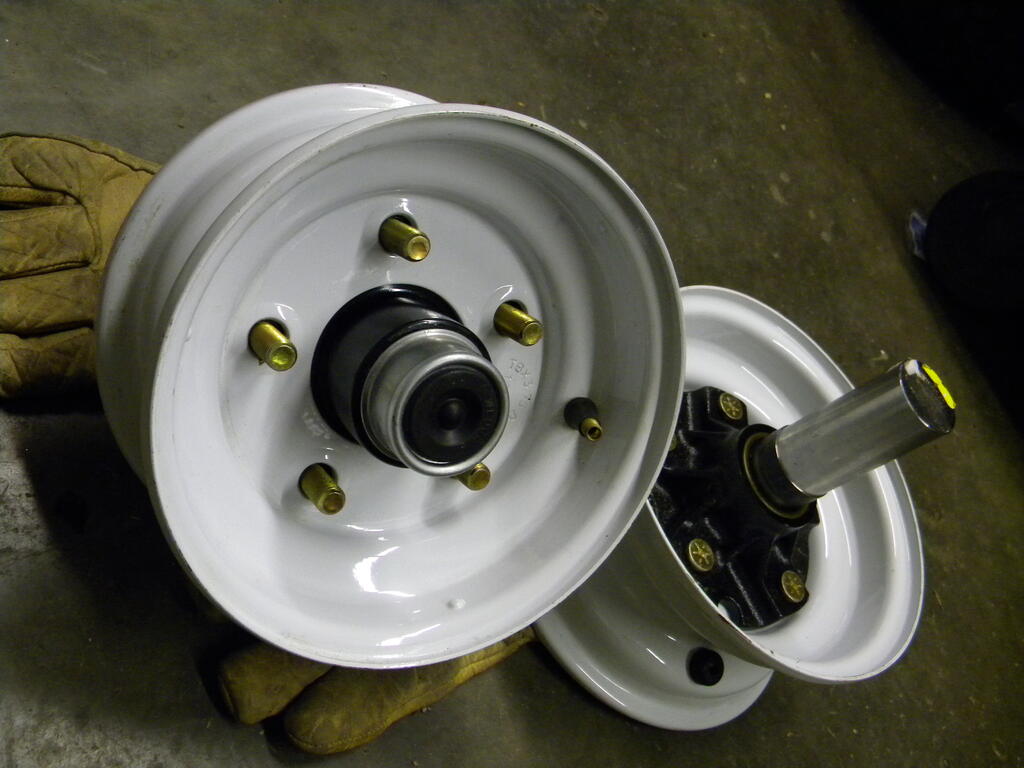

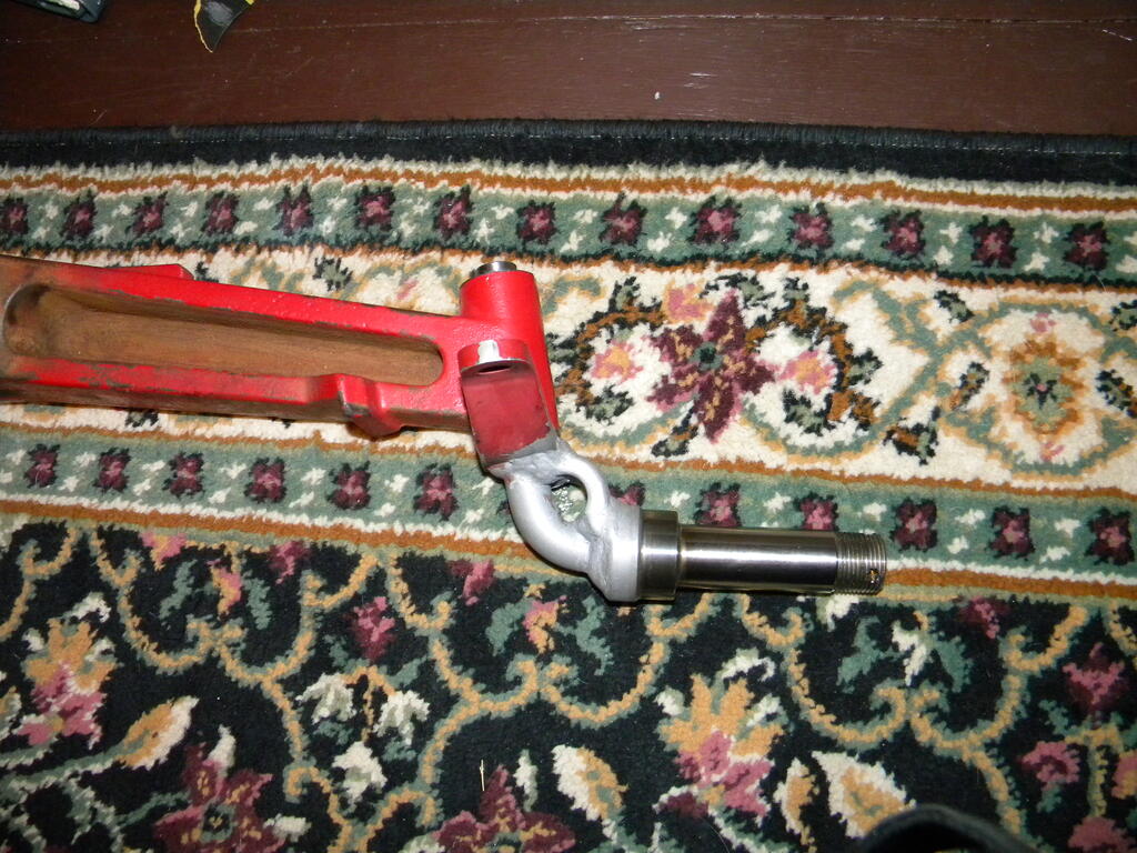

jeepdan 337 #2 Posted February 27, 2022 (edited) A few members have done this. That's how I got the idea. Just finishing these up. 1 1/16" "short hub" trailer spindles welded over a NOS pair of Wheel Horse 3/4" spindles. These are going to be used on a 312-8, sporting 8" wheels. Can't figure out yet, how to machine a seat on the steering arm plates, in order true them up to accept roller thrust bearings like on the 520's Edited February 27, 2022 by jeepdan 5 Share this post Link to post Share on other sites
oliver2-44 11,628 #3 Posted February 27, 2022 While what isavetractors is showing will get you a heavier hub and bearings it really doesn't add much/any strength to the actual spindle since it just slips on. If you added the welded brace in the "90" like JeepDan did since that is the true weak point and added the slip on for larger bearings that would be a good improvement. I really think if you did that brace on the "90" and went to needle bearings on you 3/4 spindles as @Snoopy11 and some have begun to use, it would be a reasonable good loader setup. PS I recently learned you can easily take a front axle from a J. Deere. 200,300 & maybe others that has factory 1" spindles, quickly paint it red, no one will know the difference. 6 1 Share this post Link to post Share on other sites

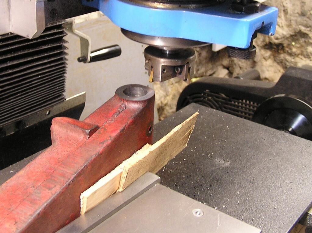

ri702bill 12,475 #7 Posted February 27, 2022 6 hours ago, jeepdan said: I was planning on counterboring the bottom area of the axle to make room for the thickness of the trust bearing and it's two washers like the 520 swept axle. My problem is that the plate steel steering arms aren't welded onto the kingpins an accurate 90 degrees which would prevent full contact with all or most of the thrust bearing needles. So, was Wheel Horse more careful with welding up the 520 spindles made for thrust bearings? Or, am I overthinking things? And that is why I use a thrust washer, not a roller bearing when I rework an axle for bushings. I fly cut material off the BOTTOM of the axle - this also ensures that the washer sits flat and perpendicular to the machined bore. No issues so far .... Bill 2 Share this post Link to post Share on other sites
wallfish 20,219 #9 Posted February 27, 2022 2 hours ago, ri702bill said: And that is why I use a thrust washer, not a roller bearing when I rework an axle for bushings. I fly cut material off the BOTTOM of the axle - this also ensures that the washer sits flat and perpendicular to the machined bore. Do you also find the steering arms not welded 90 deg to the kingpins? I was assuming those 2 surfaces would be true. If there's a smaller contact area between the steering arm and axle surfaces that would create a stiffer steering problem. Maybe that's why some people report their tractor steers hard while everything "appears" normal. 1 Share this post Link to post Share on other sites

Sailman 1,307 #11 Posted February 27, 2022 I was considering adding the 1 inch spindle over the 3/4 spindle, welding it to the L shaped spindle and then adding a triangle piece of steel or extra metal like @jeepdan did welded over the L shape to give it extra strength. Looks like it would be as strong as the OEM product that was sold with the wheel horse FEL. Sound right? 4 Share this post Link to post Share on other sites
wallfish 20,219 #12 Posted February 27, 2022 43 minutes ago, Sailman said: Sound right? Yes 1 1 Share this post Link to post Share on other sites

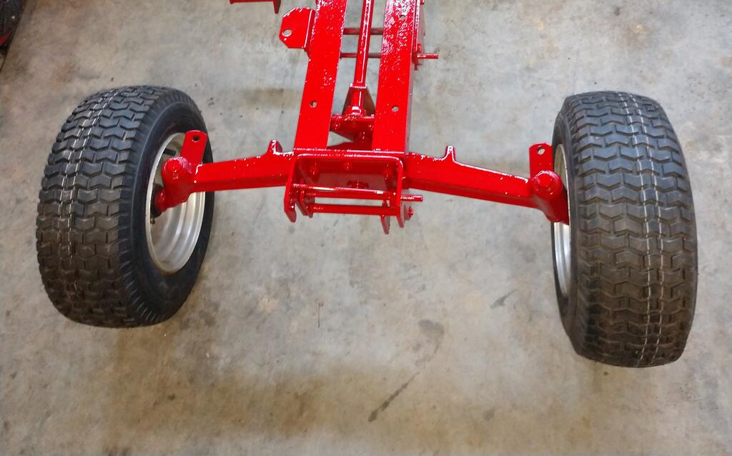

Lee1977 7,709 #13 Posted February 27, 2022 Here is what I did to reinforce some spindles on a 312 original for 6" wheels. No FEL I just raised the tractor a couple of inches. [/ur 3 1 Share this post Link to post Share on other sites
ri702bill 12,475 #14 Posted February 27, 2022 9 hours ago, wallfish said: Do you also find the steering arms not welded 90 deg to the kingpins? I was assuming those 2 surfaces would be true @wallfish Yes, indeed - for the most part they are as they say "Close, but no cigar!" I wish I had a lathe with a larger bed clearance so I could true up that surface on the spindle first or weld them up and recut them. It's on the wish list ..... Bill Share this post Link to post Share on other sites
wallfish 20,219 #15 Posted February 28, 2022 1 hour ago, ri702bill said: @wallfish Yes, indeed - for the most part they are as they say "Close, but no cigar!" I wish I had a lathe with a larger bed clearance so I could true up that surface on the spindle first or weld them up and recut them. It's on the wish list ..... Bill Hmm, Is there something besides a big lathe that can be used to true that up? Because I don't have one either. Or even know how to use my little one very well for much either. Like sliding mechanical tube down the kingpin with a way to sand or cut that arm surface flat with something on the end edge of the tube? A piece of a grinding disc glued to the end of the tube? Piece of lathe tooling welded to the tube? Spin the tube with a drill or ? and vice the spindle. Make a tool out of something Just throwing spit balls for any ideas. Having both sides true sure would be best. 1 Share this post Link to post Share on other sites

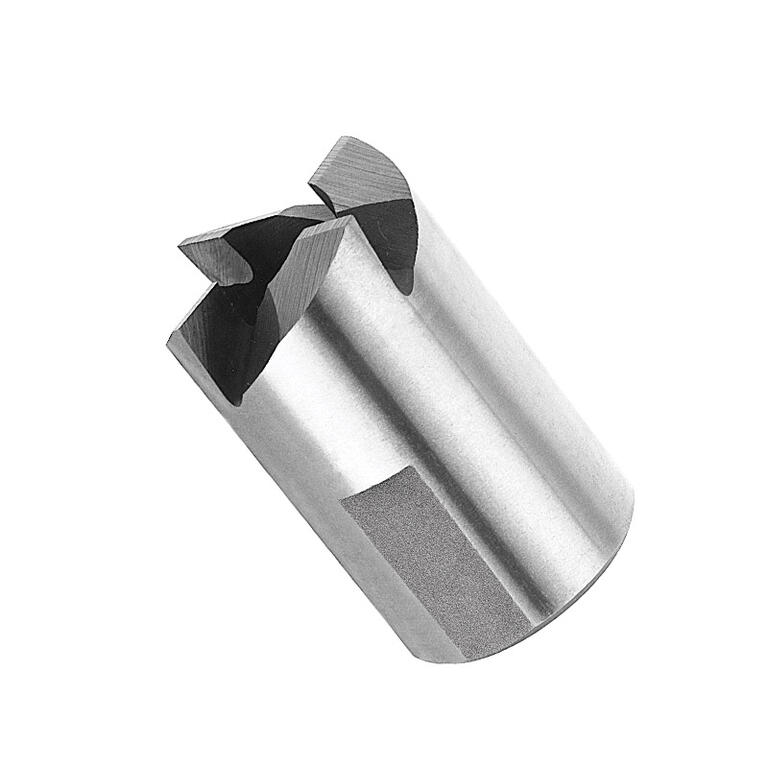

wallfish 20,219 #24 Posted March 2, 2022 Maybe this could work and it's not expensive? (if the 3/4 spindle fits into the 3/4 bore) https://www.msdiscounttool.com/catalog/product_info.php?cPath=4255&products_id=112529 Shouldn't be too difficult to come up with a way to spin it. Use it on both surfaces to counter sink a roller thrust bearing in there. Share this post Link to post Share on other sites
wallfish 20,219 #25 Posted March 5, 2022 I ordered the 3/4" x 1-1/2" HSS Hollow Mill and some roller thrust bearings. I'm thinking the bore needs to be ground out to fit on the spindles as .75 and .75 won't fit I'll figure out how to spin it once it arrives. Maybe I can chuck it up in my small lathe and hold the spindle with the milling attachment thingy New bushings in the axle plus a 3/4 rod and the axle surface can be done too We'll see how it goes Share this post Link to post Share on other sites
