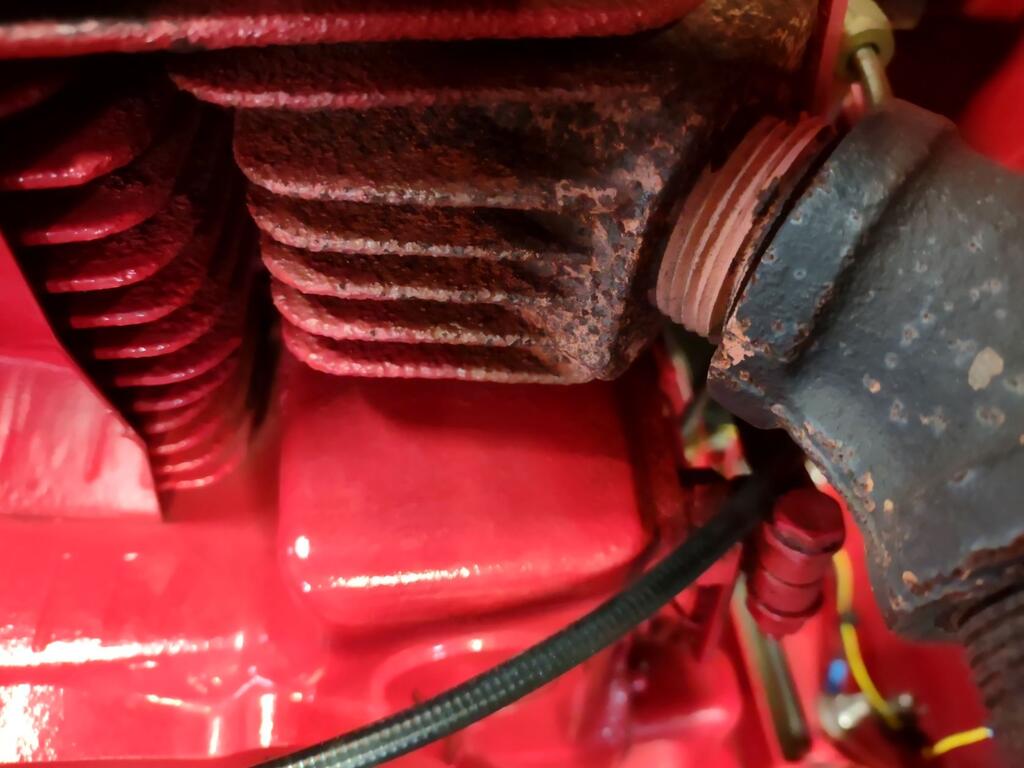

Achto 32,513 #5 Posted February 26, 2022 13 hours ago, 41chevy said: do I need high temp? You will get a few opinions on this subject. I'm just going to add what works for me. As stated above I don't paint the cylinder head, just sand blast it clean. For the block & cylinder I spray one coat of self etching primer and three coats of the same acryic enamel paint that I use on the sheet metal. After working the tractor the paint around the exhaust port will discolor and eventually burn off, but to me this is not a big issue. 1 Share this post Link to post Share on other sites
