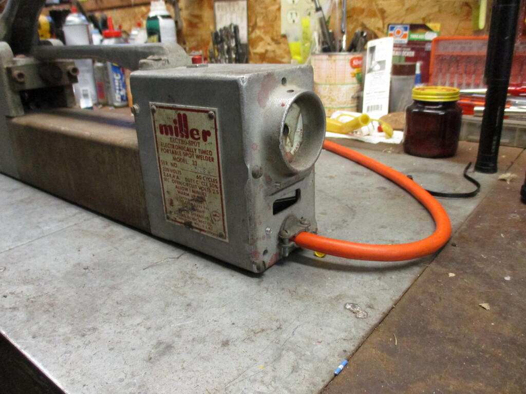

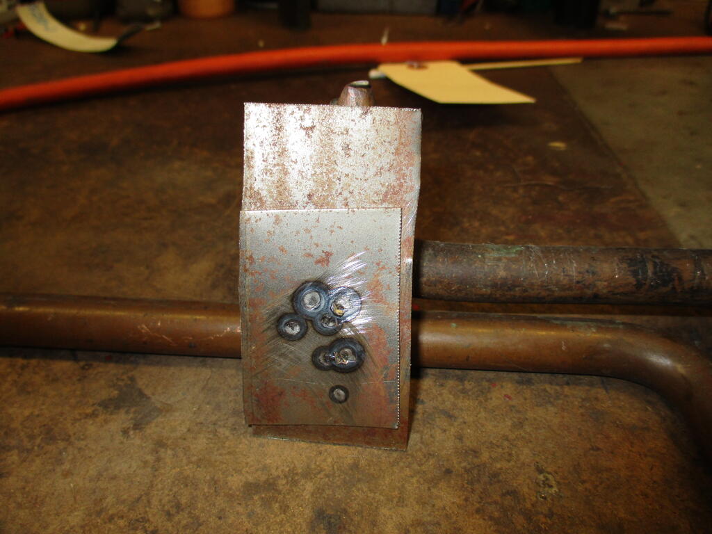

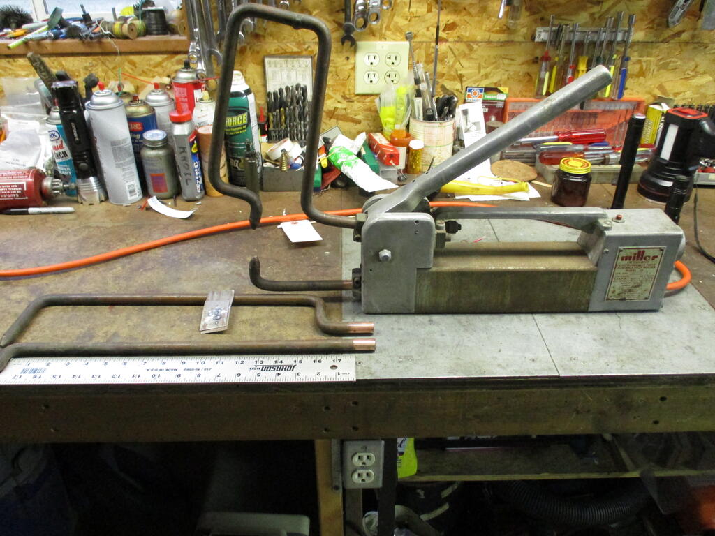

pfrederi 20,756 #1 Posted February 22, 2022 I have a Miller AC/DC Thunderbolt ($35 at auction didn't work well...was wired for 440 fixed that works fine). Bought a Miller 140 MIG welder. But I am not good at welding and welding thin sheet metal has not gone well at all. Picked up a massive Miller 33 Spot welder at auction for $15 (came with a Dayton 1HP electric motor that worked. The auction went 10 hours and these were at the end. I used Proxy Bid) Been sitting for a few months the power cord on the welder looked positively dangerous, so I never tried it. Found a manual on line and it became apparent that it had been modified. Originally it had a timer (dial in the rear) so you could replicate your weld more accurately than counting to yourself. it was missing couldn't find a replacement part...Not surprising since it used 4 Vacuum Tubes (anyone remember pulling them out of TVs and testing them on a big tester some where??) Guess this is old machine.... The timer was gone and there was big mercury solenoid installed. Worked on it for a bit and got the wiring replaced. Had it apart on the bench plugged it in and it tried to weld instantly. I had the solenoid lying down, turns out that when you tip a mercury solenoid beyond a certain point it triggers. Not a great idea for tool you might use at an angle. Picked up a 30amp solenoid for $10 probably won't last as long but I don't weld much and for $10... repair by replacement ...better that having it trigger unexpectedly . Got it together this afternoon did a couple test welds on sheet metal. (in one of the pics) Not bad. Have to get used to timing how long you depress the button. (Now I can work on the GT14 hood) The thing weighs a ton note the length of the straight welding arms that came with it.... 8 4 Share this post Link to post Share on other sites
