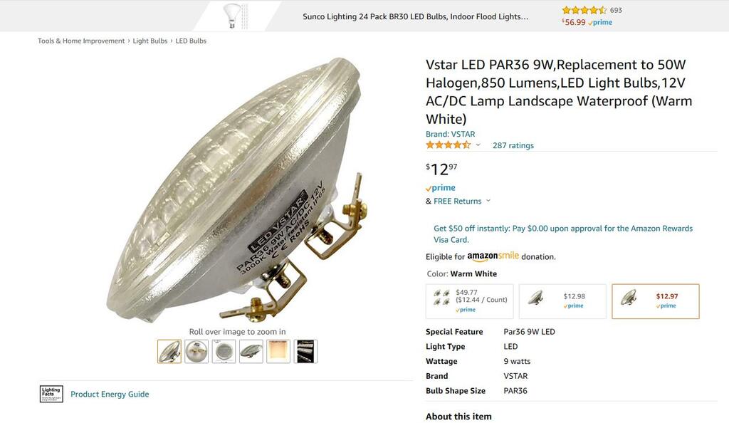

Mustang67ford 234 #8 Posted February 23, 2022 8 hours ago, 953 nut said: You could BUY some LED light bulbs and your charging system will be able to handle them. Possibly. Do you have a replacement lamp part number? Share this post Link to post Share on other sites
pfrederi 18,723 #9 Posted February 24, 2022 Lots to choose from.. an example Share this post Link to post Share on other sites
