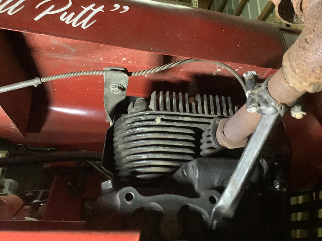

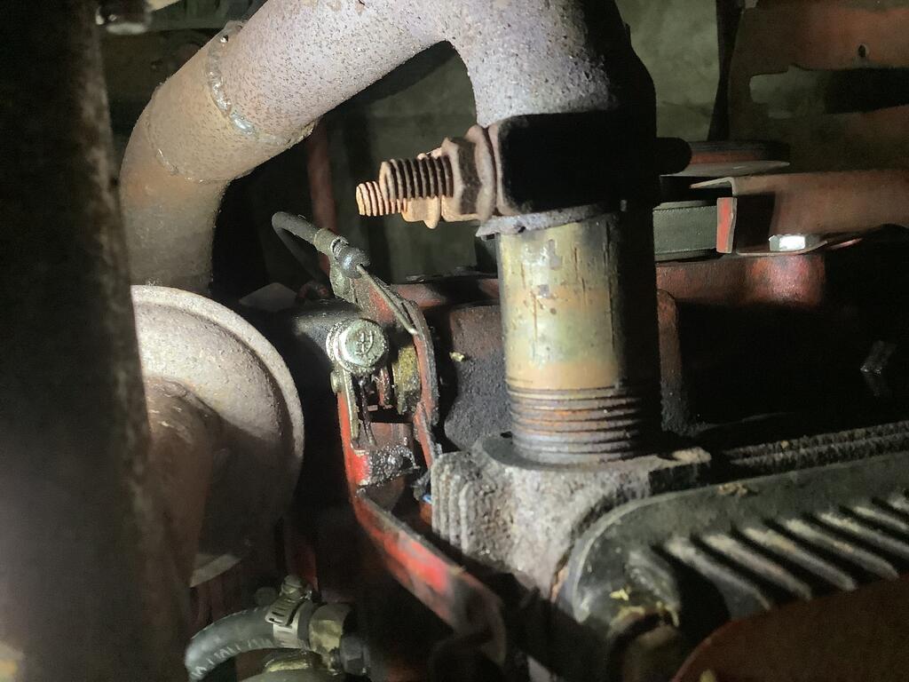

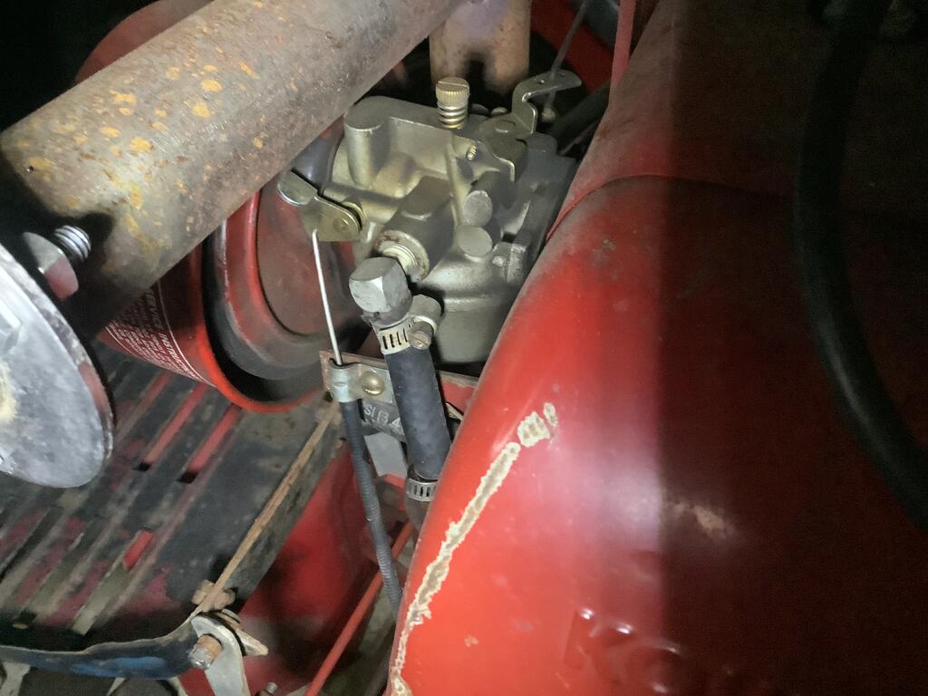

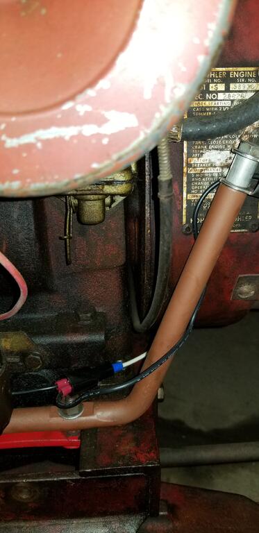

Pullstart 70,692 #4 Posted February 22, 2022 These are from my Kohler powered 502, so they should work. I can’t recall, but I may have added the twisted strap mount for the throttle, but it works great! Share this post Link to post Share on other sites

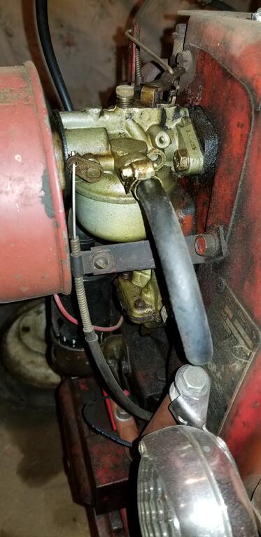

Pullstart 70,692 #5 Posted February 22, 2022 This is from another Kohler powered machine, a Commando 800. I see that the throttle cable isn’t actually installed on the little tab on the throttle plate near the governor but it routes under the engine. Share this post Link to post Share on other sites

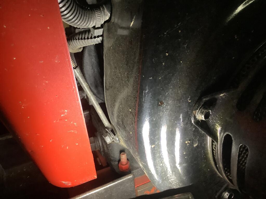

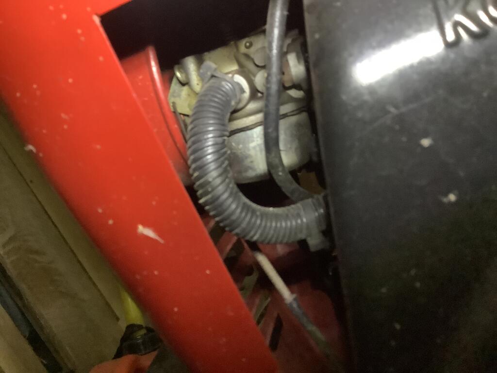

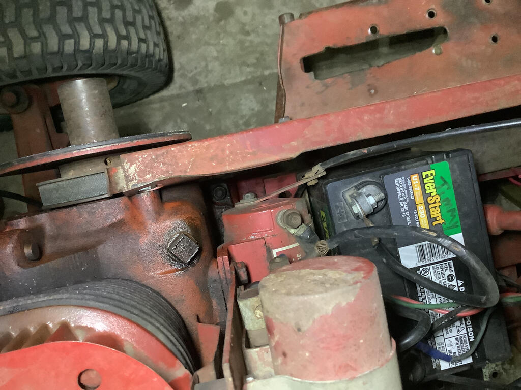

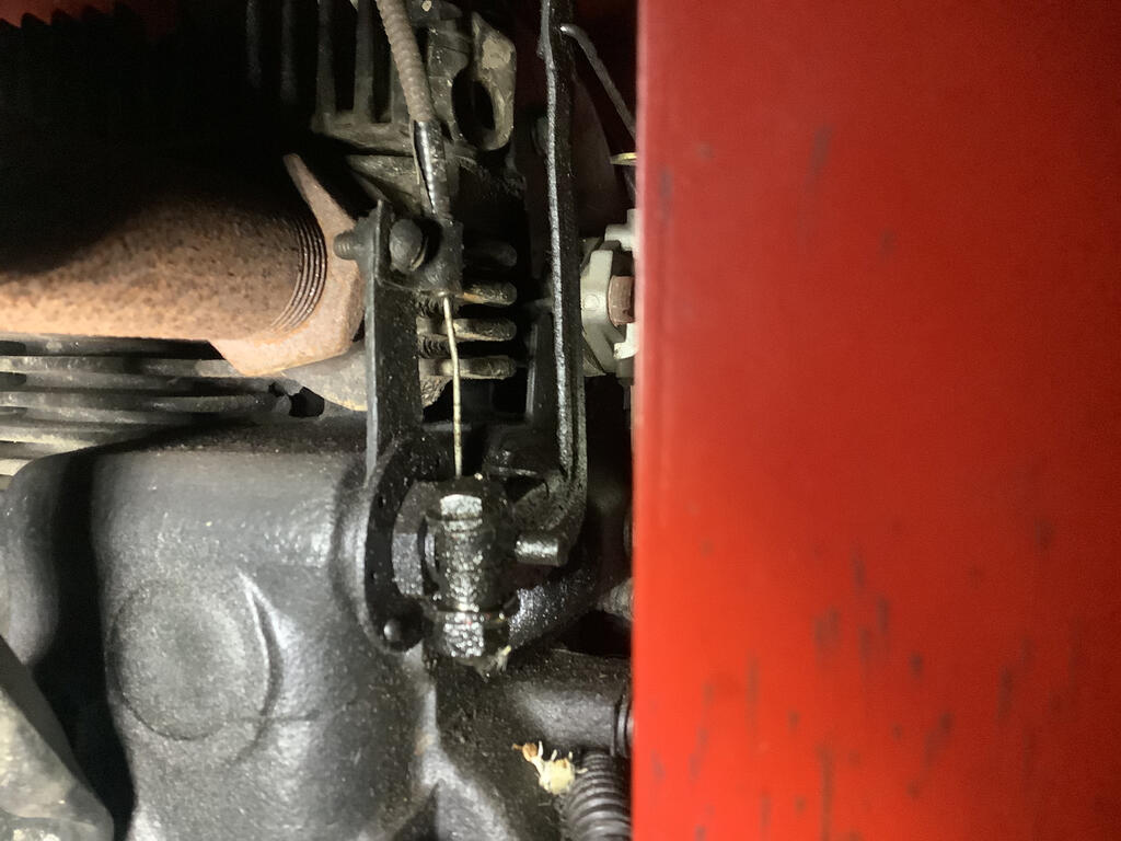

Mike'sHorseBarn 3,594 #6 Posted February 22, 2022 I'll grab you some pics of the cables on my 753 tonight. Share this post Link to post Share on other sites
Walleye Guy 24 #7 Posted February 22, 2022 That would be great, thank-you! 33 minutes ago, Mike'sHorseBarn said: I'll grab you some pics of the cables on my 753 tonight. Share this post Link to post Share on other sites

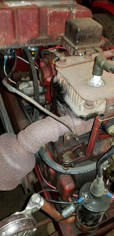

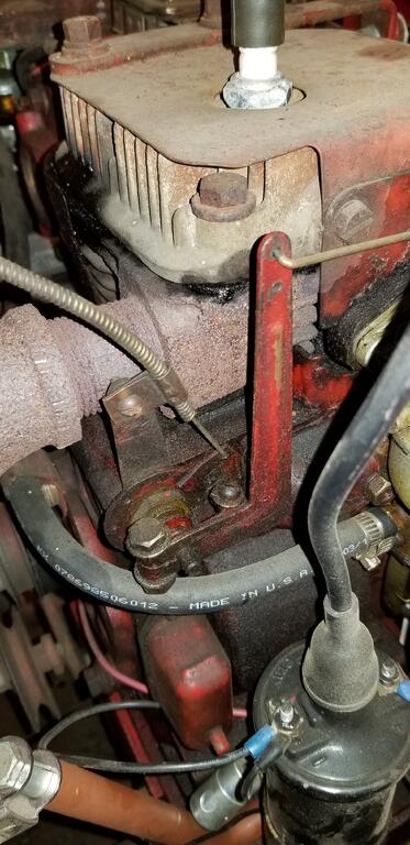

Mike'sHorseBarn 3,594 #8 Posted February 24, 2022 @Walleye Guy Share this post Link to post Share on other sites
Walleye Guy 24 #9 Posted February 24, 2022 Those pictures worked perfectly, thank-you. Dad has the throttle cable hooked up correctly now. He asked me to post two more questions so I'll try adding them here rather than starting a new post. 1. Choke cable: his appears to be broken near where it mounts so when pulling the handle the butterfly doesn't fully close. He wants to know if anyone has a spare choke cable for sale or if it's possible to purchas a new one. 2. Fuel pump: he wants to know if a fuel pump rebuild kit is available and also if it is just a diaphragm or if it has an actuating arm too. Thanks in advance! Share this post Link to post Share on other sites
