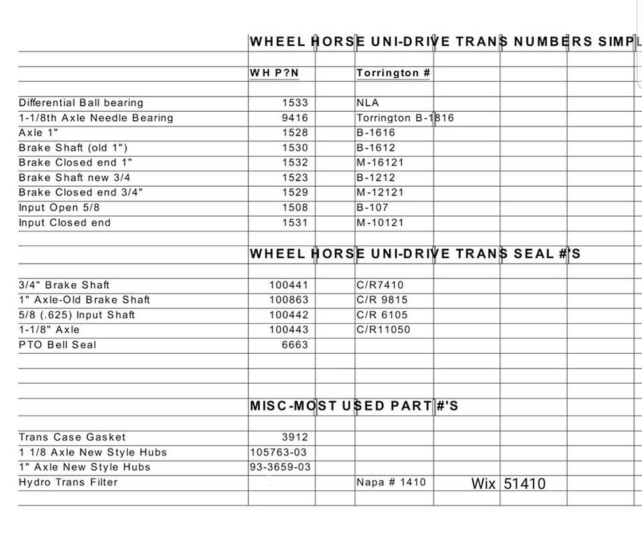

daveoman1966 3,884 #1 Posted February 22, 2022 Not sure where I got this chart but thought it will be helpful to members. 1 6 1 Share this post Link to post Share on other sites
Terry M-(Moderator) 2,309 #2 Posted February 22, 2022 Nice little reference guide 😊👍 Stevasaurus has some charts pinned in the transmission section also. Share this post Link to post Share on other sites
ol550 869 #3 Posted February 23, 2022 Need to change the 1533 bearing status. Share this post Link to post Share on other sites
daveoman1966 3,884 #4 Posted February 23, 2022 7 hours ago, ol550 said: Need to change the 1533 bearing status. What is the cross-reference for the 1533 Bearing?? Share this post Link to post Share on other sites
rmaynard 17,496 #5 Posted February 23, 2022 No cross for 1533, but Wheel Horse Parts & More has them new. https://wheelhorsepartsandmore.com/product/1533-bearing-1/ 1 Share this post Link to post Share on other sites
