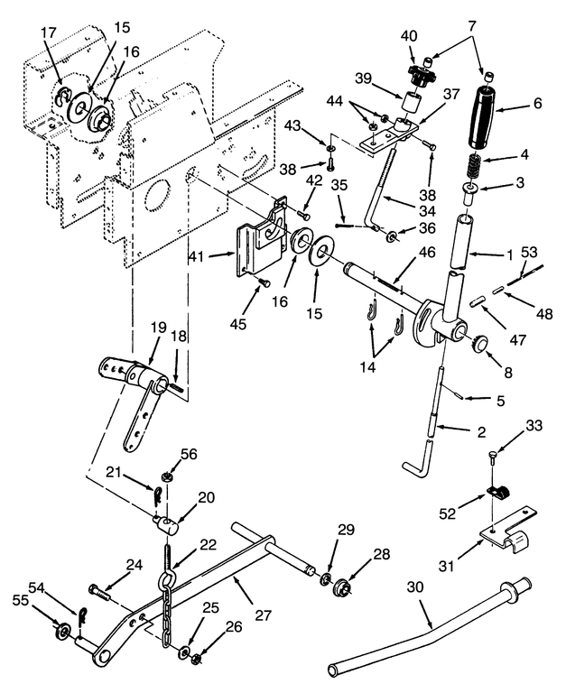

kpinnc 17,294 #6 Posted February 20, 2022 Most of the 300/400/500 series have a threaded drag link (#22 below) where the lift chain connects to the bellcrank. It can be adjusted fo a little extra lift. Or you can go up one link on the chain itself. Just be aware that you can go too far and that will make reaching the lift arm lock detent impossible to engage on manual lift. 1 Share this post Link to post Share on other sites

Horse Newbie 7,402 #9 Posted February 21, 2022 Oh yeah… if the deck goes up, bottoms out… then the long rod that goes down through the lift handle that you push with your thumb won’t engage the locking slot because the deck hitting the frame will stop the lift arm from swinging far enough back to lock… Share this post Link to post Share on other sites
kpinnc 17,294 #10 Posted February 21, 2022 29 minutes ago, Horse Newbie said: the lift handle that you push with your thumb won’t engage the locking slot because the deck hitting the frame will stop the lift arm from swinging far enough back to lock 2 Share this post Link to post Share on other sites
