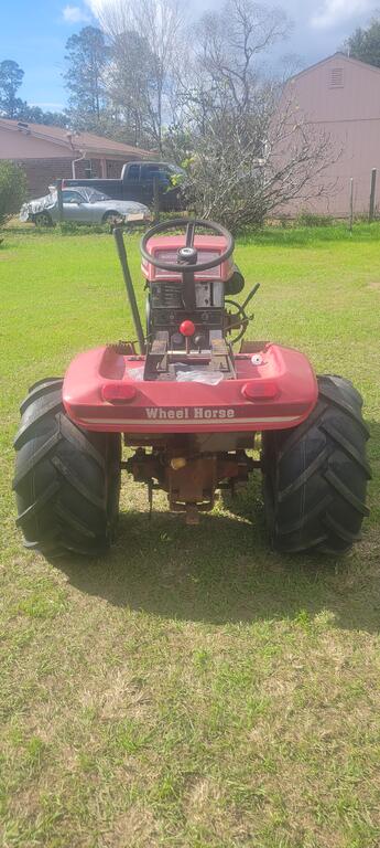

RED-Z06 2,720 #6 Posted February 20, 2022 24x12x12 fit on my stock rims, even said it was recommended for that rim size. I used a spacer for added stability also but it cleared the tank without Share this post Link to post Share on other sites
