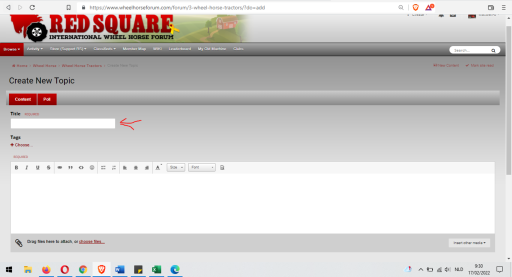

Maxwell-8 4,370 #5 Posted February 17, 2022 @83mercedes Just a tip, to help out the other members. When you want to create a new topic about in this case your 518H You better off type in the title '518H problems' (where the red arrow points too) instead of 83mercedes, because we can already see you created that topic. It's easier for us to see what the topic is about, and more people will tune in. 5 2 2 Share this post Link to post Share on other sites

cafoose 3,594 #10 Posted February 17, 2022 5 hours ago, Maxwell-8 said: @83mercedes Just a tip, to help out the other members. When you want to create a new topic about in this case your 518H You better off type in the title '518H problems' (where the red arrow points too) instead of 83mercedes, because we can already see you created that topic. It's easier for us to see what the topic is about, and more people will tune in. Maybe @nylyon can change the wording at the top where it says "Title" to say something like "Topic of post or discussion" or something similar. I've noticed this mistake has come up repeatedly especially by new members. Perhaps that would clarify things and reduce the likely hood of others making that same mistake in the future. 1 1 Share this post Link to post Share on other sites
