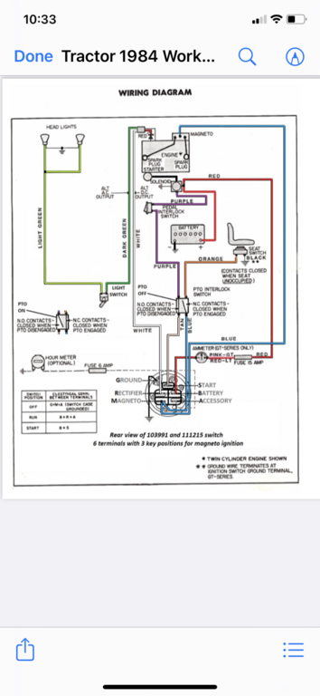

Horse Newbie 7,405 #1 Posted February 16, 2022 I am refreshing my 1984 Work Horse GT-1600. It does not have an hour meter and I would like to add one. I want to get a small one that sticks on the tractor dash with two sided tape. I plan to wire it like this diagram shows. Problem is I have not been able to find one, except for some that are “induction “ powered. Do any of you have any recommendations for a small 12 v one you have ? Share this post Link to post Share on other sites

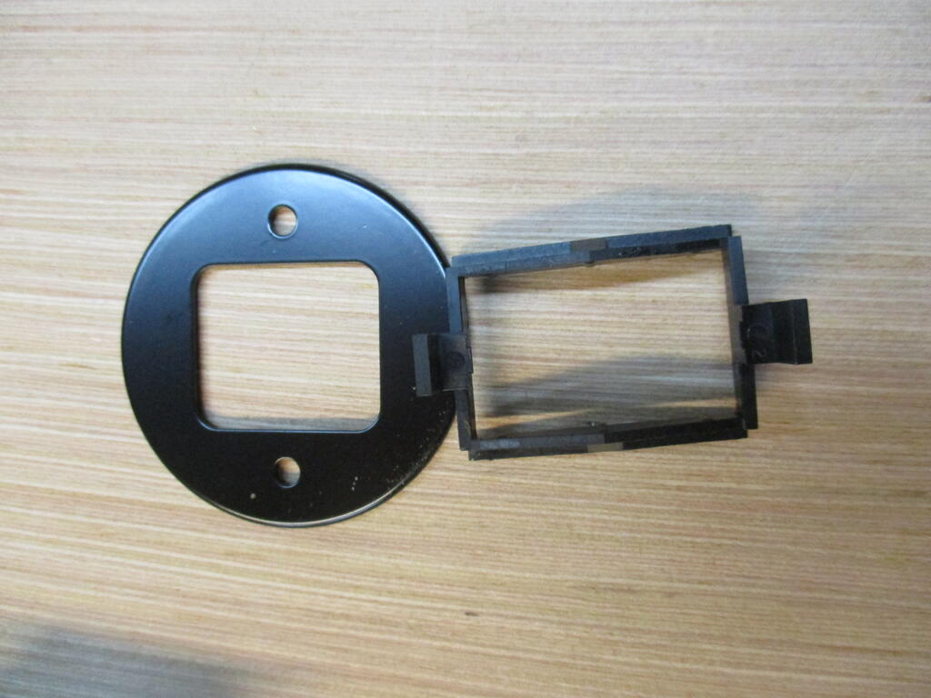

Jeff-C175 7,211 #13 Posted February 17, 2022 2 hours ago, Horse Newbie said: get past cutting a hole in the dash. Nice thing about the C-1X5 is that cutting a hole is easy-peasy. The metal back plate already has the hole, the plastic front plate has a ring around where the optional gauge would go. This is the 125 --- no meter yet. And the 175 - with 786 + hours on it!!! because of that stupid keyswitch! 2 Share this post Link to post Share on other sites

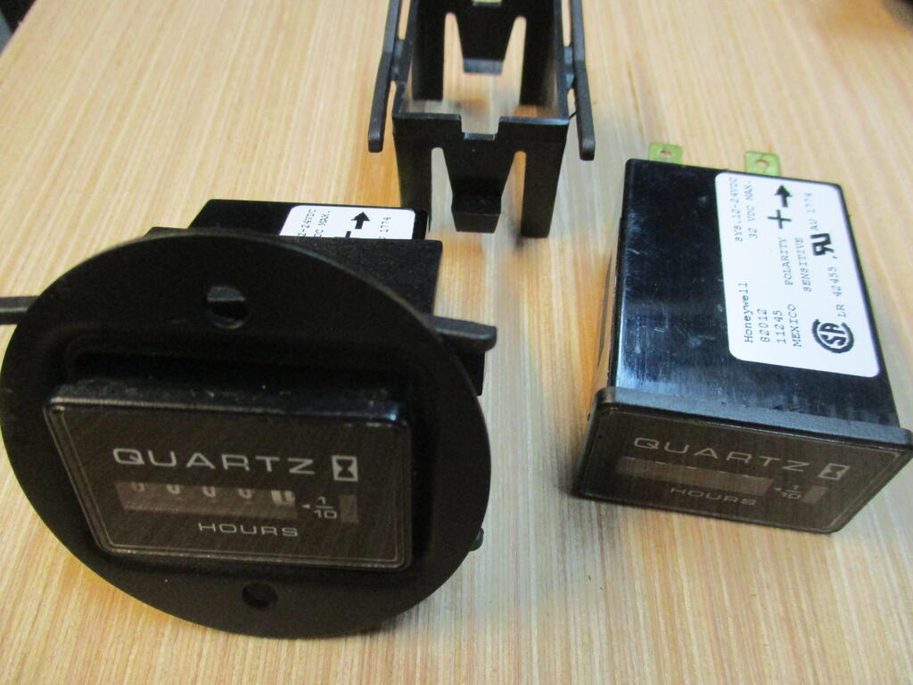

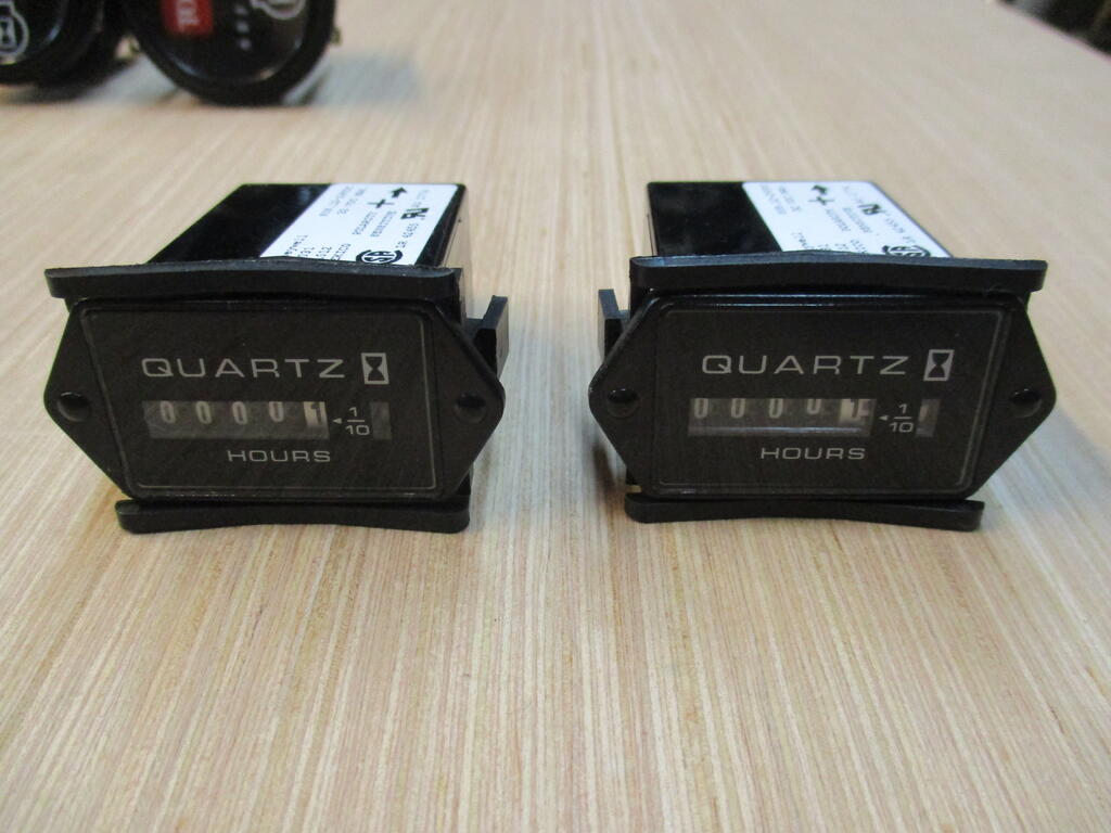

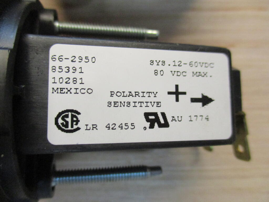

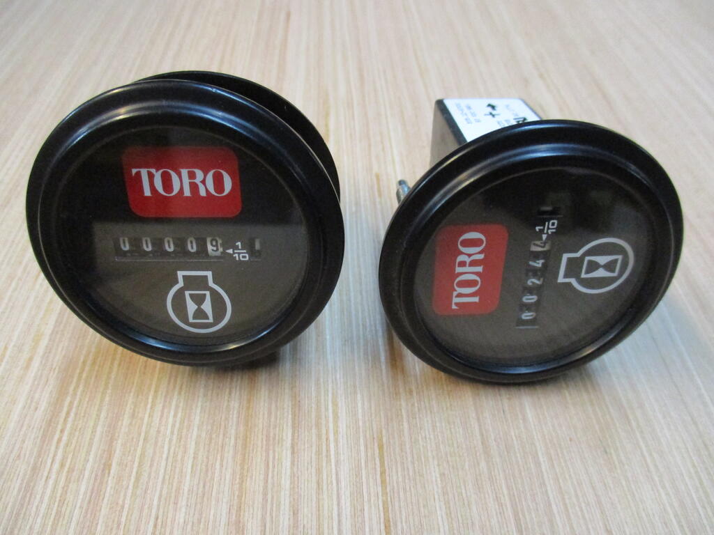

Kenneth R Cluley 705 #14 Posted February 17, 2022 I have a lot of those hour meters that a friend of mine gave me from removal from Toro lawn equipment. All have some time on them, most very minimal. Free for any member if you pay postage. Only a couple of the Toro, Lots of the others with two types of face plates, bezels, mounting housing. Some are straight blade out back, some are right angle. PM me. 2 1 1 Share this post Link to post Share on other sites
