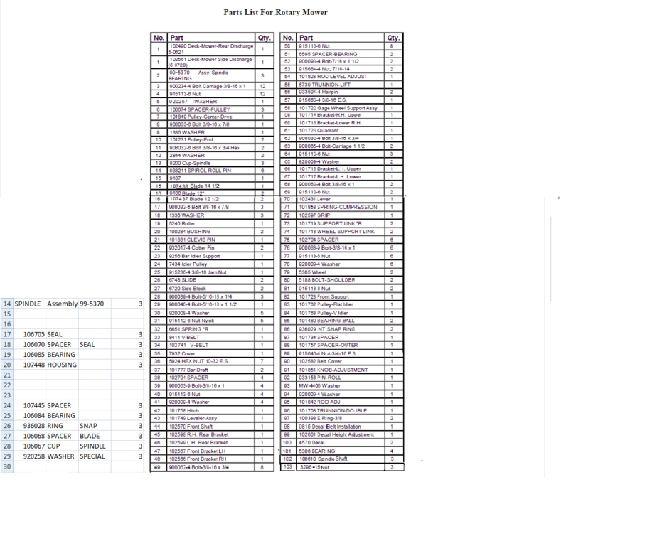

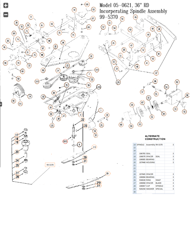

Wheelhorse#1 1,998 #2 Posted March 6, 2022 This is the one I have.The spindles are sealed,no grease fittings .I wonder if later model spindles with fittings would work .I had to buy three spindles,pretty expensive. 1 Share this post Link to post Share on other sites
"Manic-Mechanic" 1,486 #3 Posted March 7, 2022 (edited) 2 hours ago, Wheelhorse#1 said: This is the one I have.The spindles are sealed,no grease fittings .I wonder if later model spindles with fittings would work .I had to buy three spindles,pretty expensive. I used the 3/4" x 6" spindles with grease fittings. Enclosed is the model (05 0621) parts list combined with (5 0620) drawings. My modified drawing to show necessary parts involved to do the spindle build. (There is also a mod for this type of spindle where the nyloc nut on top is changed to free style thread held with a 3/4" lock washer and no woodruff key is needed) Yes, everything is expensive about these "horses" WH61-90 #429 Deleting Pulley Key on Greaseable spindles.pdf Edited March 7, 2022 by "Manic-Mechanic" 1 Share this post Link to post Share on other sites
Wheelhorse#1 1,998 #4 Posted March 7, 2022 Thank you very helpful. Share this post Link to post Share on other sites
