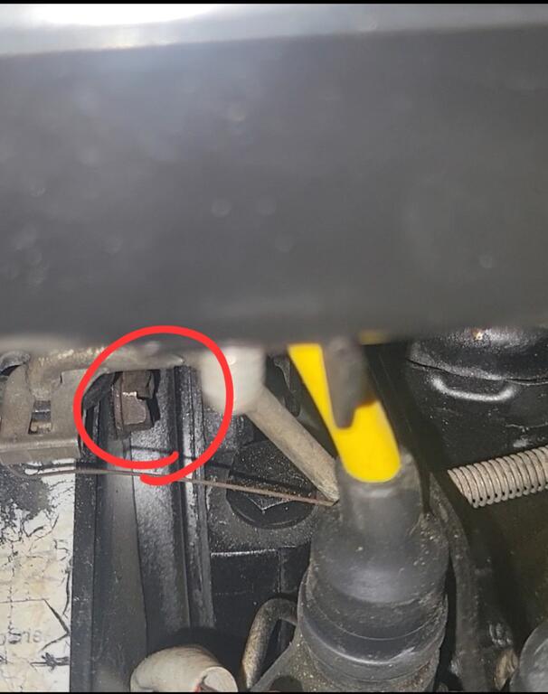

Handy Don 17,489 #26 Posted February 17, 2022 (edited) Or is it the one under the coil mount bracket? Be very careful NOT to drop that one when removing it (yep, experience). Edited February 17, 2022 by Handy Don 1 Share this post Link to post Share on other sites
RED-Z06 2,720 #28 Posted February 17, 2022 Theres 2 side panel screws, then 1 side panel screw, 2 lower screws, 2 screws under the coil...and one on the coil mount, one next to the governor on top then the one i circled behind the panel...then it kinda...twists up and off to clear the flywheel Share this post Link to post Share on other sites

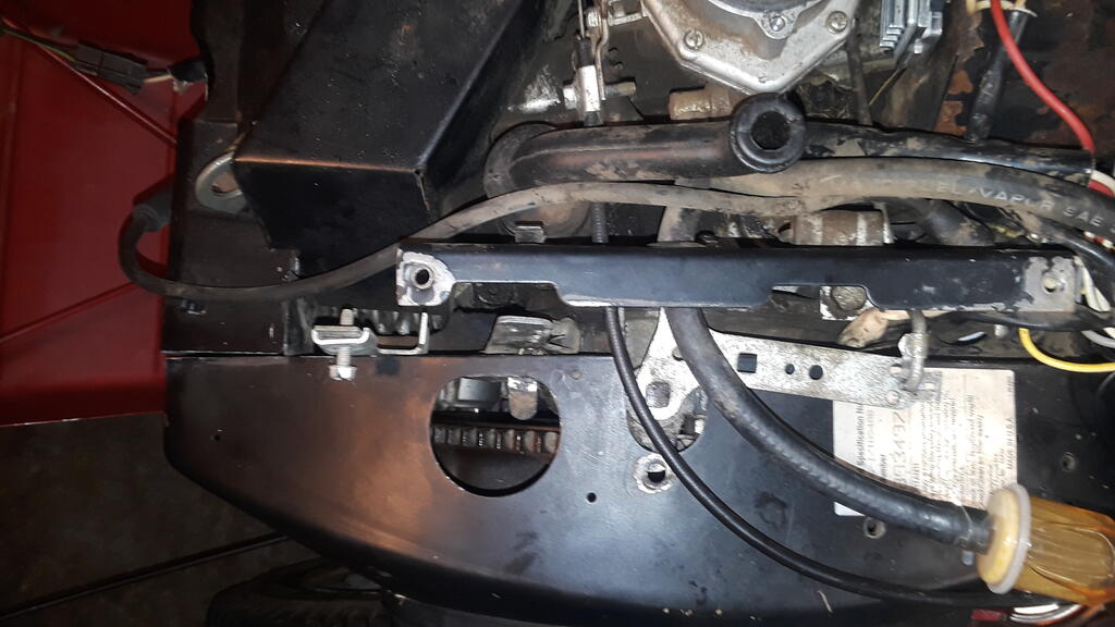

petermil12833 16 #29 Posted February 18, 2022 Thanks for the very explicit guidance -- but I'm still flustered. I'm not sure what I'm seeing in your photo, because it doesn't seem to look like what I see. I just spent another 40 minutes looking for that last screw, and I'm just not finding it. I have all the screws out except that last one. My wiring makes pictures difficult, but here are two pics of what I see. The entire front of the shroud is loose and can be pulled out an inch or so, but it's pivoting on something at the back that I can't see. There's one pic from the flywheel side and another from the muffler side. I'm done for today. Share this post Link to post Share on other sites
RED-Z06 2,720 #30 Posted February 18, 2022 You have to pull it out, tilt the bottom out, and kinda...rotate the shroud free...it goes down behind the flywheel area, doesn't pull straight off. Share this post Link to post Share on other sites

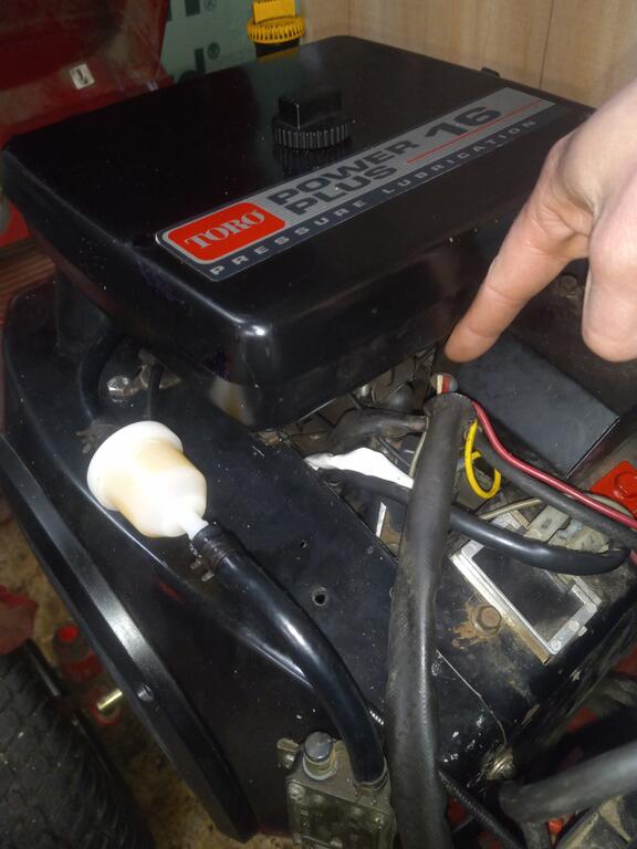

lynnmor 9,042 #31 Posted February 18, 2022 11 minutes ago, petermil12833 said: See that yellow wire in the left side of your photo? Your ignition coil is down there and it needs to come out. With that out of the way, you will see the source of your frustration. Share this post Link to post Share on other sites
petermil12833 16 #32 Posted February 18, 2022 I did take the coil bolts out, so I can move it around. I still don't see any screws coming from the opposite side. (Hmmm -- maybe this calls for my sawzall. lol) Tomorrow is supposed to be "warm" again, so I'll see if I can move all those wires away. Thanks again. Share this post Link to post Share on other sites
Handy Don 17,489 #33 Posted February 18, 2022 57 minutes ago, petermil12833 said: I did take the coil bolts out, so I can move it around. I still don't see any screws coming from the opposite side. (Hmmm -- maybe this calls for my sawzall. lol) Tomorrow is supposed to be "warm" again, so I'll see if I can move all those wires away. Thanks again. I wish you smooth pulling tomorrow. I'll admit my first Onan shroud removal was a trying event. 1 Share this post Link to post Share on other sites
lynnmor 9,042 #34 Posted February 18, 2022 1 hour ago, petermil12833 said: I did take the coil bolts out, so I can move it around. I still don't see any screws coming from the opposite side. (Hmmm -- maybe this calls for my sawzall. lol) Tomorrow is supposed to be "warm" again, so I'll see if I can move all those wires away. Thanks again. I think that I see the coil still in there, show the coil laying on the bench and the wires out of the way. Share this post Link to post Share on other sites
Cee245 861 #35 Posted February 18, 2022 (edited) @petermil12833 See if this helps. The big shroud on the 16/20 hp Onan's are the same. I'm pointing to the little bolt i think you are missing. It is approx 6" towards the middle of the motor from the end of my finger. Its a 3/8 bolt head and it holds a little bracket that is ATTACHED to the big shroud. That bracket holds the coil. As @lynnmorsays, remove the coil (2 -- 3/8 bolts) and its easier to get to. This particular bolt is in the VERTICAL position. The pic above with the red circle is confusing me as its indicating a horizontal positioned bolt. . Hope this helps Edited February 18, 2022 by Cee245 Add pic Share this post Link to post Share on other sites

petermil12833 16 #39 Posted February 23, 2022 We had a warm day today (high 40s) so I resumed my attack of the flywheel shroud. Yes, the remaining bolt WAS hidden by the coil, and with lots of yanking and cussing, I was able to remove the shroud. I made myself a promise -- when I reassemble this beast, I will NOT put that bolt back in. Now, to get that flywheel off ... tomorrow? Also met with the owner/mechanic at a local small engine shop, and he agreed that if it becomes too much for me, he'll finish the job. He said he might need my help sourcing parts, which could save some $$$. Have I mentioned that I am too old for this kind of project? Well it's true. To be continued . . . . 1 Share this post Link to post Share on other sites

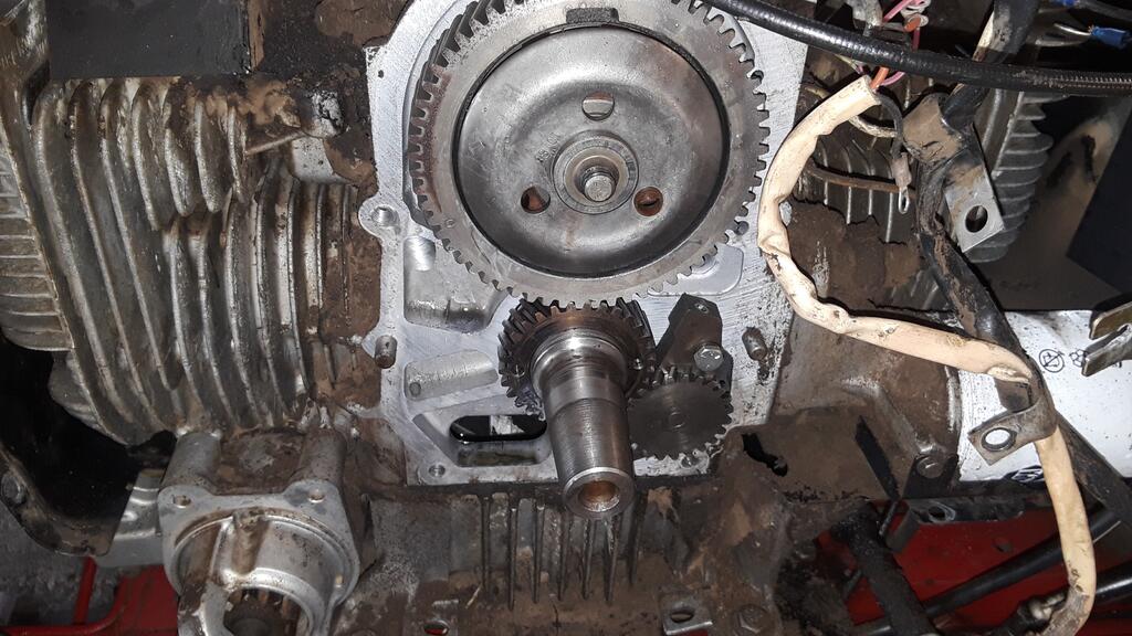

petermil12833 16 #49 Posted March 8, 2022 We had a 1-day warm spell on Sunday so I spent a couple more hours on the Onan P220G. Got the flywheel off and removed the timing cover. That's when I discovered that the seizure was not trivial. There's (big) debris in the oil sump; I could move it around with a screwdrriver, and you can see it in this pic -- illuminated by the flash. Probably the bottom end of a connecting rod. That forces a big decision: at this age (79) I'm not willing to do a rebuild myself, so I'll be negotiating with a local engine shop and exploring other options. In the meantime, my 314H continues its snowblowing duties, as needed. THANKS for all the help here! Wish me luck. 4 Share this post Link to post Share on other sites
RED-Z06 2,720 #50 Posted March 8, 2022 2 minutes ago, petermil12833 said: We had a 1-day warm spell on Sunday so I spent a couple more hours on the Onan P220G. Got the flywheel off and removed the timing cover. That's when I discovered that the seizure was not trivial. There's (big) debris in the oil sump; I could move it around with a screwdrriver, and you can see it in this pic -- illuminated by the flash. Probably the bottom end of a connecting rod. That forces a big decision: at this age (79) I'm not willing to do a rebuild myself, so I'll be negotiating with a local engine shop and exploring other options. In the meantime, my 314H continues its snowblowing duties, as needed. THANKS for all the help here! Wish me luck. Have them do the isavetractors.com steel governor spacer swap while they are there..will save the engine from another possible failure Share this post Link to post Share on other sites
