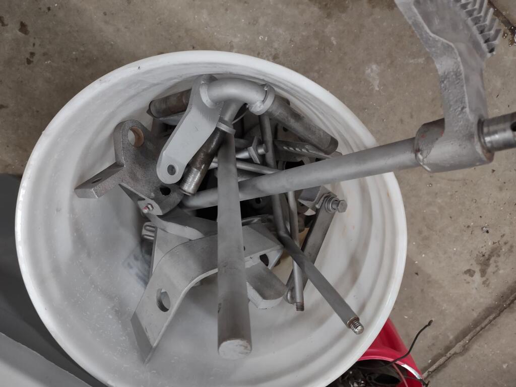

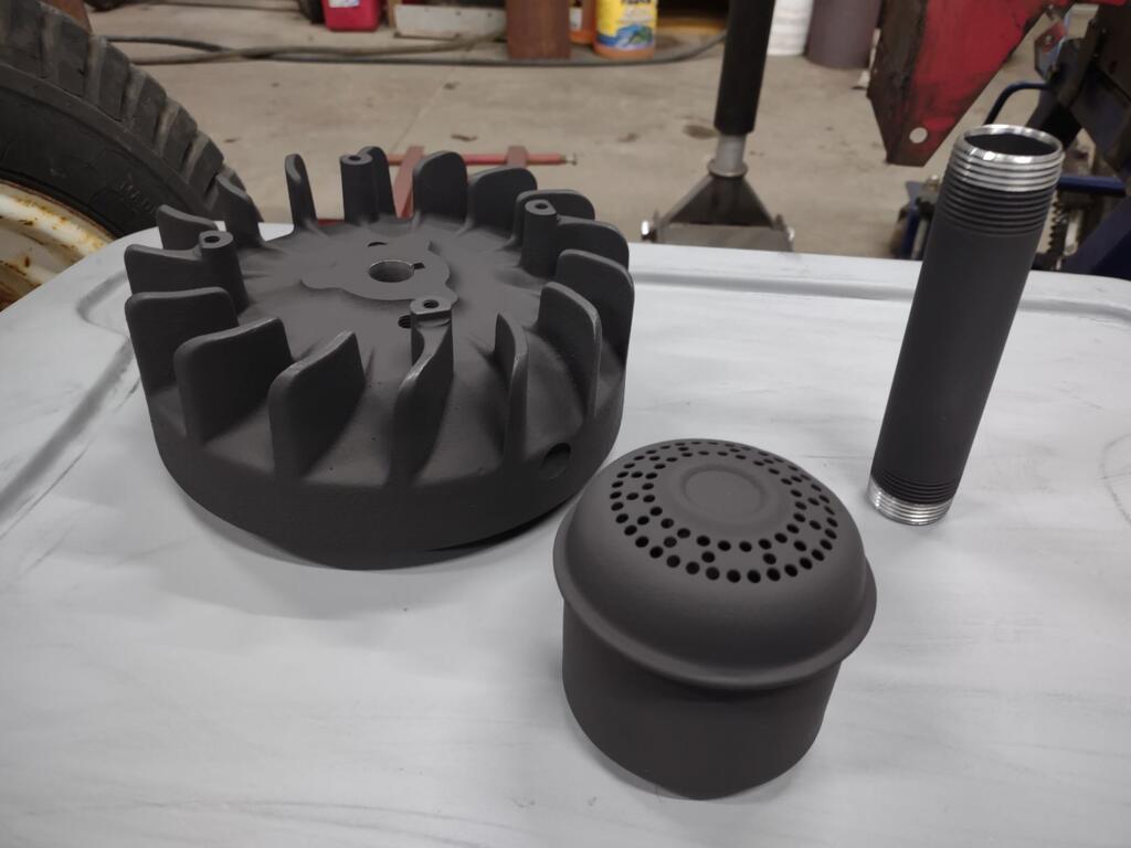

Achto 32,480 #78 Posted February 20, 2022 Spent some time in the shop today degreasing parts & then running them through the blast cabinet. Nothing real exciting to show, just a pail full of parts that are ready for paint. 4 9 Share this post Link to post Share on other sites
SylvanLakeWH 32,279 #79 Posted February 20, 2022 7 minutes ago, Achto said: Nothing real exciting to show, just a pail full of parts that are ready for paint. Progress... That's something to show! 2 1 1 Share this post Link to post Share on other sites

Snoopy11 5,731 #91 Posted February 21, 2022 Pardone by busy-body-ness... But whatz in the bucket? Don 2 Share this post Link to post Share on other sites

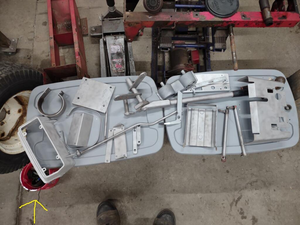

Achto 32,480 #94 Posted February 21, 2022 10 hours ago, Snoopy11 said: But whatz in the bucket? All of the chassis and body hardware. One gray tote has all of the engine parts, the other gray tote has the tranny parts. 3 Share this post Link to post Share on other sites

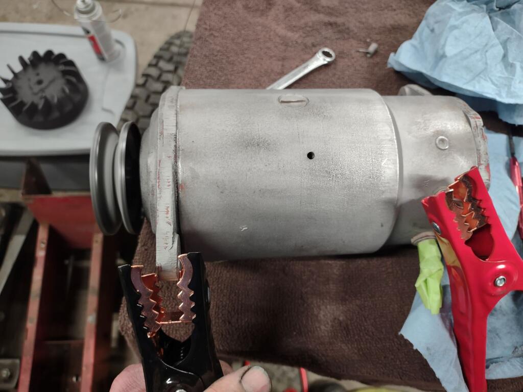

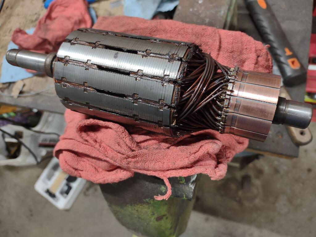

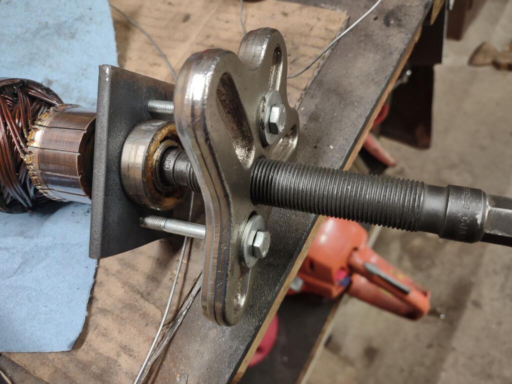

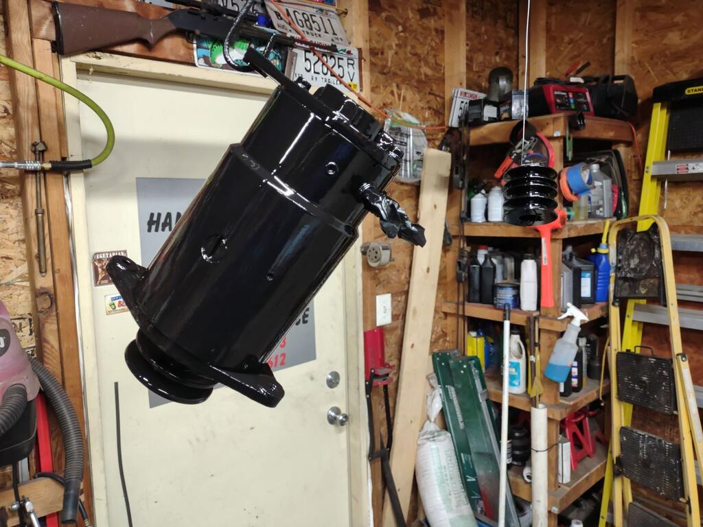

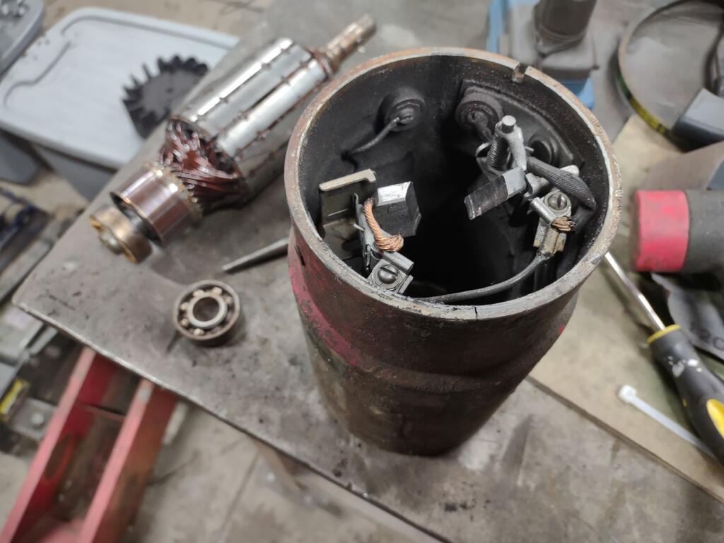

Achto 32,480 #95 Posted February 23, 2022 A little progress report. The crank shaft is out to the machinist to get turned down to .010" under size on the crank pin. I have just about every thing that will fit in the blast cabinet done. With all these nice clean parts I just had to spray a little paint. The starter/gen was pretty noisy so that got opened up for a rebuild. The bearing on the rear of the gen was stuck on the shaft. I don't have a fancy bearing puller so I cut a 3/4" slot in a chunk of iron and tapped a coupled of holes to make my own puller. The commutator was in pretty good shape so it only required a quick clean up with Scotchbrite. Cleaned the grooves out & polished up the shafts. Rotor ready to go. Put it all back together, hooked up some power & gave a test spin. Test turned out good, time to shoot a little paint. This part is done. 14 Share this post Link to post Share on other sites

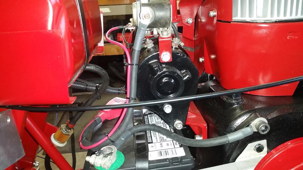

WHX?? 57,904 #96 Posted February 23, 2022 (edited) What is it with you and black S/Gs ..... starting to rub off...... and why is it your at pumpkin farmers .. your garage impassable or just warmer over ther???? Edited February 23, 2022 by WHX?? 2 6 1 Share this post Link to post Share on other sites
Achto 32,480 #97 Posted February 23, 2022 8 minutes ago, WHX?? said: What is it with you and black S/Gs IDK, I just prefer them black. Beaks things up a little bit. Figure that it was good enough for Delco Remy, it's good enough for me. 3 4 Share this post Link to post Share on other sites
kpinnc 18,916 #98 Posted February 23, 2022 3 hours ago, WHX?? said: What is it with you and black S/Gs ..... starting to rub off...... and why is it your at pumpkin farmers .. your garage impassable or just warmer over ther???? That picture just depressed the crap out of me... I'm not posting any more pics. Dang that is pretty! 2 5 Share this post Link to post Share on other sites
