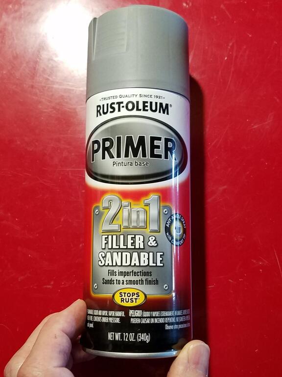

Brockport Bill 2,498 #9 Posted February 11, 2022 3 minutes ago, Achto said: One other tip that I can offer is to spray a guide coat on the part before you sand. A guide coat would be a contrasting color to the part. (red part use gray paint or primer) Cheap spray cans work good for this. Mist a very light coat of paint on the part before you sand. When you're sanding you will sand until the guide coat is gone. This helps to ensure that you have sanded everything. good info........... that really helps - they make a spray gray primer that has the word "filler" in its title - since i have some scratches and i will be sanding as you suggested - should i use the Filler primer rather than regular primer? 1 Share this post Link to post Share on other sites
Achto 32,891 #10 Posted February 11, 2022 (edited) The filler primer will work good for minor imperfections. Make sure you sand the surface with 180 to 220grit before priming. Edited February 11, 2022 by Achto Share this post Link to post Share on other sites
sjoemie himself 3,264 #11 Posted February 11, 2022 Also could be useful to use a special plastic primer. Some plastics can be a little oily even after degreasing, and most plastics are a little flexible, the plastic primer should help on both fronts. Share this post Link to post Share on other sites
