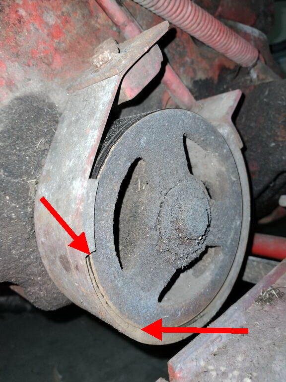

TJ5208 1,841 #26 Posted February 10, 2022 I press in on the clutch and then try to hit the brakes and it don't stop it just keeps rolling. 1 Share this post Link to post Share on other sites
rmaynard 17,107 #27 Posted February 10, 2022 You appear to be missing part of the pad between the arrows. 5 Share this post Link to post Share on other sites

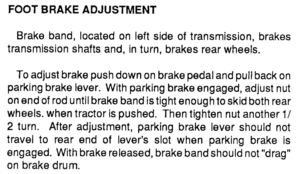

lynnmor 8,748 #28 Posted February 10, 2022 1 hour ago, TJ Salyers said: Yessir tighten it till it skids then tighten it 1/2 turn. But still won't stop. Is this the instructions you followed? 3 Share this post Link to post Share on other sites
oldlineman 1,678 #29 Posted February 10, 2022 Your brake lining is wore down to the metal on the front side of the band. Can see clearly in the pictures PM rmaynard and get a new lining, that will fix it. Bob 5 Share this post Link to post Share on other sites
TJ5208 1,841 #30 Posted February 10, 2022 3 hours ago, lynnmor said: Is this the instructions you followed? Yes sir 1 Share this post Link to post Share on other sites
roadapples 6,987 #31 Posted February 10, 2022 Brake lining is probably original. May be oil soaked. You need a new one.... 3 Share this post Link to post Share on other sites
WHX?? 56,157 #32 Posted February 10, 2022 TJ While yer in there take the brake hub off and clean it and the immediate area. Mineral spirits on a rag work good. 4 Share this post Link to post Share on other sites
