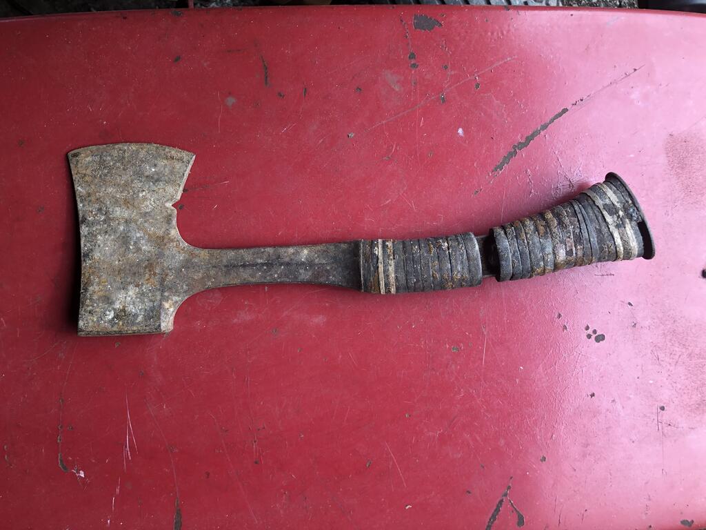

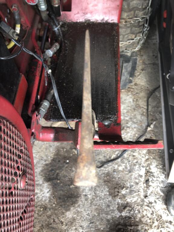

EB-80/8inPA 1,957 #30 Posted February 12, 2022 Here’s a small (camp?) hatchet in the condition I found it. I think this would be a good candidate for reconditioning using the minimum amount of replacement material, cleaned and smoothed/honed/oiled. Notice the banding gets wedged near the bottom to make the curve. I wonder if some glue would have been used there? 12.25” largest dimension. I assume it’s an Estwing but see no markings. Thoughts? Is this anything special? It’s kinda cute. 2 Share this post Link to post Share on other sites
ebinmaine 76,779 #31 Posted February 12, 2022 29 minutes ago, EB-80/8inPA said: . Thoughts? . Extra credit should be given for staging the pics on a Wheelhorse. 2 1 1 Share this post Link to post Share on other sites
EB-80/8inPA 1,957 #32 Posted February 12, 2022 1 minute ago, ebinmaine said: Extra credit should be given for staging the pics on a Wheelhorse. I happened to have one handy. 2 Share this post Link to post Share on other sites
SylvanLakeWH 30,303 #33 Posted February 12, 2022 Extra extra credit would have been given if it was on a black hood… Cool hatchet! Maybe a leather shoe lace wrap could work without taking it apart…? Share this post Link to post Share on other sites
EB-80/8inPA 1,957 #34 Posted February 12, 2022 2 minutes ago, SylvanLakeWH said: Maybe a leather shoe lace wrap could work without taking it apart…? Yes, I don’t think it can be taken apart without altering the handle, unless the rivets can be re-lengthened after cutting the ends off. Perhaps it doesn’t matter as it’s probably not that valuable. IDK. I do like your idea though; that would stabilize and render it functional with a minimal investment of time, then think about playing with it when I’ve got nothing better to do. I have some thick leather I could probably cram in there and glue as a temporary fix as well. I have no black hoods laying around though, lol. Thanks. 1 1 Share this post Link to post Share on other sites
formariz 12,354 #35 Posted February 13, 2022 22 hours ago, EB-80/8inPA said: I assume it’s an Estwing but see no markings. Thoughts? Is this anything special? Yes it is an Estwing Hatchet. Good tool. Clean it and sharpen it it will be usef 21 hours ago, SylvanLakeWH said: Maybe a leather shoe lace wrap could work without taking it apart…? That is correct. Just wrap leather shoe lace tightly around empty area.Feather the end of it and use Crazy Glue to hold end. Clean and condition the leather on handle and tighten rivets a bit. 1 1 Share this post Link to post Share on other sites
