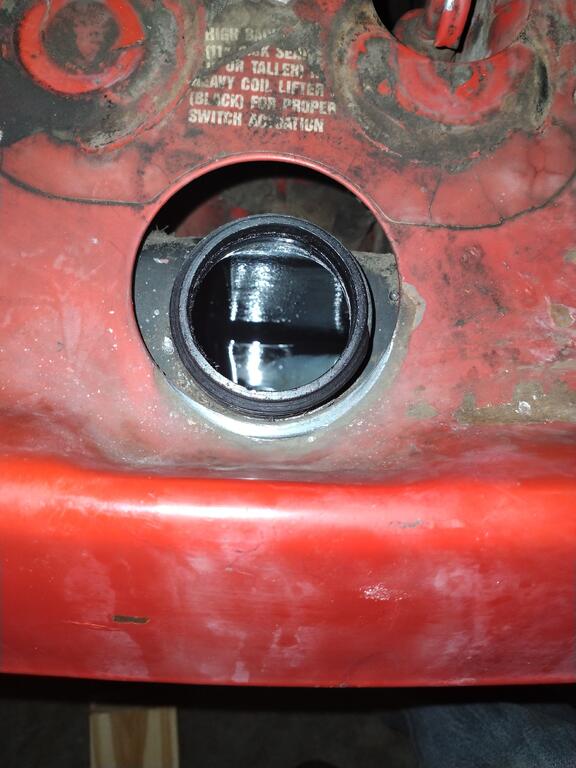

Snoopy11 5,731 #157 Posted February 9, 2022 Just now, ebinmaine said: This here Maine Bear 🐻 does NOT feel that's in his best interest. I figured as much... 1 minute ago, TJ Salyers said: How am I supposed to get my hand or that in the tank. Through... the... fuel... cap... filler... hole... How big is the hole where you put fuel in? Don Share this post Link to post Share on other sites
RED-Z06 2,720 #158 Posted February 9, 2022 12 minutes ago, TJ Salyers said: Why'd you leave it sitting outside again. Previous owner parked it about 16 years before i got it, tires were rotted off, wheels partly rusted away, deck was about 40% dissolved...engine stuck, nothing at all moved or worked 1 Share this post Link to post Share on other sites
TJ5208 1,841 #159 Posted February 9, 2022 2 minutes ago, Snoopy11 said: I figured as much... Through... the... fuel... cap... filler... hole... How big is the hole where you put fuel in? Don Share this post Link to post Share on other sites

Snoopy11 5,731 #161 Posted February 9, 2022 Just now, TJ Salyers said: Oh... well... that speaks for itself. IN DAT CASE... you would need... something like this... Don 2 Share this post Link to post Share on other sites
