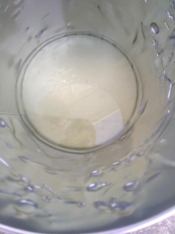

lynnmor 8,839 #126 Posted February 8, 2022 (edited) Visit my post #116 again. You will be surprised how much more junk will come out when the tank is off and rinsed properly. Ethanol free is best but any fresh regular gas will be fine if it is consumed in a month or two. Again, only fresh gas in the tank, nothing else. Edited February 8, 2022 by lynnmor 3 Share this post Link to post Share on other sites

Snoopy11 5,731 #128 Posted February 8, 2022 2 hours ago, Jeff-C175 said: TJ, that tractor can't run on mayonnaise! Seriously, what the heck is that stuff, and how did it get into your fuel system? Yah-man... that fuel looks worse than my recent project that sat around for 10 years without running. Don 1 Share this post Link to post Share on other sites
TJ5208 1,841 #129 Posted February 8, 2022 (edited) Well it's all settled down. May I also add when I was draining the fuel tank out I used a gallon jug and the other one started overflowing and I grabbed another jug that had a teeny bit of milk in it but I don't think it would cause it to be that cloudy but it does look like the gas has gelled up in the bottom of it. Edited February 8, 2022 by TJ Salyers 1 Share this post Link to post Share on other sites
Jeff-C175 7,209 #130 Posted February 8, 2022 1 minute ago, TJ Salyers said: had a teeny bit of milk in it So you made a gasoline milk shake? How'd it taste? Looks like you made some "Elmer's Glue" to me. 1 4 Share this post Link to post Share on other sites

Snoopy11 5,731 #138 Posted February 9, 2022 In my experience though... TJ... you need to take the fuel tank off and actually clean it... Maybe I missed something? Don 1 Share this post Link to post Share on other sites
TJ5208 1,841 #139 Posted February 9, 2022 Just now, Snoopy11 said: In my experience though... TJ... you need to take the fuel tank off and actually clean it... Maybe I missed something? Don So how would you clean it out. Share this post Link to post Share on other sites
Snoopy11 5,731 #140 Posted February 9, 2022 (edited) 3 minutes ago, TJ Salyers said: So how would you clean it out. What I do with mine... is take them off... rinse them out with a water hose... (or your mom's kitchen sink if you want ) Then, sit it out in the sun and let it dry. You can also blow it out with an air compressor or backpack blower... something like that. I just don't think you will be able to get all the gunk out of the tank without physically cleaning it out. Just my opinion, of course. Don Edited February 9, 2022 by Snoopy11 1 Share this post Link to post Share on other sites
TJ5208 1,841 #141 Posted February 9, 2022 Just now, Snoopy11 said: What I do with mine... is take them off... rinse them out with a water hose... (or your mom's sink if you want ) Then, sit it out in the sun and let it dry. You can also blow it out with an air compressor or backpack blower... something like that. I just don't think you will be able to get all the gunk out of the tank without physically cleaning it out. Don Ok thanks. 2 Share this post Link to post Share on other sites
TJ5208 1,841 #142 Posted February 9, 2022 Just now, Snoopy11 said: What I do with mine... is take them off... rinse them out with a water hose... (or your mom's sink if you want ) I'd be dead. 3 Share this post Link to post Share on other sites

RED-Z06 2,718 #145 Posted February 9, 2022 1 minute ago, TJ Salyers said: So how would you clean it out. My 312-8 sat with a busted cap for at least a decade, i pulled it out the frame, dumped it, put in some degreaser (like purple power) then stuck the power washer in it, that agitating action broke alot loose..then let it hang upside down. I take an open air fitting and put it on my air line and snake it in...helps blow stuff out. Then a couple hours in the sun to fully dry. She was spotless inside. 4 Share this post Link to post Share on other sites

wallfish 20,031 #148 Posted February 9, 2022 (edited) Drop or 2 of dish soap, hand full or 2 of sheet rock screws (nuts and bolts if you prefer but the sharp edges of the screws really scrap the crap off good) Fill with water and shake the crap outta of it. Rinse and repeat as necessary. Make sure it's ALL dry before using. Edited February 9, 2022 by wallfish 2 Share this post Link to post Share on other sites

Snoopy11 5,731 #150 Posted February 9, 2022 1 minute ago, wallfish said: Fill with water HOT vwater if at all possible. Don 1 Share this post Link to post Share on other sites
