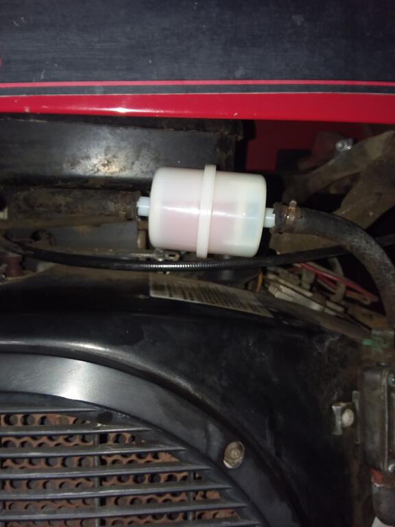

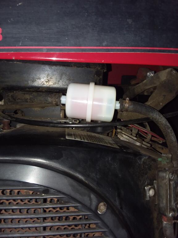

TJ5208 1,841 #66 Posted February 7, 2022 (edited) Here's the fuel filter. picture before was because the filter was empty I hadn't ran it yet. Edited February 7, 2022 by TJ Salyers 1 Share this post Link to post Share on other sites

Snoopy11 5,731 #69 Posted February 7, 2022 45 minutes ago, TJ Salyers said: Here's the fuel filter. picture before was because the filter was empty I hadn't ran it yet. Well, that fuel line is pretty crusty there buddy... you might have gotten some in the carb... @Jeff-C175 and Red are correct. The fuel filter I was using before has a check valve. I went out and checked (somehow I still have it). It wasn't the size or the filtering medium... it was the internals that were keeping it from flowing. I put it on... the first way... it didn't run... then I switched directions... and my machine ran great. It was the internal valving. I always thought it was the size, filtering medium, restriction... etc... but I was wrong. It does take a LONG time after putting it in correctly to get fuel... over 45 seconds of cranking... but it does work. Don 2 1 Share this post Link to post Share on other sites
