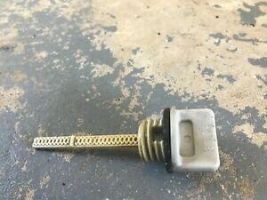

RED-Z06 2,718 #9 Posted February 6, 2022 Here is my M12S with about 25hrs on a rebuild, it blows alot of air out..but once the stick is lowred it actually creates a vacuum and sucks the stick down. Opened up it will blow oul vapor all over the place 3 1 Share this post Link to post Share on other sites

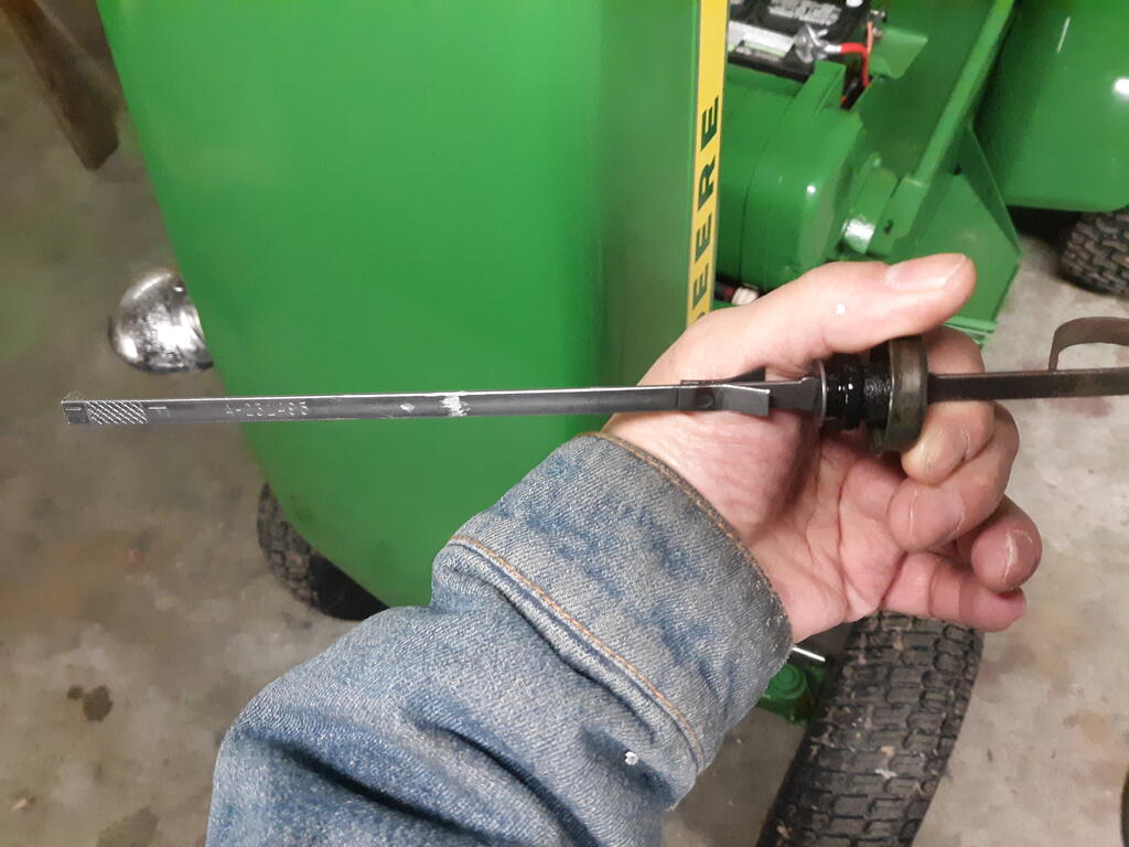

RetroMower 350 #19 Posted February 10, 2022 (edited) On 2/6/2022 at 10:57 AM, RED-Z06 said: Here is my M12S with about 25hrs on a rebuild, it blows alot of air out..but once the stick is lowred it actually creates a vacuum and sucks the stick down. Opened up it will blow oul vapor all over the place After a couple brutal days at work I finally got to fully investigate my issue and reinstall the breather. Turns out RED-Z06 was dead on with his advice. If I hold the dipstick down or angle it just so it stays in place. When removed and I put my hand over the dipstick tube I can feel a slight pulsing but once the seal is broken it chuffs pretty good. My dipstick is either not original to this motor or the rubber grommet is so dry and shrunken it barely seals anymore. I never encountered this issue on my horses primarily because they are all threaded plugs. If anyone has a k181 plug/dipstick for sale I'd be grateful. Edited February 10, 2022 by RetroMower 1 Share this post Link to post Share on other sites
RED-Z06 2,718 #20 Posted February 10, 2022 1 hour ago, RetroMower said: After a couple brutal days at work I finally got to fully investigate my issue and reinstall the breather. Turns out RED-Z06 was dead on with his advice. If I hold the dipstick down or angle it just so it stays in place. When removed and I put my hand over the dipstick tube I can feel a slight pulsing but once the seal is broken it chuffs pretty good. My dipstick is either not original to this motor or the rubber grommet is so dry and shrunken it barely seals anymore. I never encountered this issue on my horses primarily because they are all threaded plugs. If anyone has a k181 plug/dipstick for sale I'd be grateful. What's your dipstick look like? Share this post Link to post Share on other sites
Jeff-C175 7,207 #21 Posted February 10, 2022 1 hour ago, RED-Z06 said: What's your dipstick look like? Gettin' a little personal there, ain'tcha ? 1 Share this post Link to post Share on other sites
RED-Z06 2,718 #22 Posted February 10, 2022 (edited) 4 minutes ago, Jeff-C175 said: Gettin' a little personal there, ain'tcha ? Isnt that what happens at night up in Pa at the show? Everone pulls out their dipsticks to compare? Edited February 10, 2022 by RED-Z06 1 Share this post Link to post Share on other sites
Jeff-C175 7,207 #23 Posted February 10, 2022 (edited) 3 minutes ago, RED-Z06 said: up in Pa Dunno! What happens in PA stays in PA! That one you posted looks like a ladies watch band! Edited February 10, 2022 by Jeff-C175 Share this post Link to post Share on other sites
RetroMower 350 #24 Posted February 10, 2022 You what to see my what?! lol As I said I dont think this is original to this motor. You can see the end is mushroomed from tapping the oil pan. Share this post Link to post Share on other sites
RED-Z06 2,718 #25 Posted February 11, 2022 A231495S is a K181S part number.. Share this post Link to post Share on other sites
