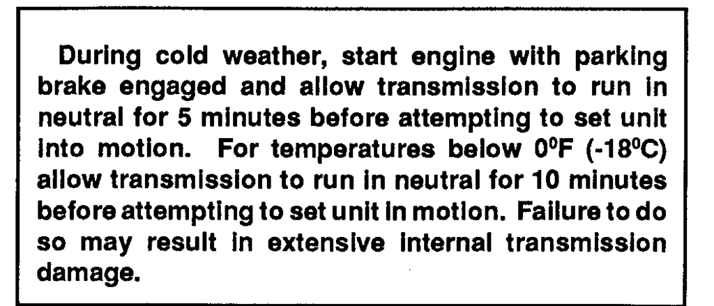

lynnmor 8,644 #6 Posted February 6, 2022 From the owners manual. 3 Share this post Link to post Share on other sites
briankd 833 #7 Posted February 6, 2022 8 hours ago, lynnmor said: From the owners manual. i have heard of that . i am a newbie to theses hydro's always had gear tractors 8 hours ago, Horse Newbie said: However, I do need to do the old “tree test” to see how strong the pump and transmission is… i need to do this to see what i have . i have no history on this tractor and don't know if it slips or not i know i drove it around yard before i parked it a year ago. will change oil and filter first if anything i know this thing doesn't push well . this only thing about this eaton i don't like 1 Share this post Link to post Share on other sites

lynnmor 8,644 #12 Posted February 6, 2022 Just now, Horse Newbie said: I have heard of people removing on of the bolts on top of transmission to vent… I just took my time and waited… It's in the manual. I don't do it because dirt may drop in, no matter how much you clean. I too, just take my time and do other things while it burps. 3 Share this post Link to post Share on other sites
