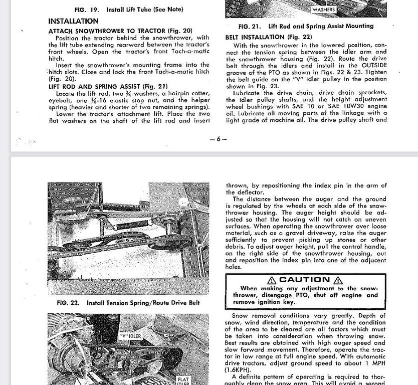

pfrederi 21,046 #8 Posted February 3, 2022 1 hour ago, Pullstart said: When it stops, do you see the belt stop too? Also, are you sure it’s in the larger diameter of the two PTO grooves? Manual shows belt in the outer/smaller pulley of the PTO 1 1 Share this post Link to post Share on other sites
